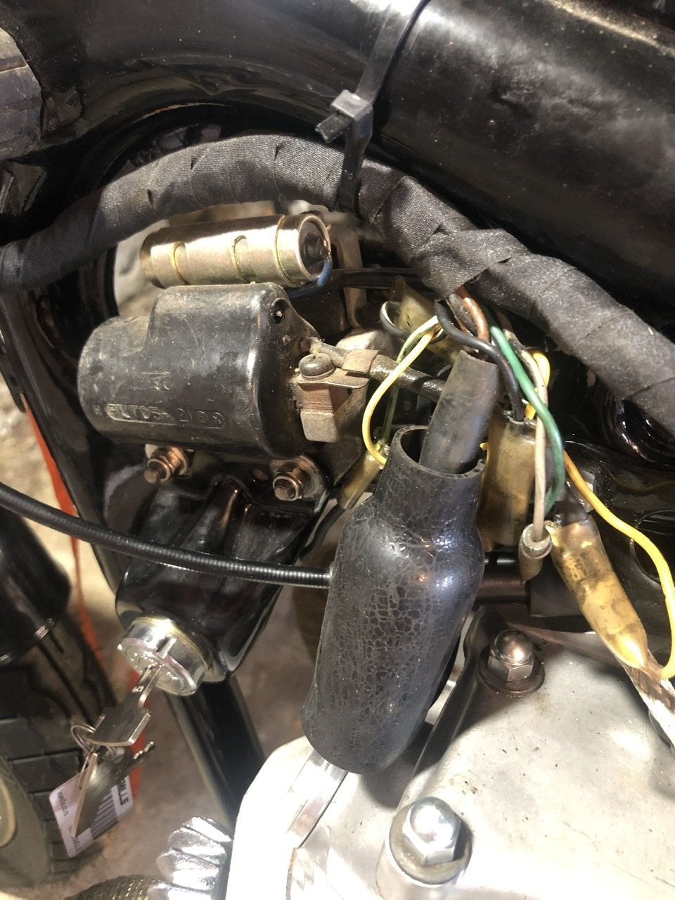

Abarth Posted May 18, 2020 Author Posted May 18, 2020 Continuing on with most things being fkd on this bike it was having spark issues. Setting the points was an issue where the old points plate was so bent and threads stripped that after a 5 min ride it was all out of tune again. Also the HT leads from the coil was broken in multiple places and these factory coils have the lead built into them. Ordered a brand new aftermarket coil set and a complete genuine points plate. While I did that I swapped out the air fuel mixture adjustment screw to a cone type as I was having trouble adjusting it to get it lean enough to not blacken the plugs Progress pics 6 Quote
Abarth Posted May 19, 2020 Author Posted May 19, 2020 Installed and set the points gaps. Gave it a quick tune with the glass plugs and took it for a ride. So much better now, throttle is crisp and no stuttering under acceleration. I was worried as a lot of people have trouble running CV carbs with trumpets but everything seems fine. Eventually I’d like to get it on the dyno. Came back and pulled the plugs. They lookish, one is running a bit leaner than the other but I think I can tune that out with the air/fuel mix. Had an issue with the Joker Machine tachometer blanking plug as it has no O ring to seal off oil which lead to a massive oil leak. Bunged in a fibre washer which did nothing. I’ll have to buy an o ring kit and try a few. 7 Quote
