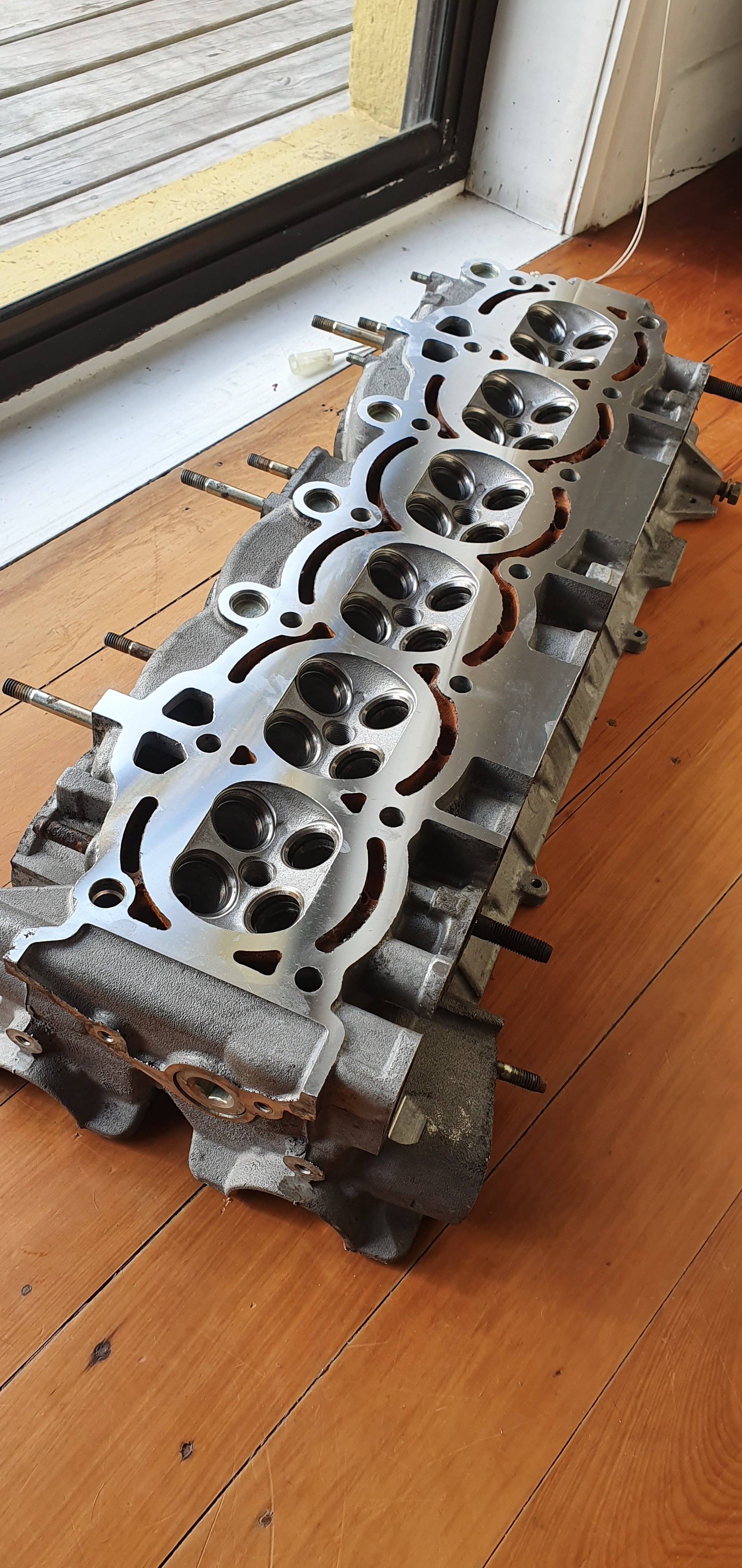

dspec_tt131 1,393 Posted January 20, 2019 Author Report Share Posted January 20, 2019 While up at dads he walked me through giving one of my 1ggeu heads a bit of a tidy up. I pulled the valves out, all twenty f#@king four, then pissed four hours away sitting them on a wire wheel on a bench grinder cleaning all the carbon off. Next I degreased everything and waterblasted the bare head before pulling out old valve seals and replacing with new ($100 Ebay full gasket kit) Reassembled all the valves after lapping them in at some point, torqued the cams down and checked clearance to shims in buckets and all within spec, put my fancy wrinkle painted cam covers on and called it a day (better part of 3 days work) This was a bit of a low budget refurb to get one of these engines in and going for Toyota fest which is sometime around the end of March. Was also good to learn how properly disassemble and label everything to go back in order to the point where I'm fairly confident doing the two others I have in stock which I'll have resurfaced and acid dipped professionally. 2 Quote Link to post Share on other sites

dspec_tt131 1,393 Posted November 23, 2019 Author Report Share Posted November 23, 2019 Head I rebuilt at the beginning of the year went to the engine builders with block and rotating assembly to get fitted turned out to be severely bent and very soft. Should probably have had this checked before spending the better part of three days reconditioning it. Pulled another one from stock that checked out ok so I get to do it all again. Practice makes perfect? After a bit of searching I grabbed some new m6 bolts from car clips nz working out to about 50c for 50 so have started piecing brake lines, air conditioning lines and powersteering lines back together. Also grabbed some new brake line grommets and distributor O-ring via megazip just awaiting brake master cylinder and some other pieces from rock auto to to complete brake system. Hit a bit of a snag with the air conditioning compressor in the way the lines enter it. 1gge (ribbed pulley) has a press in fitting with a bolt holding it down and 1geu (v belt pulley) just has a straight thread on sleeve and I cant un bolt and swap the housing as they're different pcd so hoping I can cut fittings off a set of ga70 lines and have them welded to my gx61 lines? 1 Quote Link to post Share on other sites
