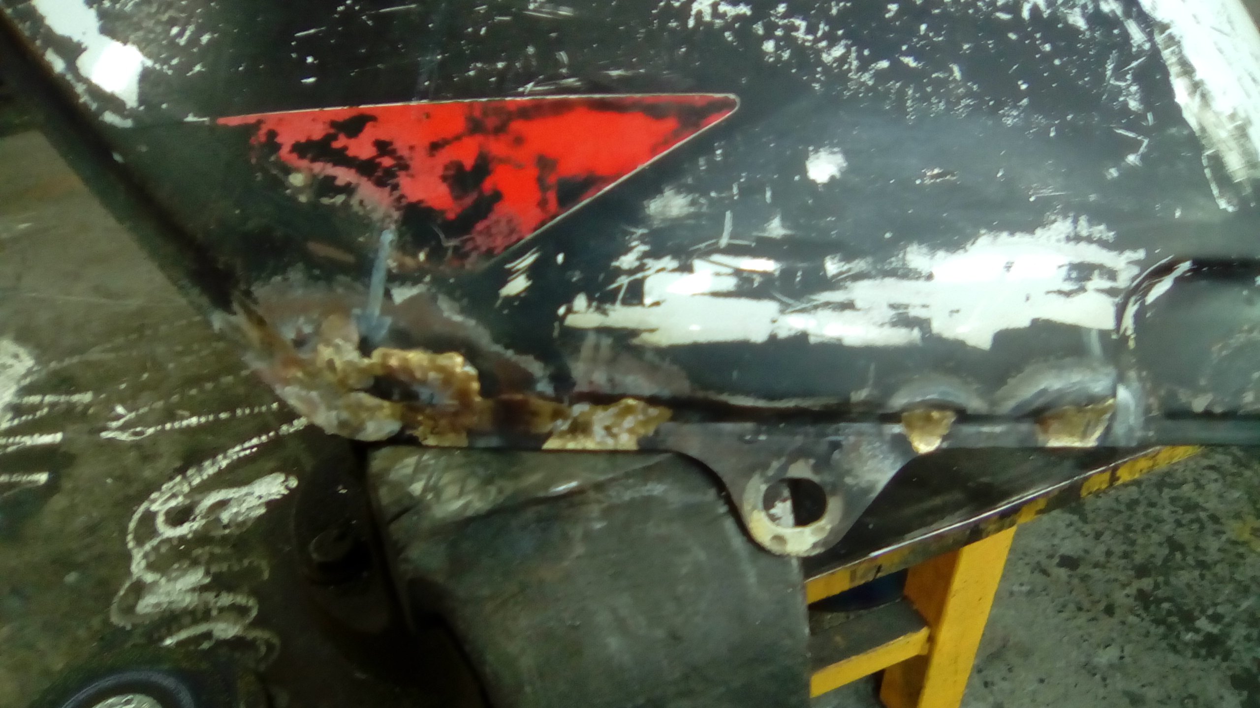

Hello, what's this?
Fuck you with a pineapple. Fuel seeping out a tiny hole. A sensible person would stop here and sort this out.
Posted (edited)
On a small plus side, the fuel I tipped out of the tank looked ok.
And I got the carbs all fitted up with minimal hassle.
Even topped up the coolant and pumped up the front tire while I was at it.
Then I thought, Fuck it the tank's only seeping. Get on there.
Bonus is that it doesn't seem to be seeping anymore, crap clogged up the hole? I'll add it to the list of stuff to do.
