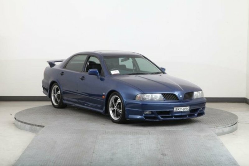

Thousand Dollar Supercar Posted June 14 Posted June 14 You're right about that being the ugly facelift - the 'bird beak' VR-X (TJ Magna?) looked better, whether it had the 'wine rack' front valance... ..or the snow plow / cowcatcher of the Ralliart model. Pity about the Ralliart's garish interior though. I have @fuel's manual-swapped Diamante wagon back again: Camel and fuel put ~10,000km on it over the summer. Camel replaced the starter motor and fuel attended Wagnats in it and had the windows tinted (the photo above was taken pre window tint). Its current niggles are the return of the left front suspension clunk, and some electrical stuff - the passenger side wing mirror now constantly folds itself in for aerodynamics , the radio sometimes acts like its speaker wiring is shorting, and the battery goes flat if I don't drive it at least once a week. I guess it did get flooded a few years back... It needs a WOF now - can it fail on the wing mirror? 2 1 Quote
