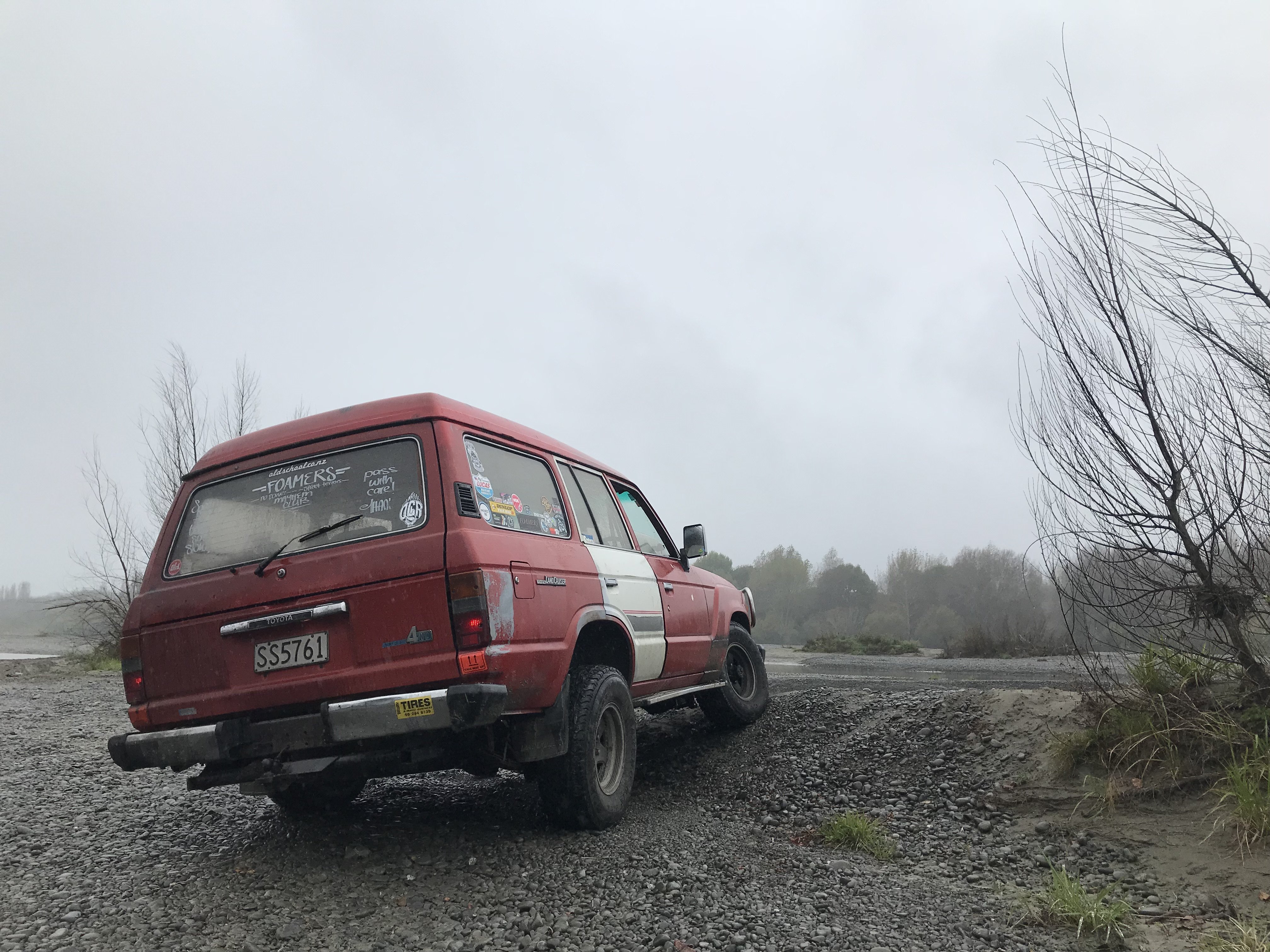

GuyWithAviators Posted November 13, 2018 Author Posted November 13, 2018 A Mazda Demio wrote itself off by crashing into me. Broke my tail light lens and pushed the bumper into the body, no dramas. His insurance paid me out a decent amount of cash for the hassle. Then @Geophy built me a motorcycle rack, and I used it to transport mopeds to Christchurch for a Moped NZ / QCR ride. Had 2 Honda Chaly's inside inside the back and three dudes inside. Found some snow and riverbeds while spending time down there. Handled the 3000km round trip with no issues other than a flat tyre. 3 Quote
