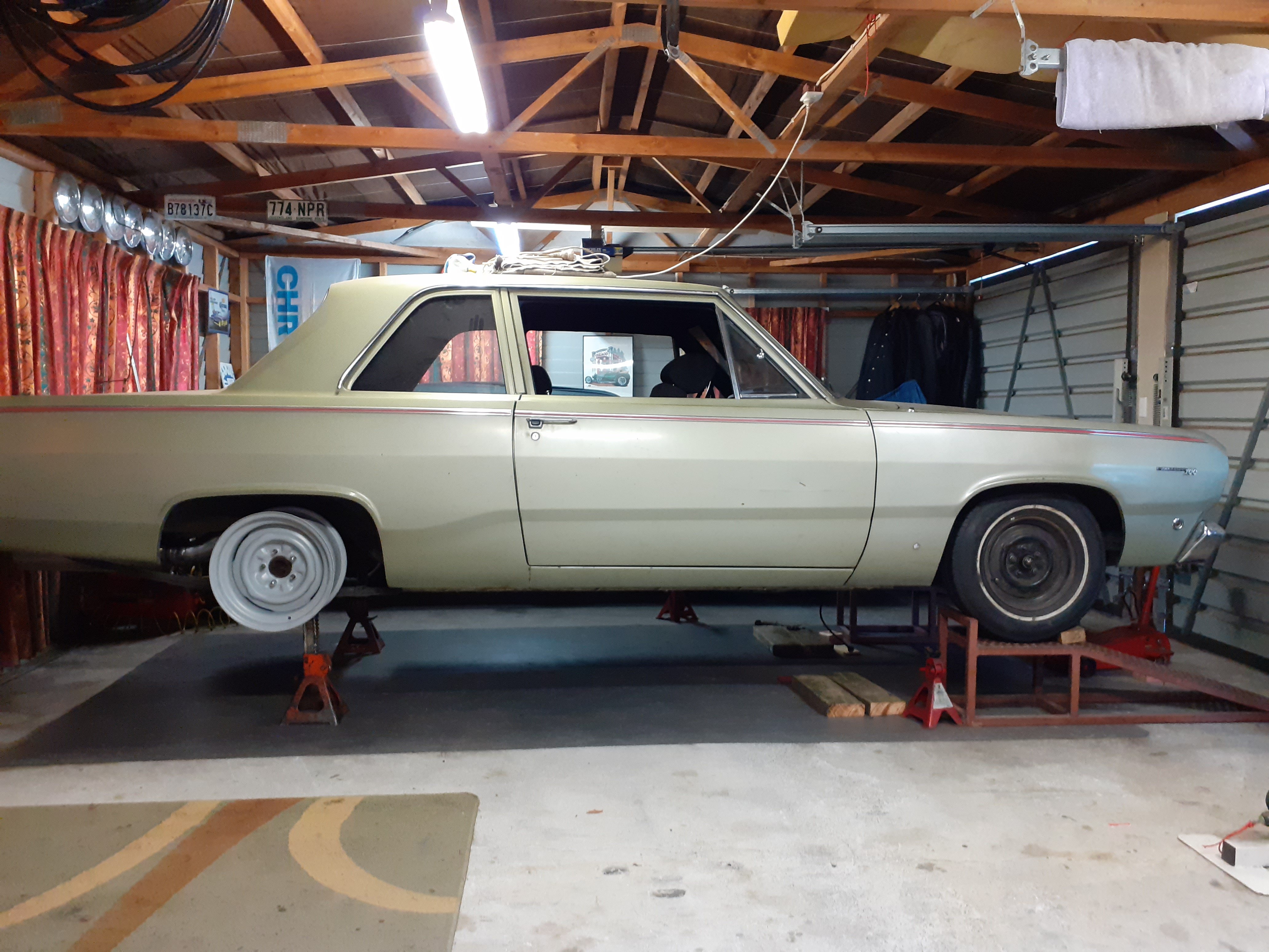

Popular Post cletus Posted April 12, 2020 Author Popular Post Posted April 12, 2020 Test fit of coil overs, all clears everything. Next job will be make some top mounts, and strengthen the shock mount Springs might be a bit soft but that's easy to sort out later if it's a problem, they are just some springs I had in stock off some coilovers 38 1 Quote

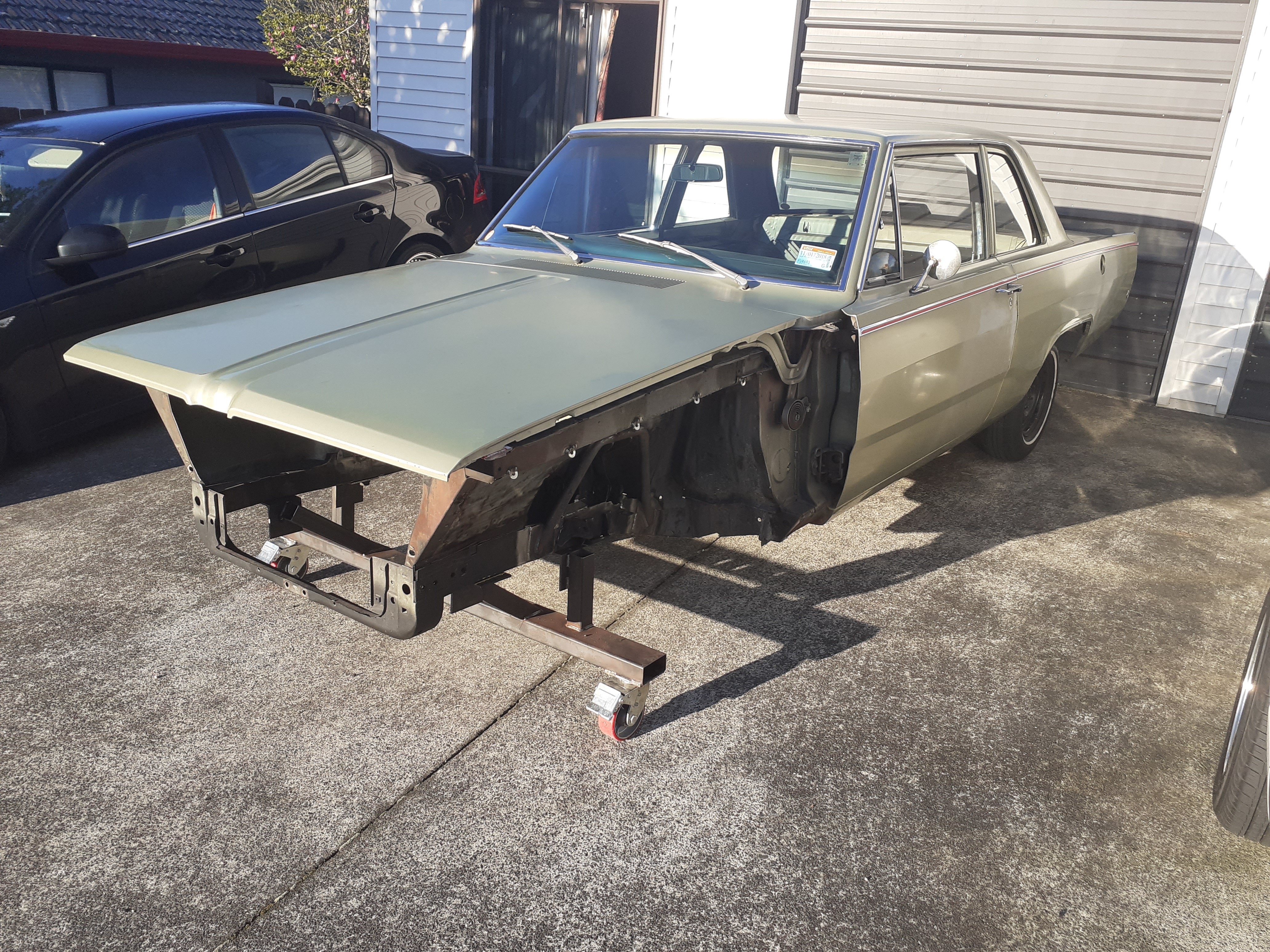

Popular Post cletus Posted August 9, 2020 Author Popular Post Posted August 9, 2020 Removed more things and made a dolly that bolts in to the front subframe mounts 21 Quote
Popular Post cletus Posted September 12, 2020 Author Popular Post Posted September 12, 2020 Matt from tin tricks did some more work for me on the inner guards and firewall so it looks much better . Today it got dropped off at autoblast for underneath and the engine bay to get blasted, primed and underneath painted with 2k epoxy 24 Quote
