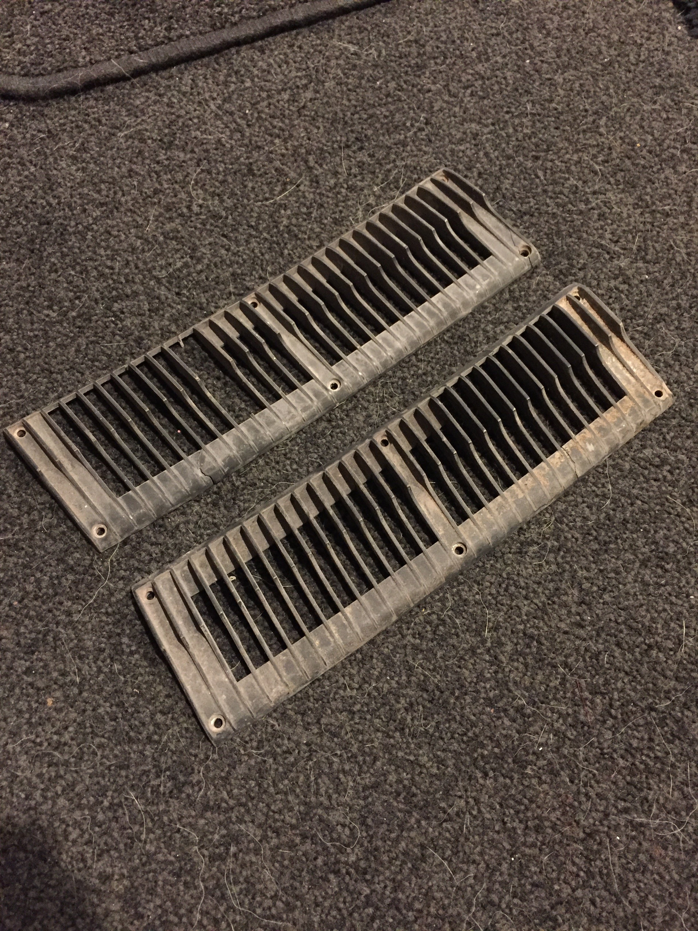

Mr.Mk1 Posted May 21, 2020 Author Posted May 21, 2020 I scored a set of Deluxe cowl vents too. I think I like the Coupe vents already on car better, but it’s nice to have an original option. They are broken in 4 and missing a fin but they are always haggard if they ever do pop up. Much easier to repair than the couple of coupe ones I’ve fixed previously. 2 Quote
