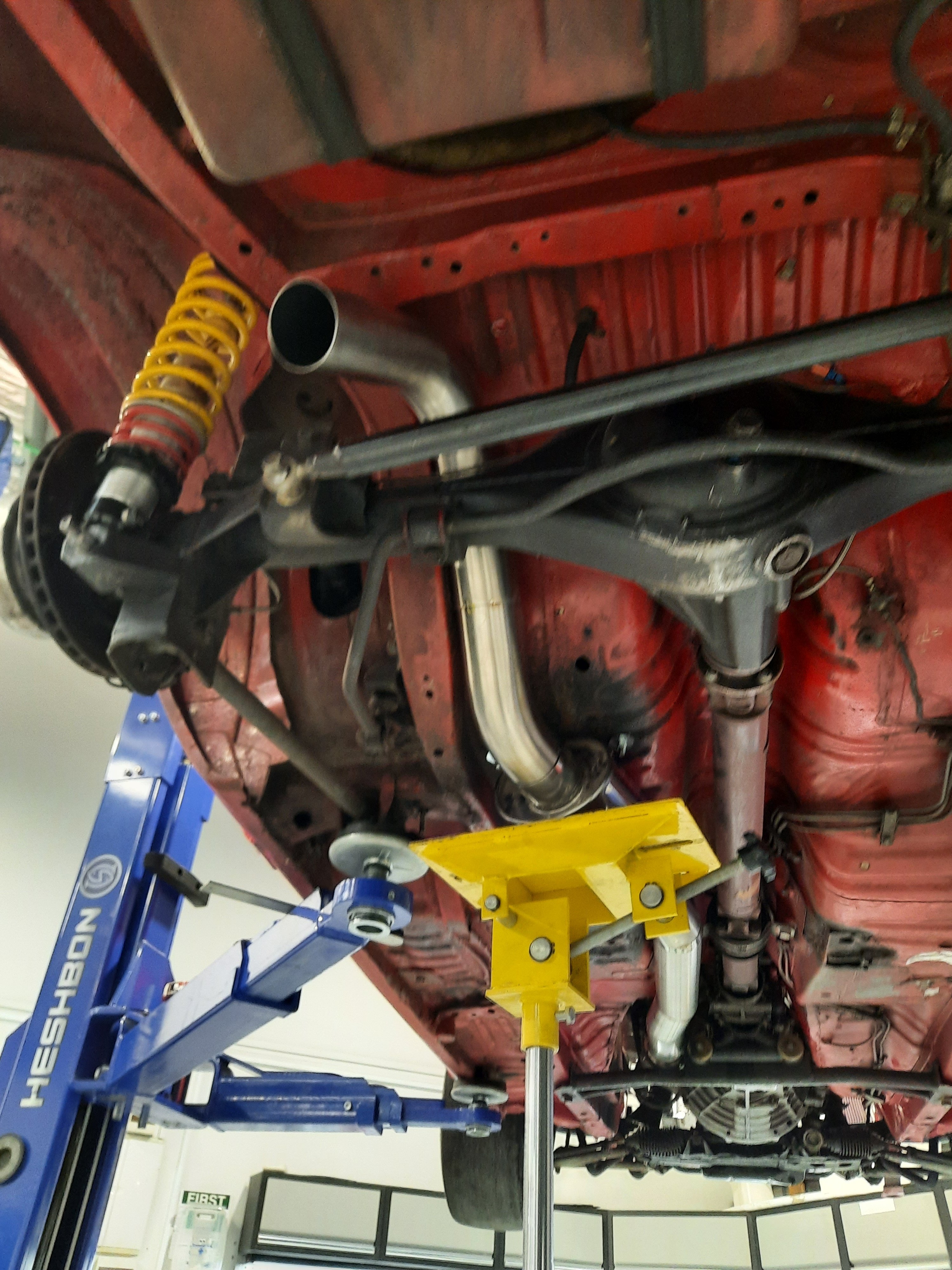

Popular Post Truenotch Posted April 2, 2024 Author Popular Post Posted April 2, 2024 About 2 weeks after I brought the car to Queenstown, I broke my shoulder riding the XR250... So for the last 8 weeks I've been staring at this in my garage without being able to touch it. The sling came off last week. I'm still a one armed bandit for anything heavier than washing dishes, but I still wanted to feel like I was making progress. A couple of mates helped me get the car to work over Easter weekend so I could wash it and start on a few small jobs. Much better. One job I really want to do is update the exhaust. The old side pipe has cracked and it had a bad habit of hitting the ground over ripple strips etc. This time I'd like to go full stainless and exit out the back of the car, with two mufflers. Going under the diff will be tricky because of my droop travel and lowered panhard rod mount, so I'm thinking of heading over the diff instead. It looks like it'll work - this is with the LR shock at close to full compression: Rear muffler location will look something like this: I'll run the smaller reso/muffler just before the diff and might run a V band up the front because the old flanges I've been using are pretty tired now! Taking the exhaust out the back makes me feel old. My ear drums will love me for it though 29 1 Quote

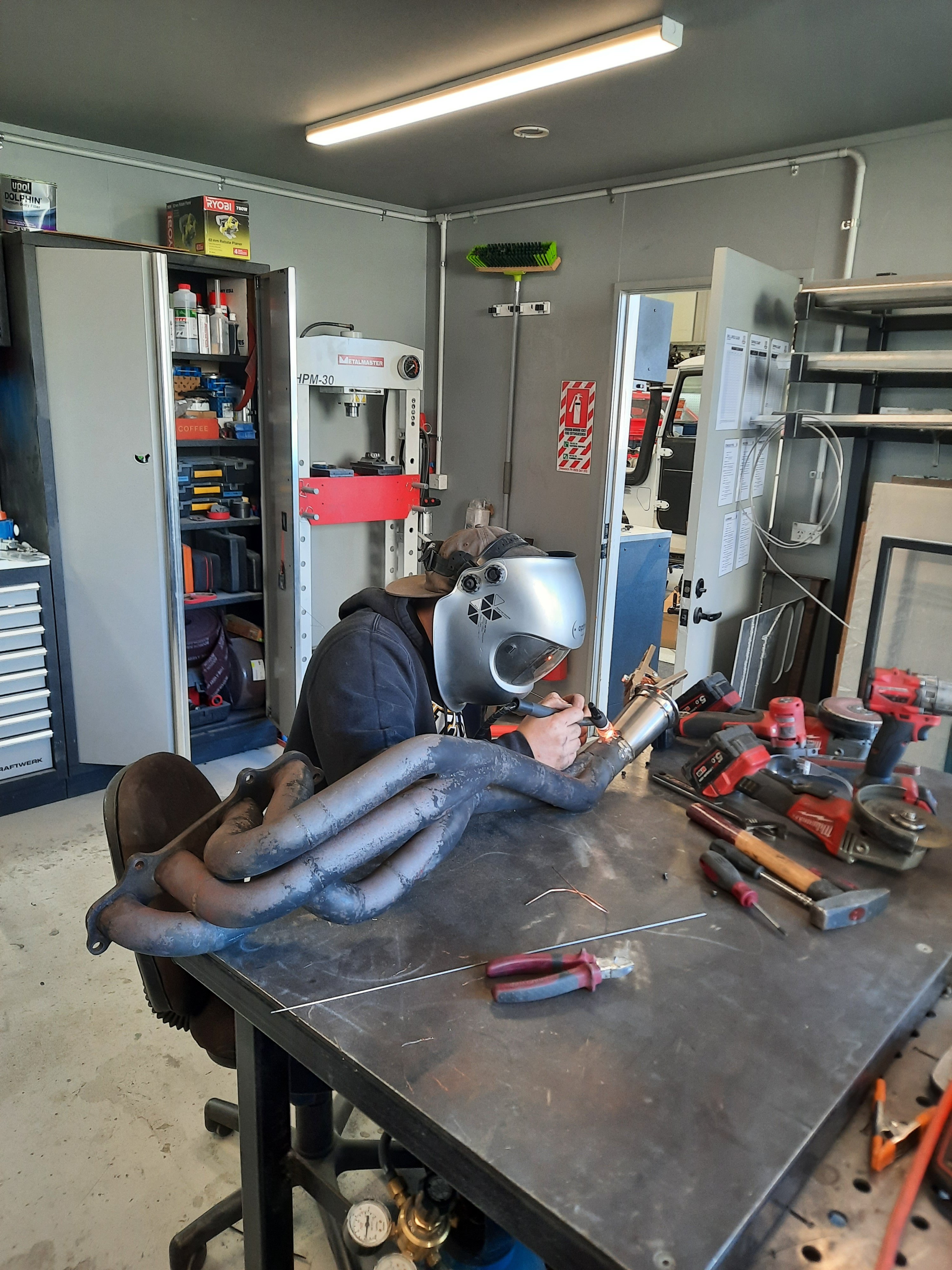

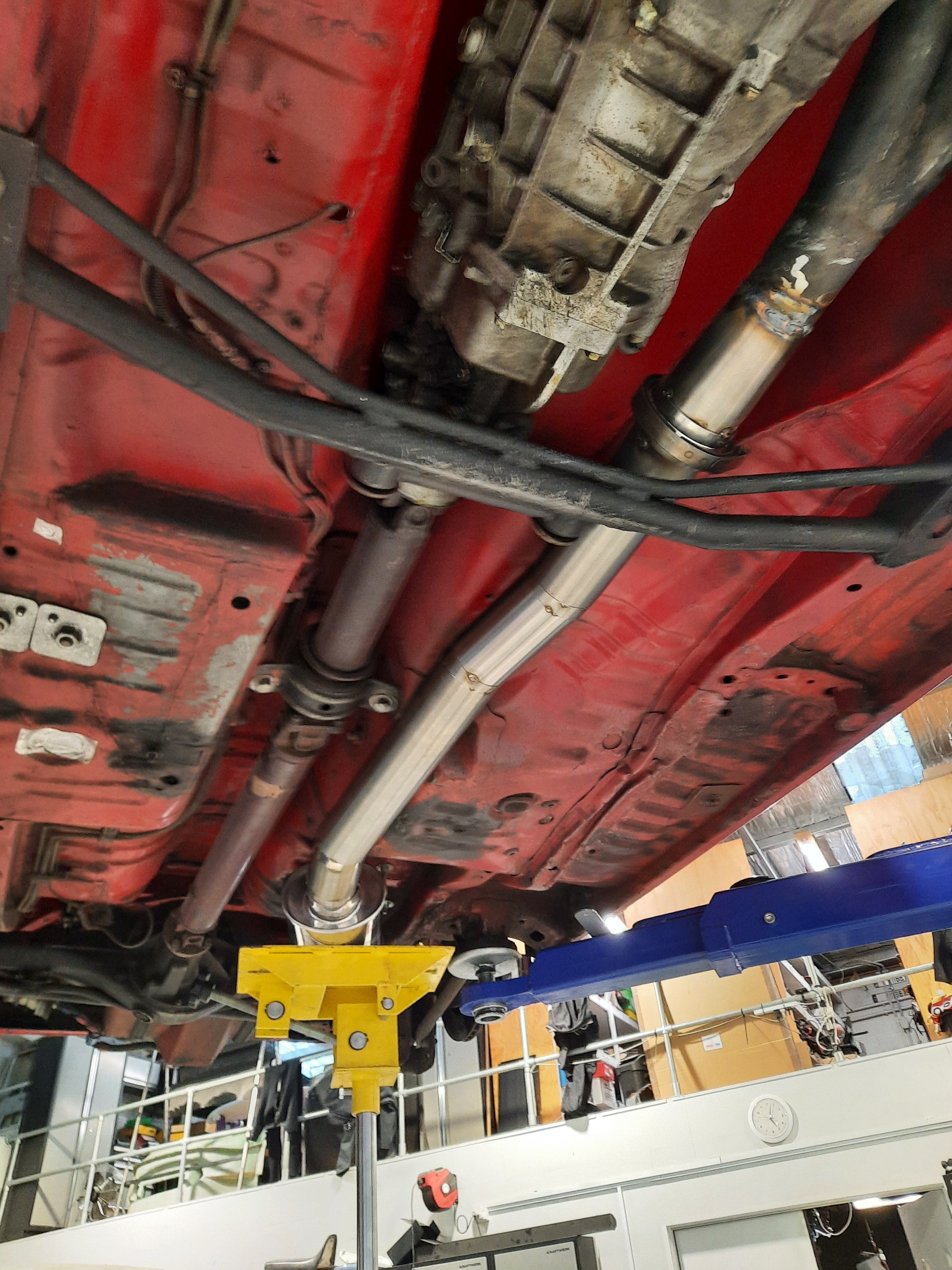

Popular Post Truenotch Posted August 3, 2024 Author Popular Post Posted August 3, 2024 Got the car onto the hoist today and made a start on the exhaust. Brandon was an absolute legend and spent the day fitting pipes and tacking things together. It's coming along well! Welded a new 2.5-3" transition onto the headers with a V band first: Then a few hours later we had this: We used pre made pie cuts for some it and a couple of mandrel bends. It's so nice only having to make straight cuts with the bandsaw! Feels like cheating. Had to throw one of my TEs under Brandon's starlet to see how it looked... Not bad! Hopefully we'll have it close to finished tomorrow. 31 Quote

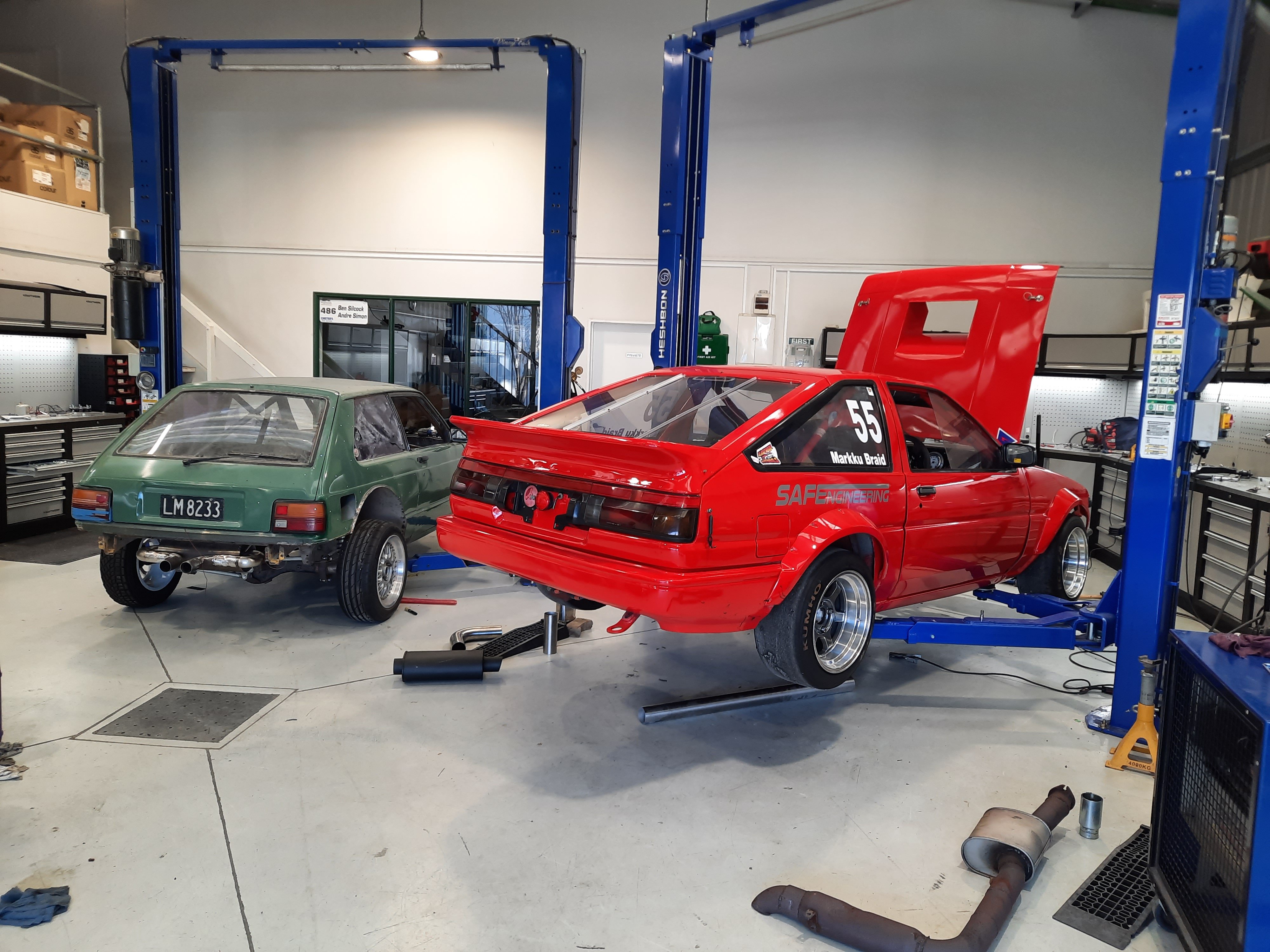

Popular Post Truenotch Posted August 10, 2024 Author Popular Post Posted August 10, 2024 The exhaust is all done. I'm absolutely stoked with the how it fits. Sounds good so far and it should be even better on the racetrack Another quick family photo whole these 3 are together in the workshop: 21 Quote
