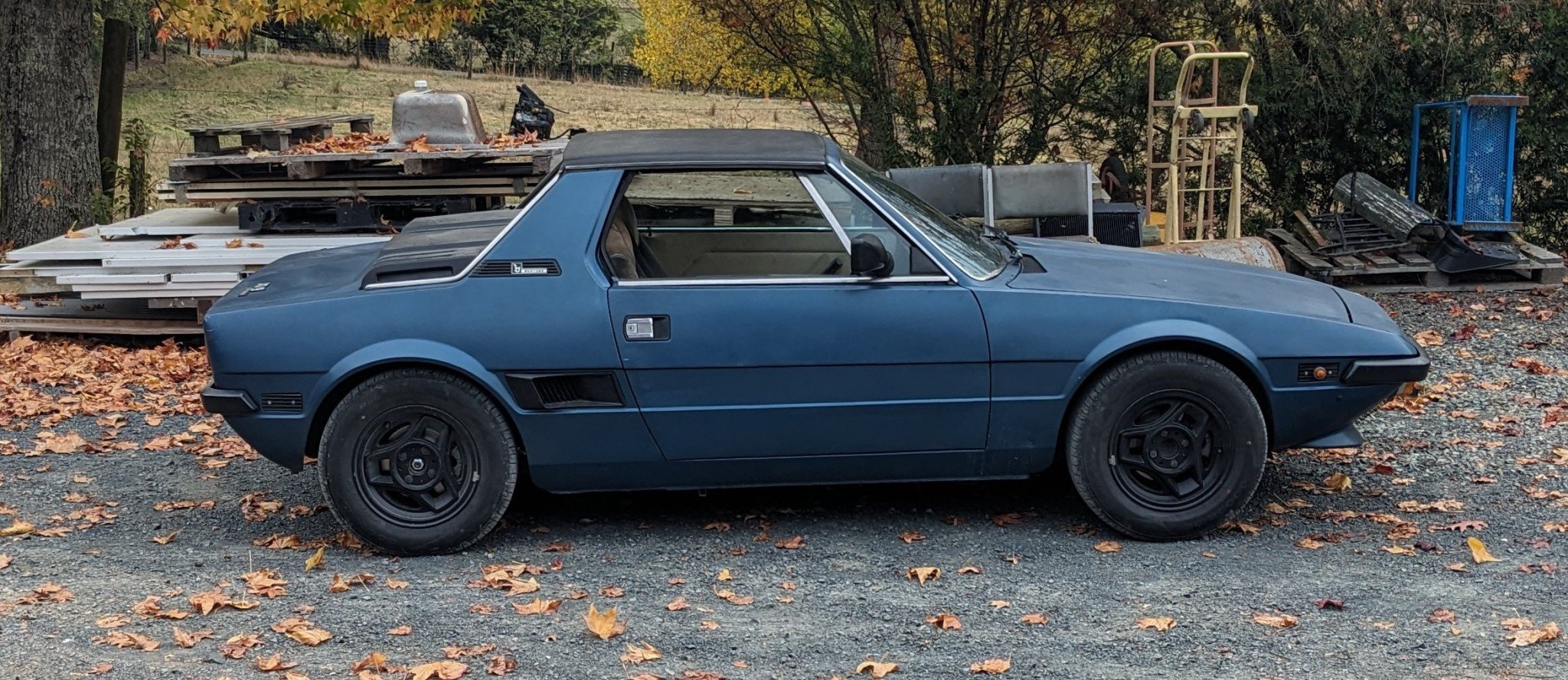

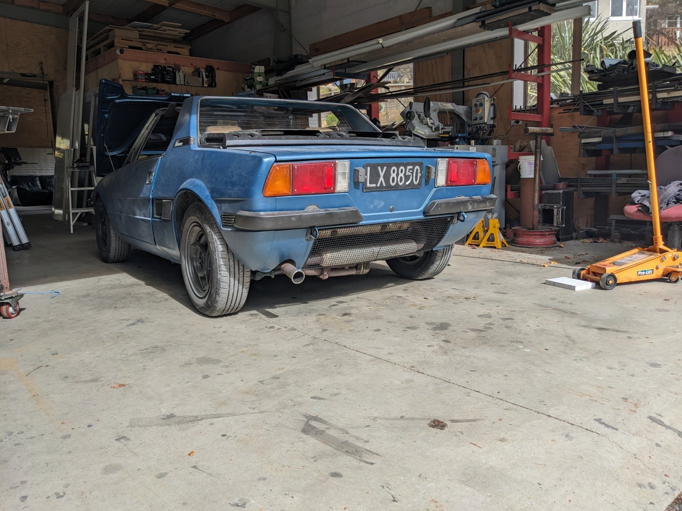

Popular Post ThePog Posted March 1 Author Popular Post Share Posted March 1 Well its a month later and I am getting back on form, hence this effort today; Plenty of room to finish off the wiring now. There was a minor mishap during engagements, now I need to figure out which Fiat Uno that distributor is off. I'll give the donk a clean up, new oils and filter, new plugs etc. Might drop the sump to see the state of play. For some reason it has way more oil than it actually needs, not sure why. 23 Quote Link to comment Share on other sites More sharing options...
Popular Post ThePog Posted March 3 Author Popular Post Share Posted March 3 Did a chunk of the back end wiring today, not much to see as I have tried to keep things tidy so it pretty much blends in. I tried to fit a new power plant, amazing that for the size this unit only makes one pogpower. 23 6 Quote Link to comment Share on other sites More sharing options...

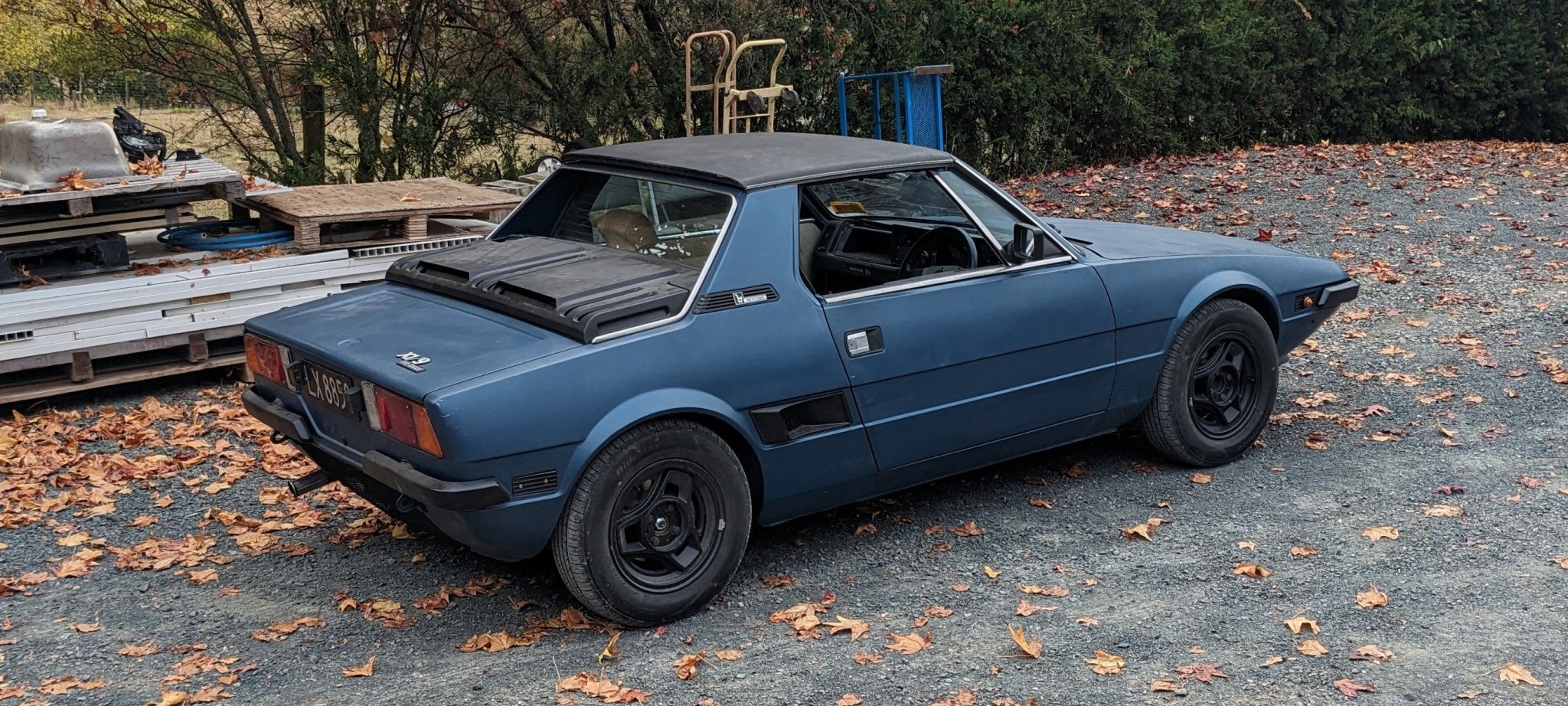

Popular Post ThePog Posted March 8 Author Popular Post Share Posted March 8 Clutch cover is away getting stiffer springs put in. I have ordered many specific X1/9 bits from a UK company that pretty much only do X's and Lancia Montecarlo's. So many little things that I was going to have to fudge and now won't have to, so thats nice. In the last couple of days I slapped the last of the paint on so it is (mostly) one colour, and this evening has been all about bolting shit back on. Quite a few little trim bits seem to be missing but nothing to prevent function or legality so far. Nice from far, far from nice. 22 Quote Link to comment Share on other sites More sharing options...

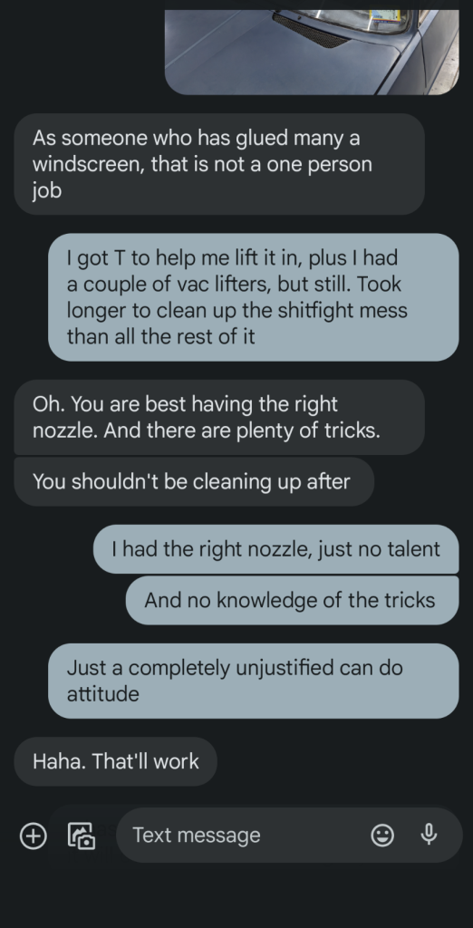

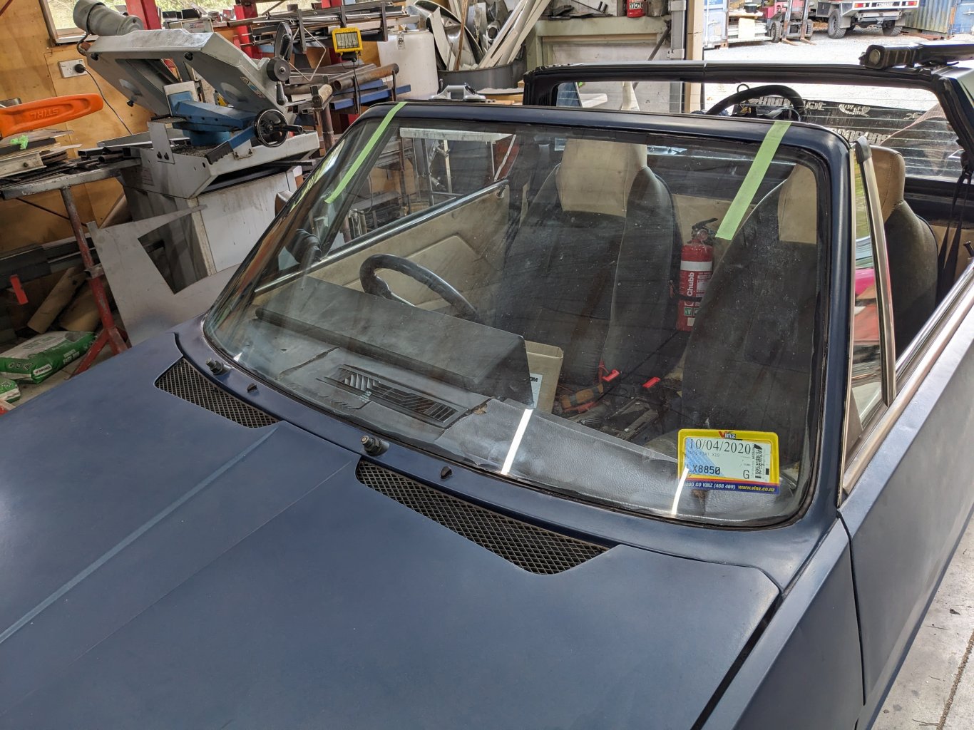

Popular Post ThePog Posted March 22 Author Popular Post Share Posted March 22 Just glued the windscreen in cos I am too cheap to pay someone to do it. I should have done so. The experience is best described by this convo with @HumberSS 2 18 Quote Link to comment Share on other sites More sharing options...

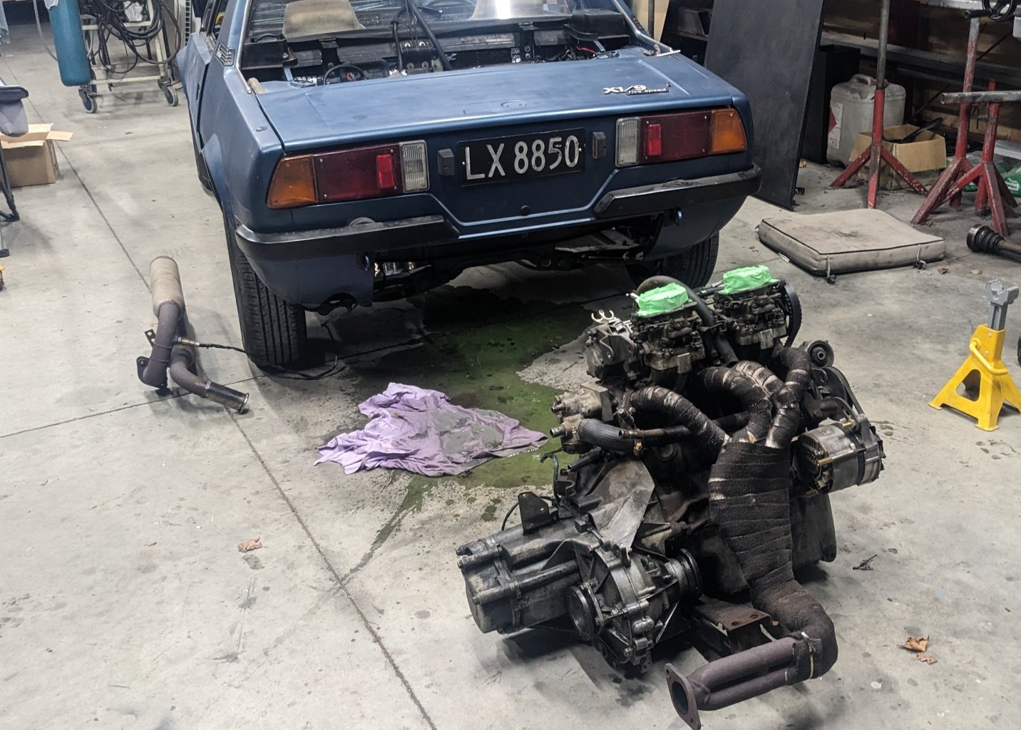

Popular Post ThePog Posted March 23 Author Popular Post Share Posted March 23 Bright and early this morning, firstly time to pour some liquid money into the box once the engine is kindof level. 3.2 liters of Redline MTL which all the cool kids say is the only shit to use in an X1/9 box. At $200 for 4x bottles it fucking better be. Then on to the main event; Then after half an hour of wiggling and jiggling, angling and dangling etc Then the rest of the day bolting shit back on; Just the driveshafts and some oil and it might be time for a skid. But thats tomorrow's effort. 23 1 Quote Link to comment Share on other sites More sharing options...
Popular Post ThePog Posted March 23 Author Popular Post Share Posted March 23 Driveshafts in Oil in Coolant in Popping and banging when I try to start it Realising the plug leads are 180deg out Boom Then realising the fuel pump is leaking like a sieve and it is a $14 AliX special so not unexpected. Then finding the original Facet pump and checking it works, it does Then realising you have no fittings to make it work so no driving 18 Quote Link to comment Share on other sites More sharing options...

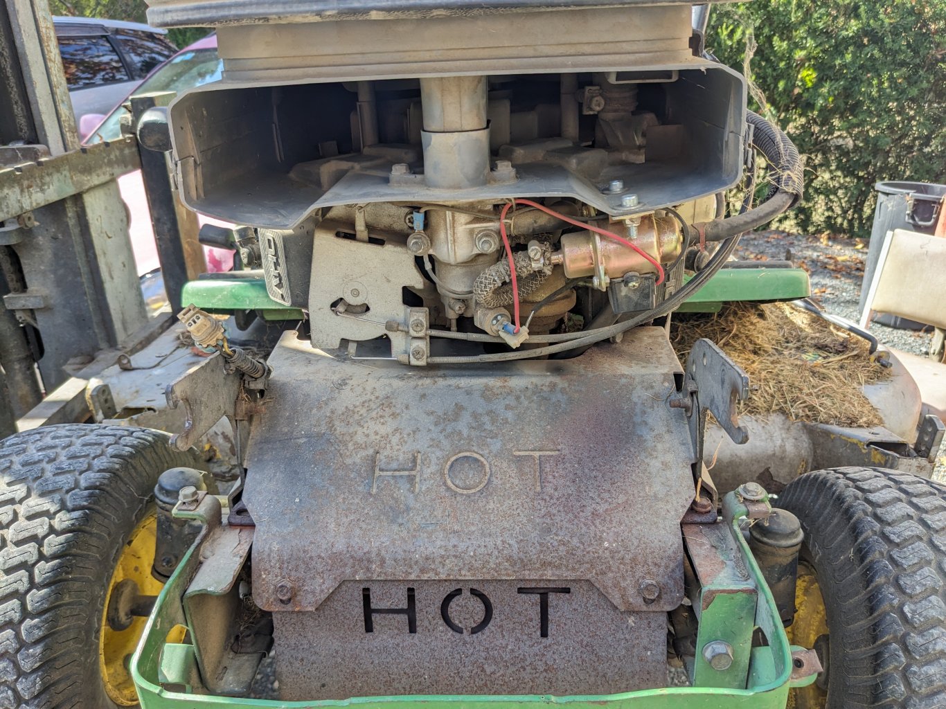

Popular Post ThePog Posted March 24 Author Popular Post Share Posted March 24 Then I remembered the shitty fuel pump that I hacked into my ride-on a couple of years ago cos it was way too much money to buy OEM; Then naturally this; Dunno what the crackly business is, nevertheless it sounds glorious. 24 5 1 Quote Link to comment Share on other sites More sharing options...

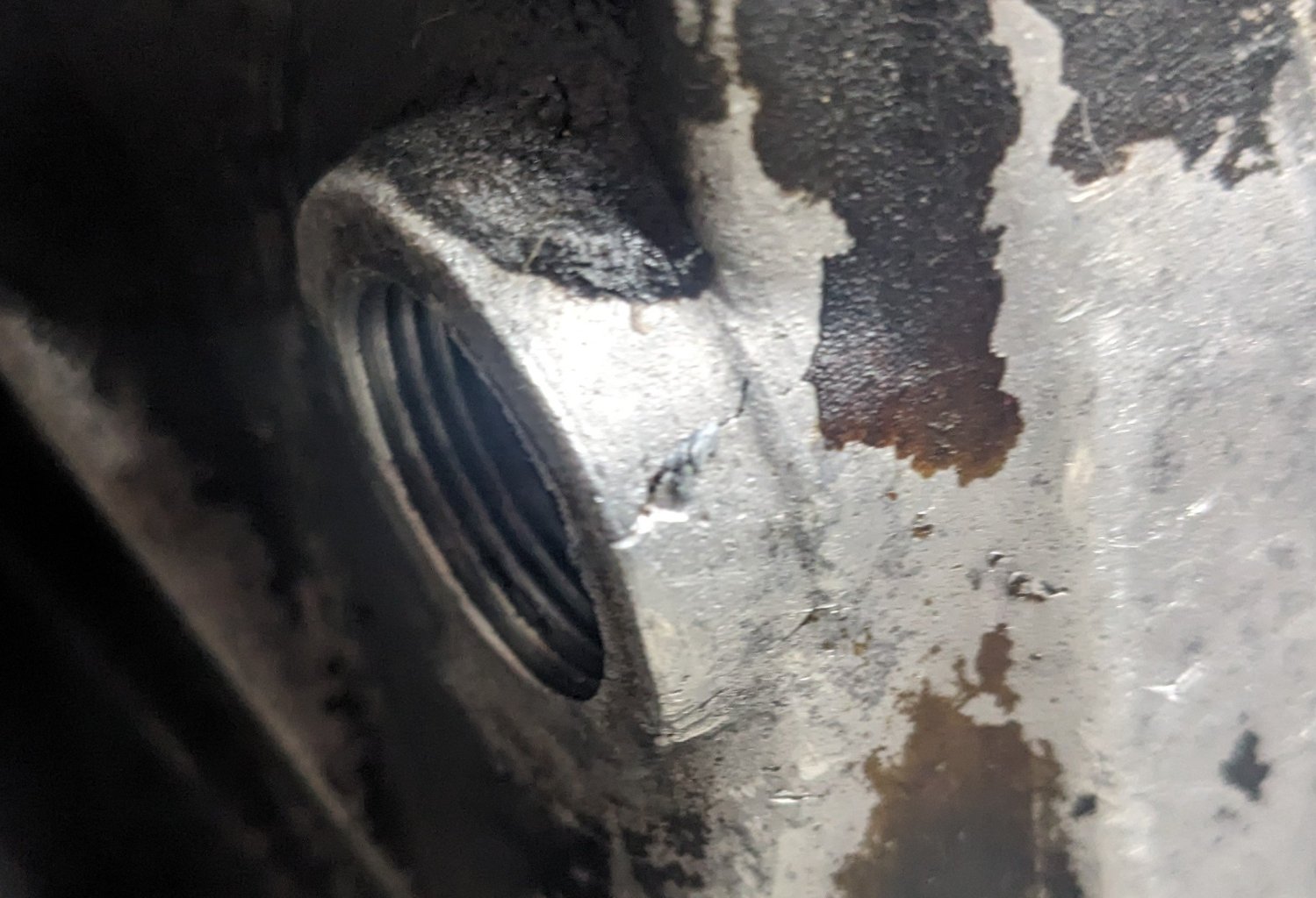

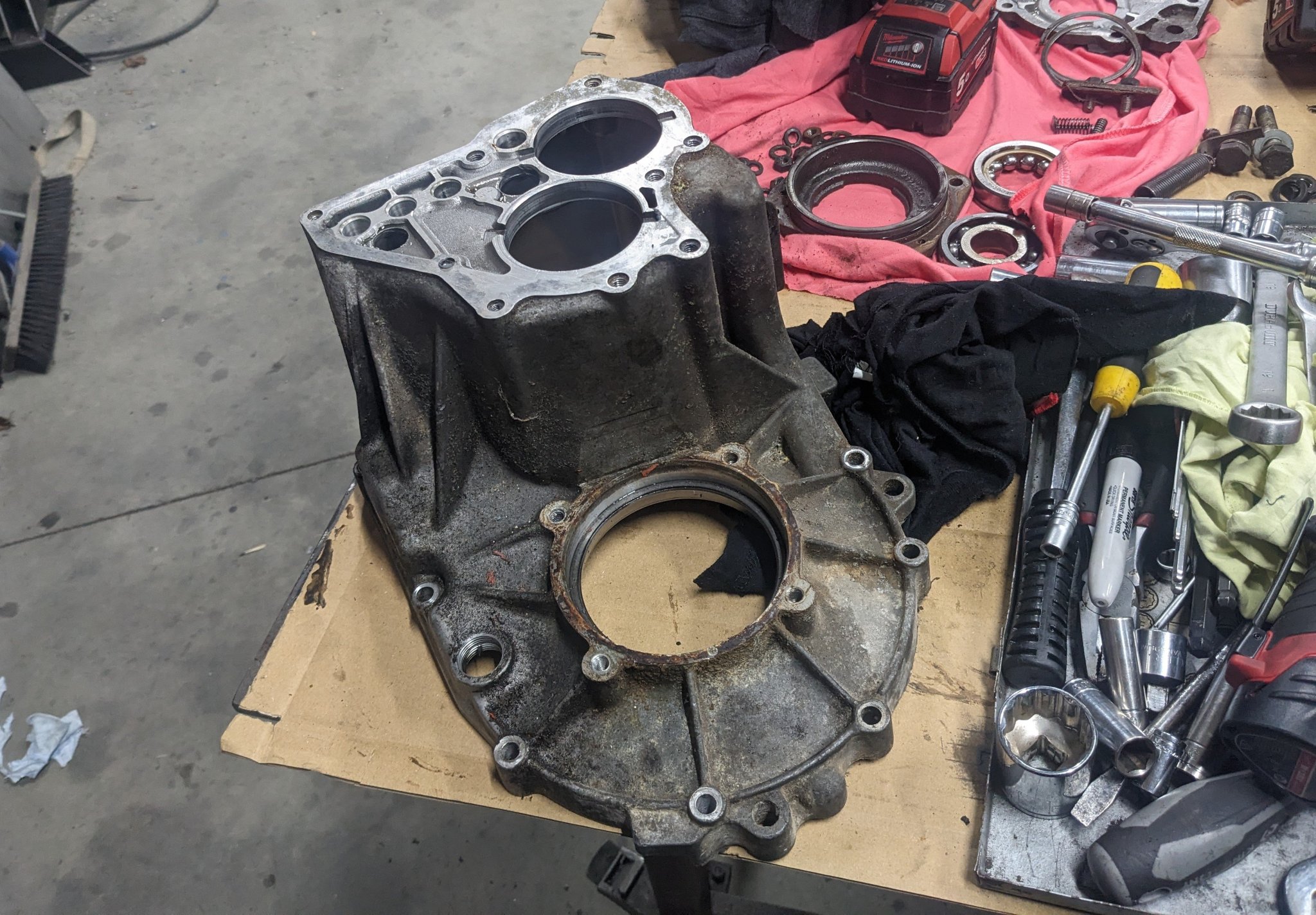

Popular Post ThePog Posted April 19 Author Popular Post Share Posted April 19 The bits I need for that Wof have arrived, the wheel bearing might be a mission, but we will see. In the meantime I have been hoovering/relearning what I need to know about DCNF carbs and have had some useful and enlightening conversations, some of which can be found in my DCNF thread.. I also decided to replace the expensive oil in the tranny with fresh expensive oil. Mostly cos I drained it all out to put a bit of sealant on the drain plug as it was dripping a tad. When it came out it was kindof murky which I guess is the new oil washing out and interacting with the old. So I did that and it resulted in a pretty significant drip from the drain plug regardless of my sealing efforts. I did a wee bit of investigation, which has had this slightly annoying result; I have a spare box which I stripped enough to get that housing off, pretty much for practice but to see if I could just use that. But unfortunately they are different. This might mean enlisting @yoeddynz in some dirty welding duties if I cant find someone slightly closer. If it welds ok I will tap it out with a parallel thread rather than taper and machine a flat face so it can use a washer for sealing. 15 Quote Link to comment Share on other sites More sharing options...

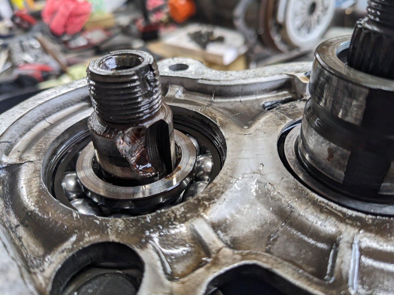

ThePog Posted April 19 Author Share Posted April 19 And more bad news Might be time to find another box 13 Quote Link to comment Share on other sites More sharing options...
