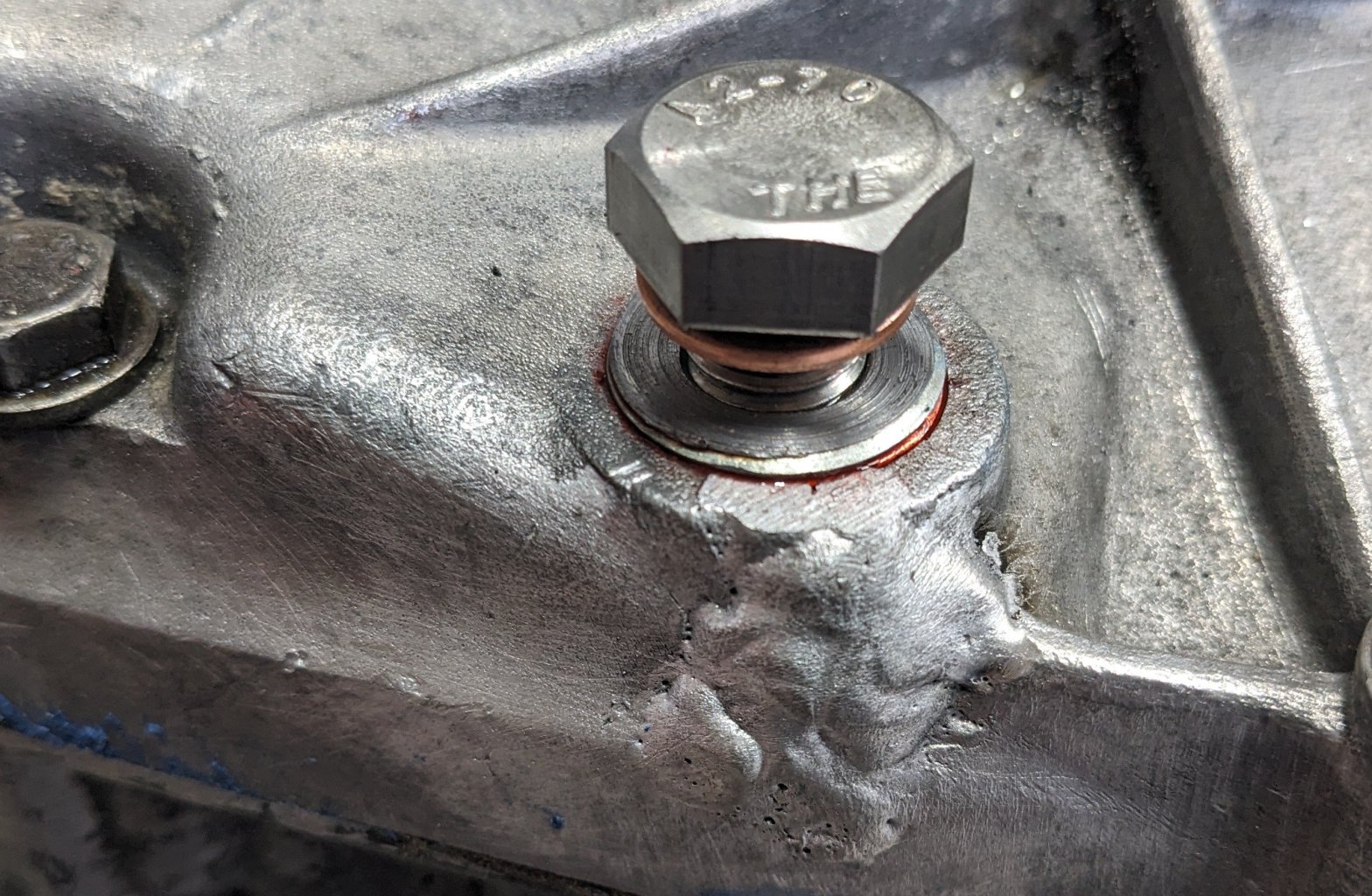

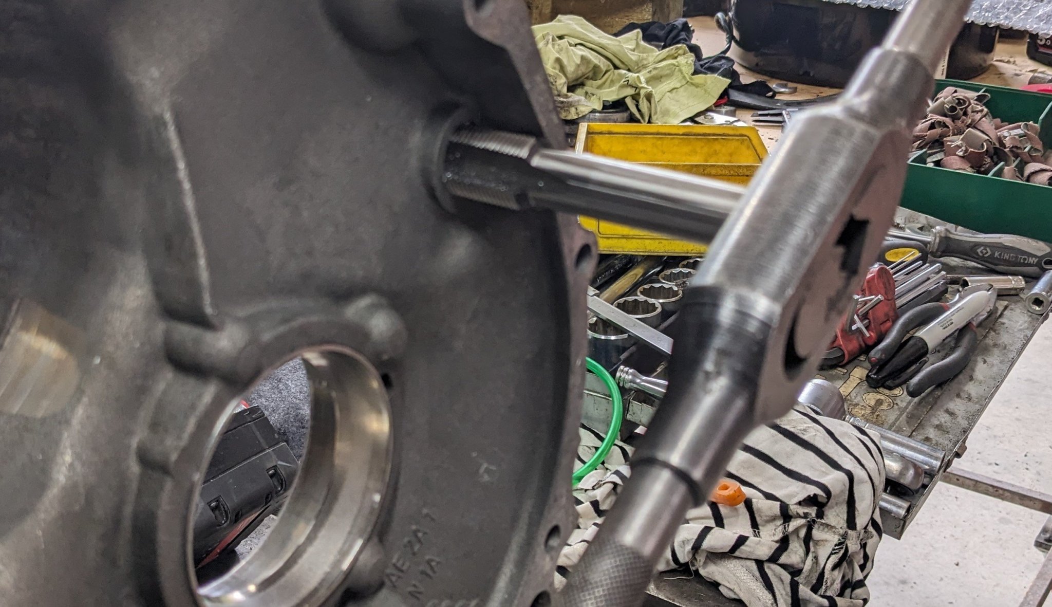

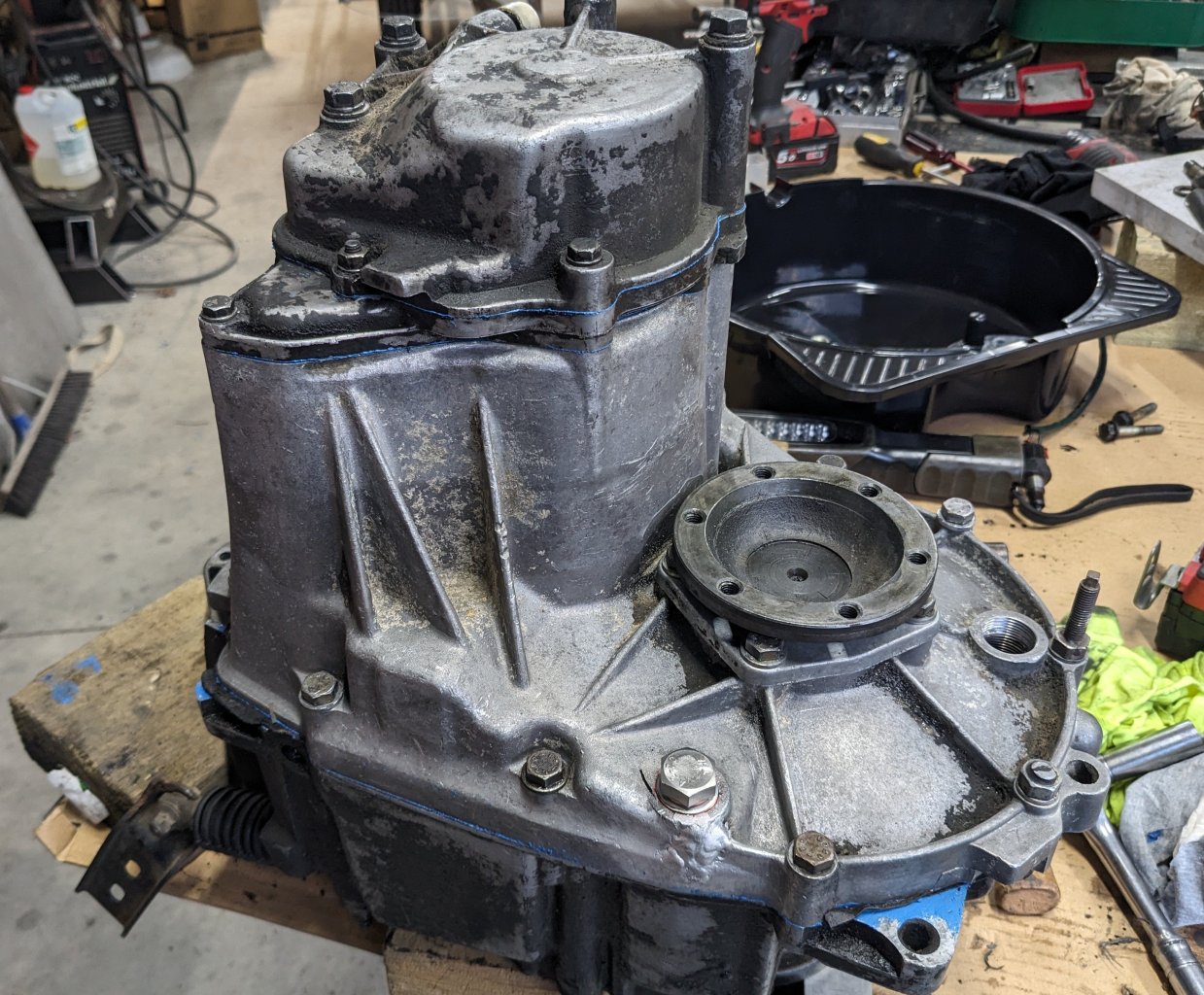

Popular Post ThePog Posted April 20 Author Popular Post Share Posted April 20 I did a thing. First I went to visit @yoeddynz who kindly welded the crack up. I also got a preview of exciting Imp developments.... When I got home I had a look to see what that plug thread was. Interestingly it appeared to be an M22x1.5 parallel thread, which meant a tapered plug made very little sense. And it just so happened that I had an M22x1.5 tap and some threaded rod. So I messed around for a while to get this; I put some pretty mega threadlocker on the insert, so it shouldn't go anywhere. Now the fucked shaft. It was pretty obvious that the broken bit wasnt a new development, and that the box had basically been working ok like that, so I did the obvious thing and just put it back together with the broken bit back in place, retained by the gear and the retaining nut. It feels fine. I figure that worst case I lose 5th at some point, by which time I will have a new box to go in. I will lift an optimistic pint to that notion tonight.... 25 1 Quote Link to comment Share on other sites More sharing options...

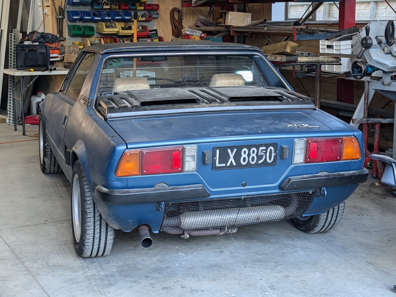

Popular Post ThePog Posted yesterday at 02:05 Author Popular Post Share Posted yesterday at 02:05 The correct tie rod end arrived a couple of days ago thankfully before the wof grace period ran out; And so this just happened; And I was greeted by a complementary bit of even leakier wedgieness which was an irresistible photo op; So fucking excited. 23 2 Quote Link to comment Share on other sites More sharing options...
