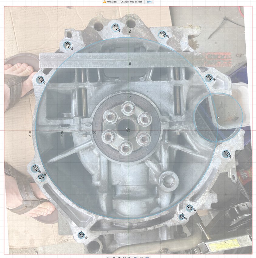

First test cut of my drawing worked. Then I did one of the combination of 2T bellhousing and 1NZ block and somehow cocked my reference photo up for the bellhousing then got Covid. The consensus at drag day was that it’s a great idea. So now to work on the peer pressuring @Dudley phase

I drew this up, I'll laser cut it tonight and make sure it fits nice-ish Then @Roman found this drawing he'd done which gives me an idea of the J160 pattern. I'm also gonna draw up the 4K pattern and see how close that is and @Dudley is bringing me a 2T bellhousing too.

Now someone on Instagram is trying to convince me that Niteparts does a bellhousing for the 1NZ...
Yeah, when we were out at Marino's we were saying it looked like a bike engine crossed with a SIlvertop. The biggest issue I see at the moment is the space between the "oil pan" and the bellhousing mount is quite short. The webbing will need to be cut out to sit over the steering rack, and the cross-member will most likely need to be scalloped to fit around the "bowl". I'll grab photos of the sump soon.
