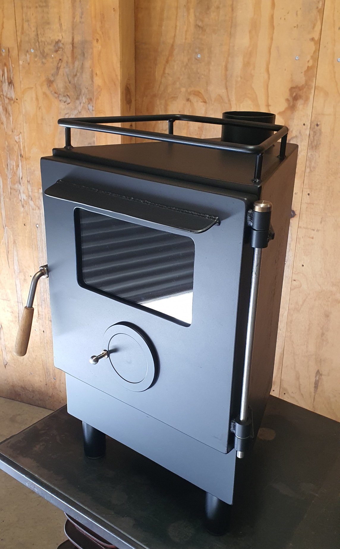

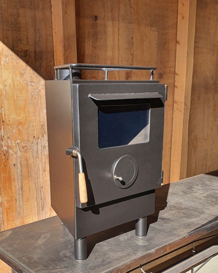

It's got a removable secondary burner plate in the ceiling - more for helping to keep the glass clear. Pretty basic stuff though. -
yoeddynz replied to h4nd's topic in Other Projects
My latest wood burner build. 5mm thick steel. Hefty as. It's got a triangular shaped plan. Rack on top is to hold rocks. It's going into a posh sauna and will be surrounded by sweaty Germans -
