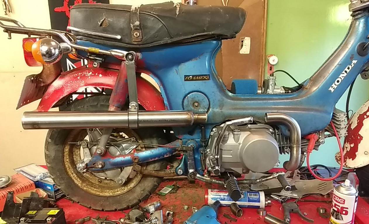

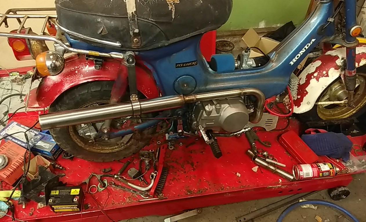

Got my hands on a short length of 50mm OD SS tube, so que my first attempt making a decent muffler Got a sheet of FMF muffler packing, it promises to add 2hp! lol Even with the muffler this bitch is loud! Got a letter from NZTA today letting me keep the black plate, so I went straight to VTNZ and got it rereg'd, so now it's all legal and ready to go! Oh and because it annoyed @Shakotom so much I shortened the HT lead Just got to go grab my helmet from the in-laws in the morning, then it's time to take it for a pest! Can't wait!

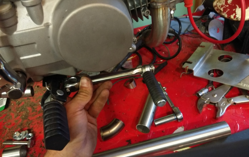

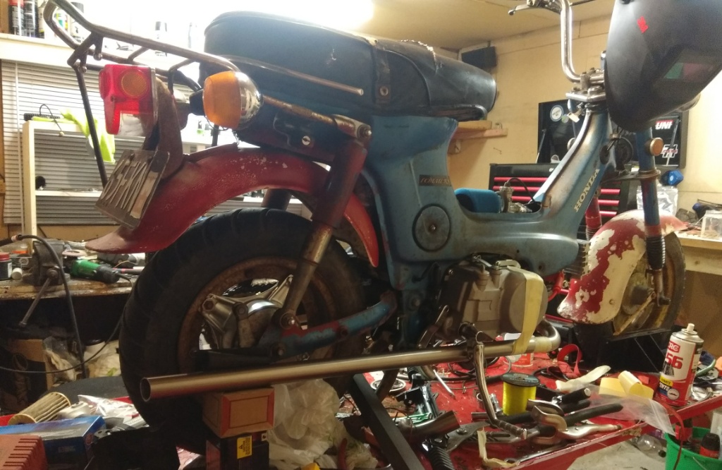

Got hold of some 50mm tube, going to attempt making a short muffler. Made a rear brake pedal, took the remains of the hacked up factory pedal and added an old BSA rifle barrel I had kicking about. Used my Tig as basically an electric gas torch to heat the barrel to bend it, the old hammer forged barrel would have ripped my vice off the bench before bending cold lol Trimmed up the kick start that came with the engine, ground a very deep V, cranked up the amps and loaded it up with filler rod I'm happy enough with that!

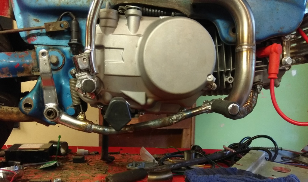

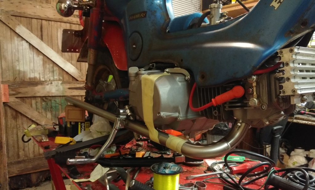

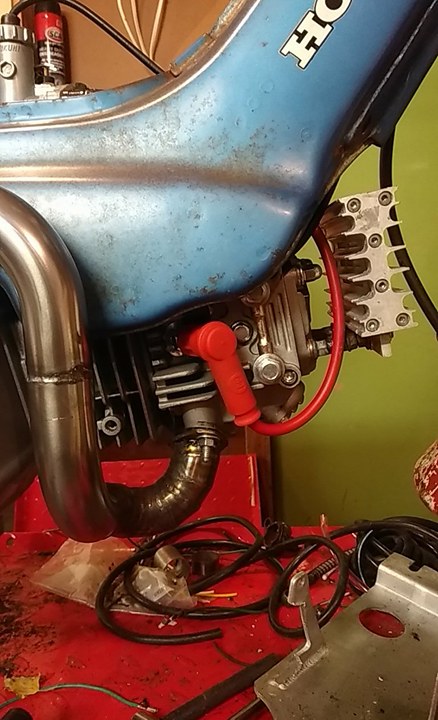

Exhaust has been kicking my ass/showing I have 0 fab skills. Goal was always low pipe But there just was no way I could get it around the footpeg mount and have room for the brake pedal etc, I'm sure it could be done, but not by me! Actually made a few different attempts, but yeah wasn't happening. Close, but ground clearance becomes a real issue. So change of plans My old boss drilled out an offcuts of 304 for me to cut a flange from. First try at welding SS, improved a lot after a while, still likely heat wrap it to hide my mess Potatopotatopotatopotato Think I'm going to re-purpose the kick starter that came with the engine, should make a great brake pedal So close now!

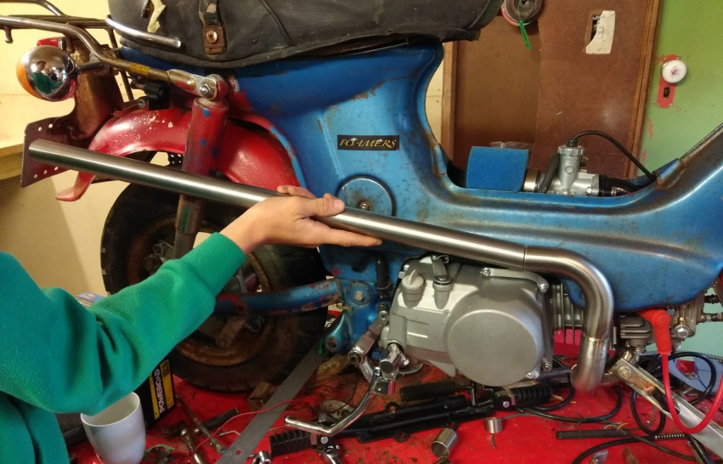

Made a loom @MopedNZ put me on to 1212 batteries, tiny little things but should keep indicators etc happy at least. Fitted the new blank covers to the engine Engine back in Much better looking I think! @Shakotom brought down some SS tube and a few bends, attempting to make my own exhaust, never welded SS so this should be interesting to say the least Might need to call in someone with a bit more skill to help out with making a new rear brake lever though, the CRF footpeg mount doesn't leave much room to run a low pipe!
