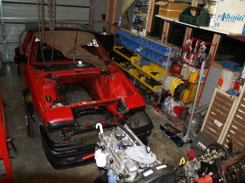

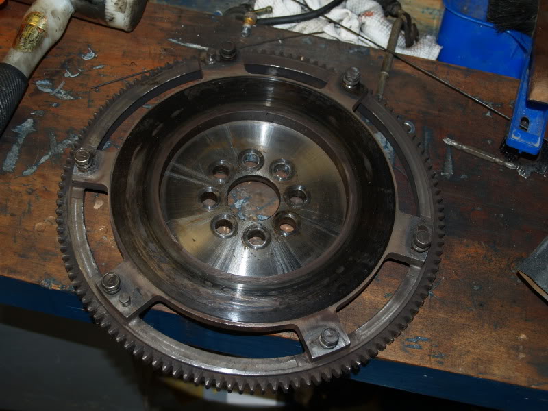

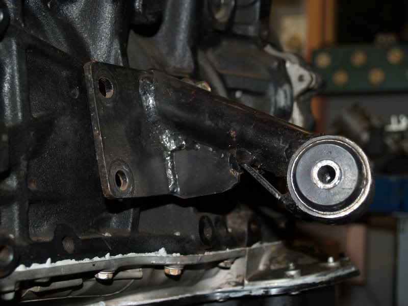

Well, the weekend has past and I have............ cleaned my engine and tidied the shed. Had a good number of helpers on Saturday and it was hot as shit, so we prepared and then went to the river for swims/drinking. Planned on going back home to do more work but just ended up enjoying the sunshine until it was gone. Started again at 11am this morning. First job, swap the sumps over (wanted to have the oil return fitting for my catch can). Turns out the sumps are slightly diferent.... It has space for the crank angle sensor and a lug in a different place. So we looked and thought some more and decided that the factory oil return plus a non-return catch can was good enough. Degreased the engine and looked at it some more. The engine mounts don't fit up the same as the gen 3 block... Another slight difference. On the gen3 there are 4 bolt holes on the intake side of the engine, the beams only has 2, with another 2 further down the block. This means I'll have to make another mount plate for the engine and weld it up. So what we got done was.... P.S - this is the billet flywheel I found on the Gen3:
