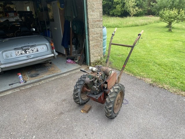

By strange coincidence I was messing with that exact model Villiers engine earlier today. I have one on my Mayfield motor scythe. Yours looks much fresher and less abused. Finding one with a working magneto is a major win. Mine doesn’t work as the coil is dead, which is normal apparently. Coils are available, but at the cost of a complete new China engine. I’ve cheated and got mine running with a battery and 12v coil. I’m only expecting to use it a few hours a year. The patch of meadow it’s supposed to cut is in the background. If I get some useful work out of it I’ll give it a birthday…. BTW, does yours have a keyway for the flywheel or any timing marks? Mine has neither, which caused some head scratching…..
