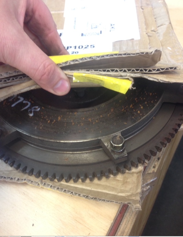

Would ya look at that! Looks like I have the correct flywheel now. still need to get the calipers rebuilt so if anyone can recommend a place or someone to help out it would be hugely appreciated as budget is low Atm -

Gearbox is t50 to so won't clear the bellhousing either
I'll get the tape measure out again but yeah I think your right
