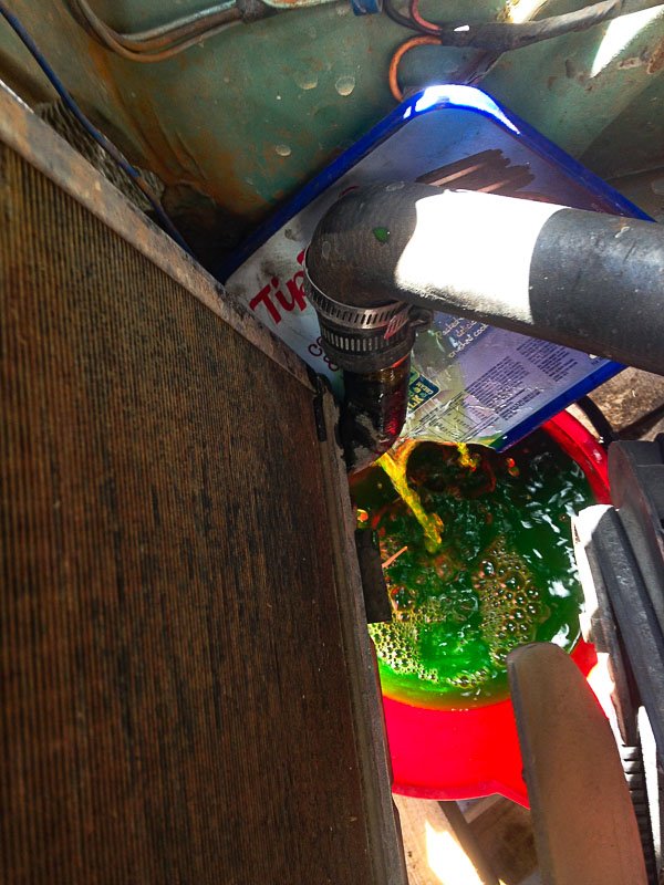

Niva has been having a long rest while I sort out the rocky transition to the working world. After the last big push the lack of compression has bugged me so out the engine comes again for a bottom end rebuild. My fix to the terrible placement of the bottom hose and no drain. (Just cut the bottom corner to prevent coolant going everywhere!) Engine bay is now mostly empty, head is on the workbench, just the rain came in earlier than I expected damping my enthusiasm to climb under and release the lower bell housing bolts. Once the block is out i'll strip it down and assess what parts are required, hopefully just rings and bearings and no major machining! I've also ordered a 14point7 SLC Free unit with the aim of tuning the carbs to better fuel economy, digital times ahead.

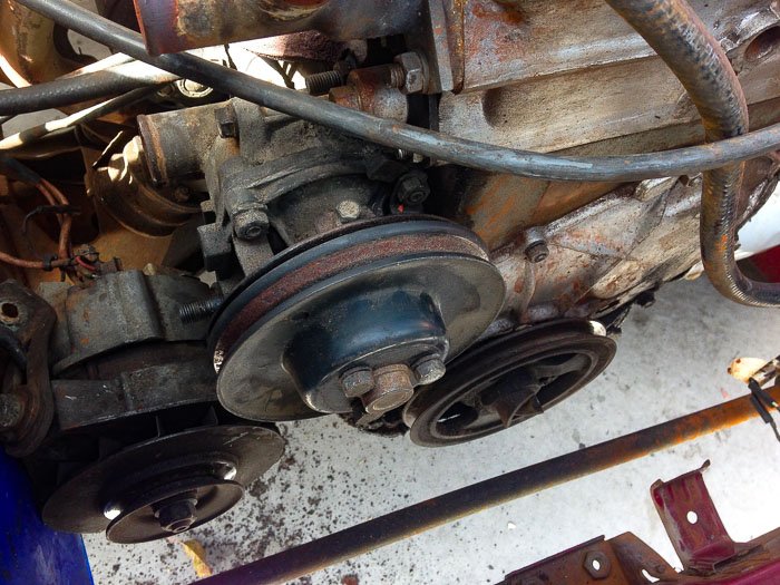

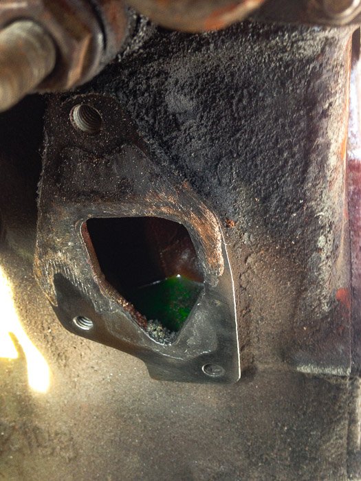

Just before christmas I fitted the radiator claimed from the wagon, for the first time since my ownership the electric fan switched and I had pressure in the cooling system, this joyous moment however was short lived, components used to a leisurely low pressure life suddenly had a job to do resulting in the waterpump seal letting go and the poor girl stuck in the driveway over the break, while up north seeing family I raided the waterpump from the original Niva engine (neglecting it has sat idle since the Niva's twin cam conversion 7-8 years ago....) Set about replacing the bits this morning in what should have been a 5 min job Someone previous had used a very sticky gasket that resisted everything I tried even shrugging off a linbide scraper! this required removal of the radiator allowing wire wheel access. Looking at the picture it seems to have some kind of fibre reinforcement? 2 hours of cursing later and on the road again! now to switch attention to the Niva lurking in the shed behind...

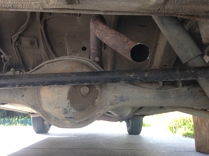

Sorted out the issues with my MIG and borrowed some gas to weld up the muffler only to find the nozzle was awol..... Yeah/Nah Also after a closer look the pipe is pretty rotten, also the whole lot has been fizzed up and there is no way to separate the bits to repair off the car, new plan is to rip the whole exhaust out and repair fresh. Brought a new nozzle and a handfull of tips ready for the wind to die this weekend so I can get it done

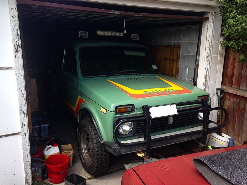

The poor 2105 has been parked up for a few months as I just haven't had the time to do anything but with a new job starting in a few weeks i'm going to need a handy run about. Filled 20L from a jerry can, checked the points, gave the carb a prime and crossed my fingers, amazingly the battery was still fresh and she popped into life. Engine runs so a quick pre-wof checklist: Bleed and adjust brakes Replace shock bushings ( they look a bit worn) Fix horn button Weld muffler back on (the reason for it being parked up) Find some 175-70-13 tyres for the rear to match the front Find a spare wheel (yeah not wof, but its turned out to be quite a mission to find a spare locally!) And any other little jobs that I find on the way, such as fitting the Niva springs for some low. Finally moving away from student life I may even sort the panel work, but i've got my eyes on another project so time will tell... Actually this might be an excuse for an order from the motherland too!
