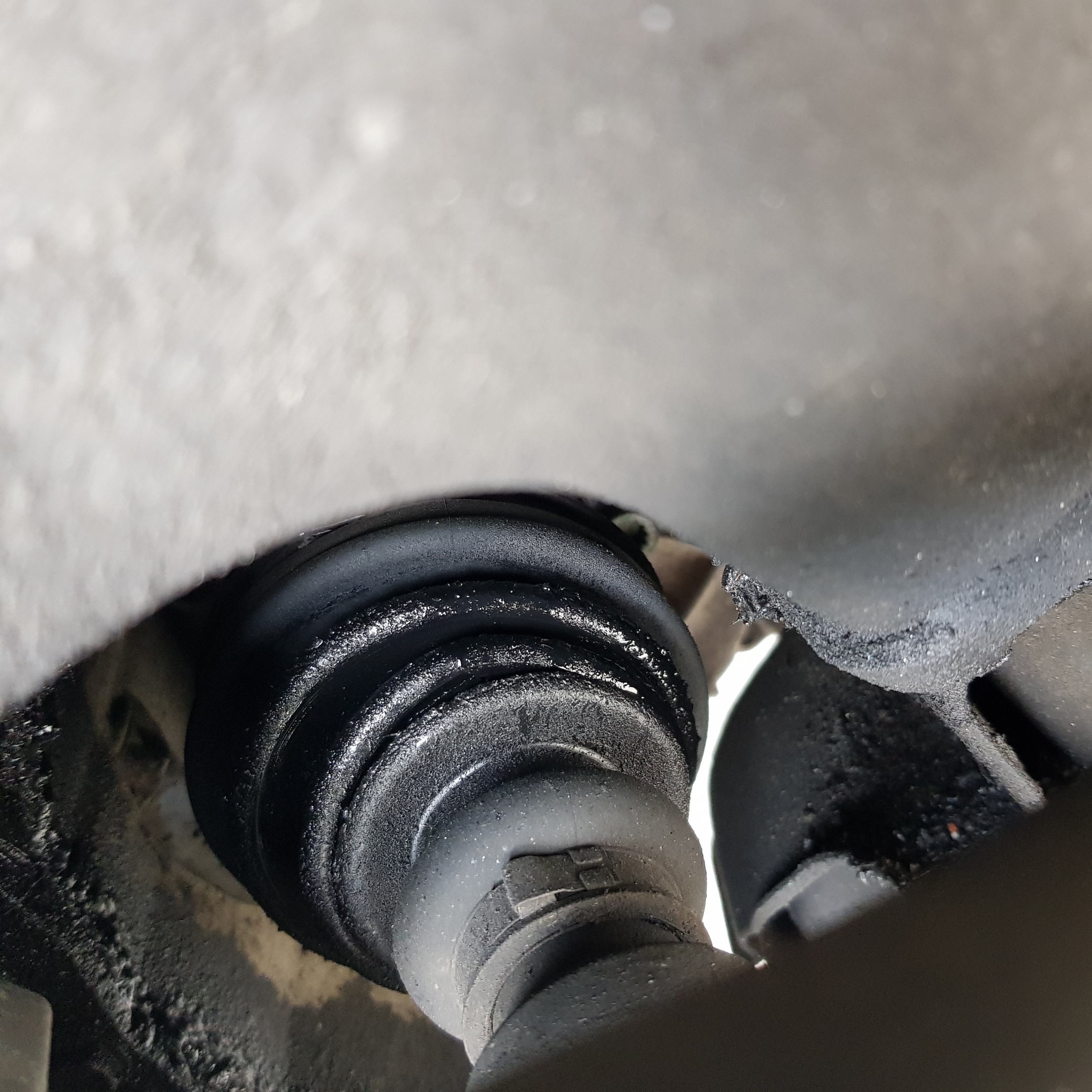

  16. Yay Volkswagen New one has shit a cv and started running like a bag of dicks all within 600ks. Fan bloody tastic....
