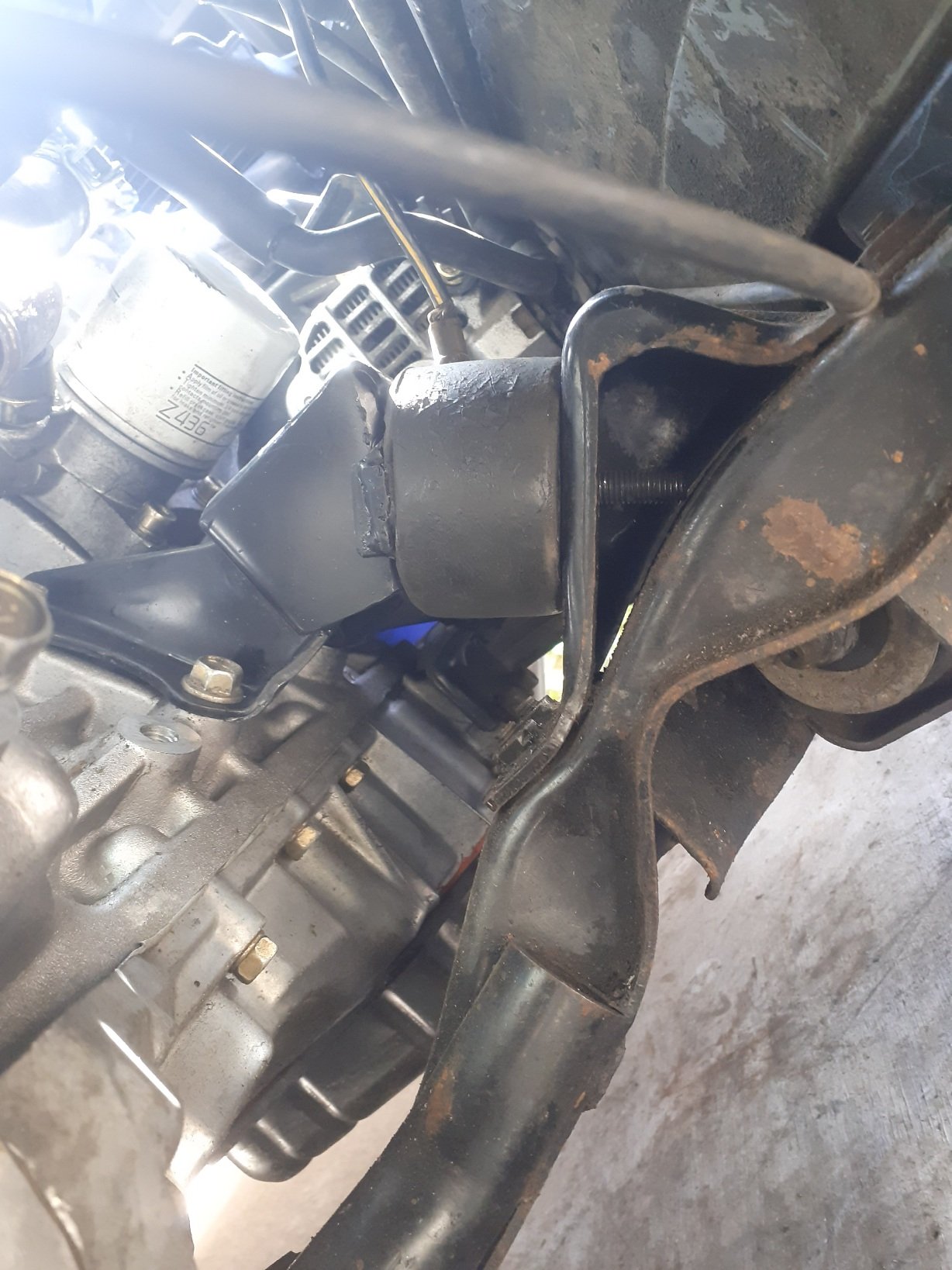

Finished welding engine mounts and boxed them in for strength as well as welding tabs on rubber mounts to stop rotating, halfway done still want to drill a hole in both for sake of access and then paint when I have some black paint

And engine mounts are in and final and driveshaft bolted with some slightly modified bolts to fit them in place

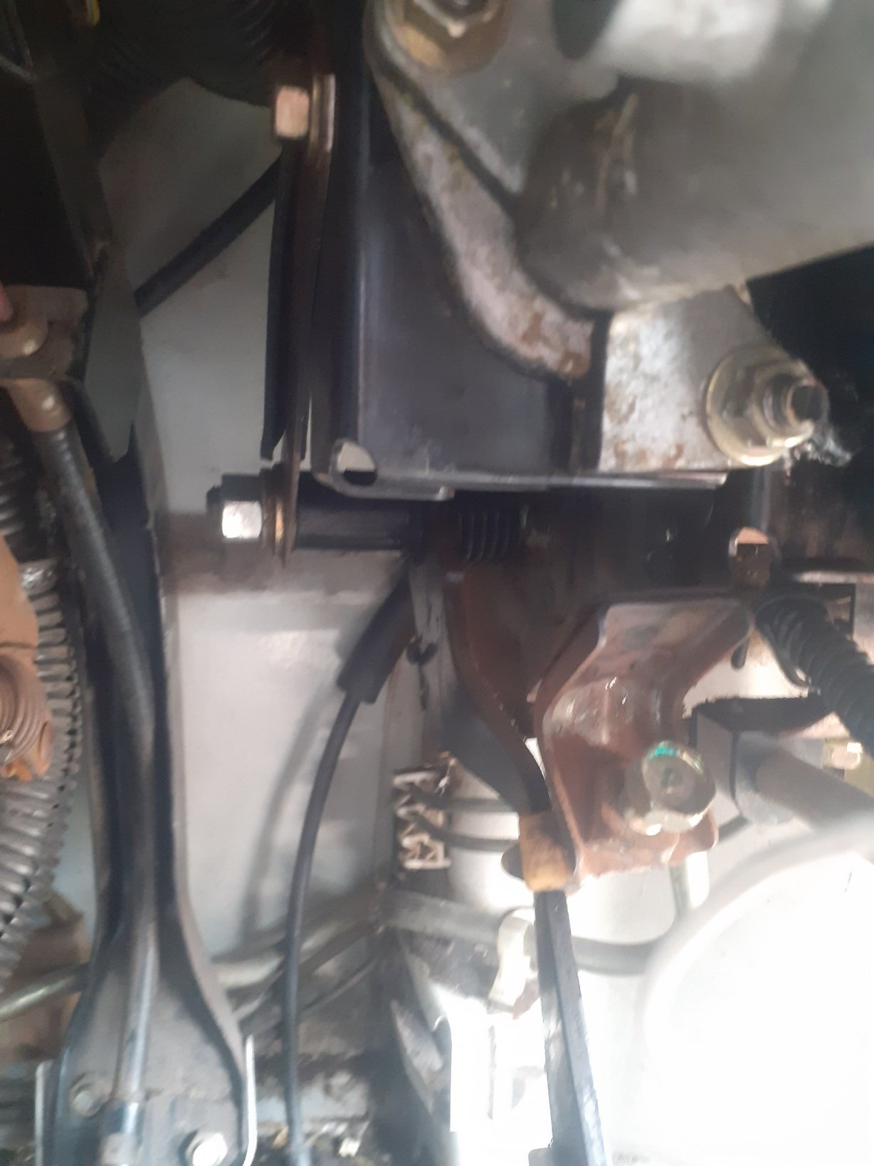

Started the final push to get the van running, only a couple of hours today in between looking after little one and that, I pulled gearbox and did the final clutch install/ torqued and the mounting of gearbox and driveshaft, and figuring out the clutch line and master cylinder, which .... of course .... my new van doesn't have.
So I made a hard line up, from lines in the donor van, really not that hard . The master however will need some attention, not sure if I'll put the whole unit into the new van, or weld it onto the old, we will see tomorrow merry Christmas !
  • Like 4
The clutch hard line will be connected in the middle by where it will enter the engine bay for ease of installation, all parts(of course) salvaged from the donor van, and yes I paint/grease/service all parts before installation, the clutch bolts got loctite and slave painted black as it was a bit rusty .
  • Like 5
Remembering how hard it was to remove the pedal assembly from the old van (an axe was used, amongst other things) I opted to splice the hydraulic clutch bracket and pedal into the new van, drilled out spot welds, cleaned it, tig welded in place with regular cooling.
