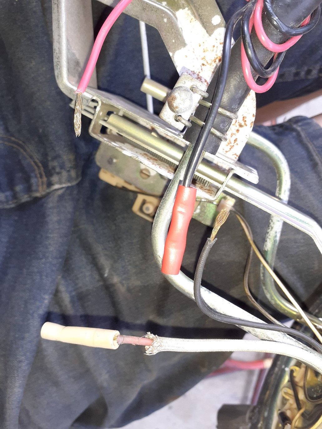

Pulled out of the crimp quite easily, but still dont know why someone wouldn't just solder the pump wires to the housing as I did.. the wires were long enough ....
