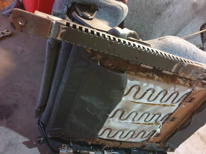

Now i wish i had more photos of this time, but any way, i had done a once over and driven it to work a few times so i booked a cert for it, i told them basically i dont know f-all about it but i wanna see if it had a chance at passing lvvta.... let me know what to fix basically.. and they really did.
3 pages of failures ranging from blown out bushings to more serious stuff like the modified engine cover with modified seats, seatbelt anchorages, raised seats to a unacceptable level (i did wonder why my head was touching the roof). following photos will show some of these things..

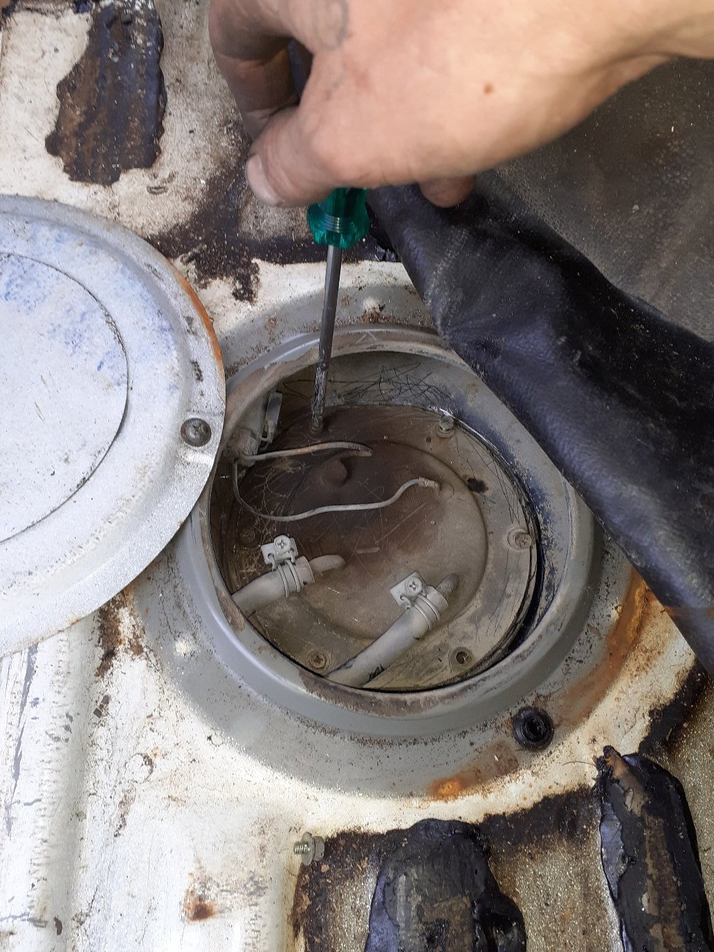

I looked for something easy to do while I had some time, and figured I'd throw in the silvia fuel pump, removing the old pickup assembly and almost put the modified one in when I noticed a potentially dangerous situation...
