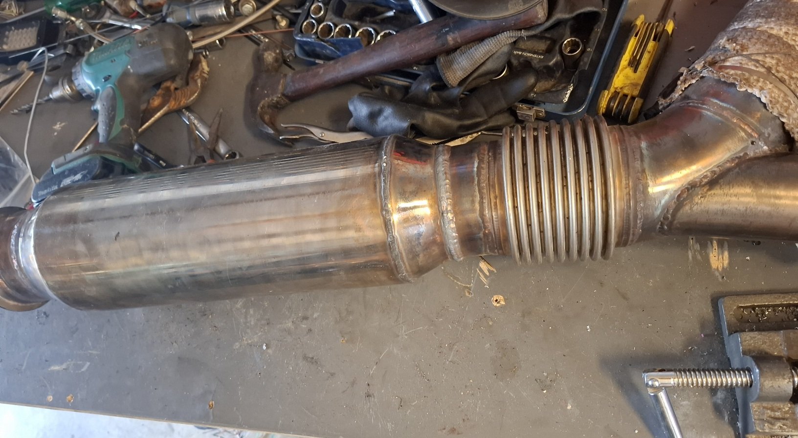

  6. Cut open the maxfab resonator which was having a hard time brought a louvered 3.5inch core from Adrenalin r and repacked it with stainless as well as the glass packing that it did have, should last longer hopefully, also the core is only welded on one side inside so it has some room to expand with heat. Hopefully it's a bit better now and i won't be worried it's gonna collapse and damage stuff. Adrenalin r stuff is pricy, but the quality is definetly there, my rear muffler is also Adrenalin r, non louvered 3 inch now. sounds nice and takes a lot of the drone out of it .

  16. Ok so this car runs great and I've given it another oil and filter change, now I'm trying to shut it up... I half forgot this had a green sticker, for noise ... well turns out the laws were changed since I had one, and now you need to get your exhaust certified, about 400$ and the noise limits and 4500rpm for rotary cars makes it near impossible for a performance rotary. I brought a small truck muffler and modified it and filled it with packing and it was much quieter, went to cert guy and he did a quick check to say it needs even less sound, that was pretty gutting, so now I've done a much more extreme muffler that should be quiet enough, should be easily used for wofs and the cert, but maybe not long distance or boost because it's too much backpressure. Swapping out the mufflers can be done in 5min with the v band acessable from wheel well and just swap it out on the floor, so that's easy enough...
