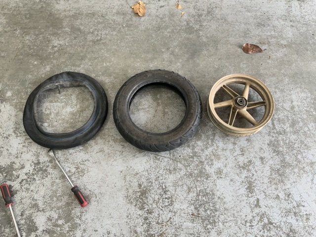

Most of the parts except clutch are worn out and I decided to replace them. Why did the previous owner put the tube tyre? That is a tubeless rim:mellow:

I have taken out the old valve and have put a new one. you do not have to buy a special tool to put a valve, just put  a nut and pull the nut by using pliers.

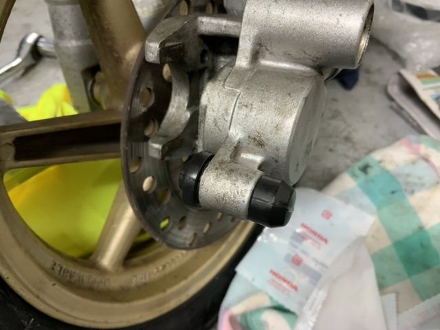

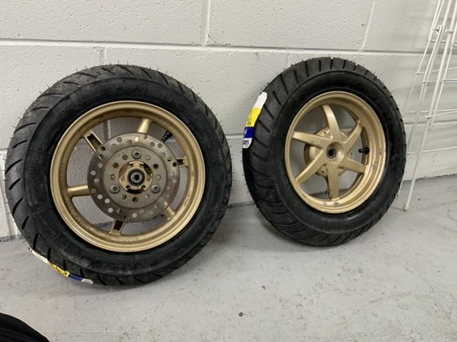

Put new tyres on. I have chosen Michelin S-1. Then cleaned the front break caliper with a tooth pick. I could have used pick tool but I have prevented myself damaging the caliper.
When I put the rest of rubber parts, I used a Hex key to put then put reasonable amount of silicone grease.

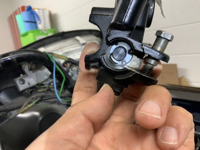

Yes, of course I needed to replace the master cylinder piston. I have taken off the rubber cap then I needed to remove the circlip .
I had a 90 degree circlip pliers which didn’t work so got a pair of pliers at repco ($16 they are cheap, but I still had a difficulty removing the circlip:()
  and have used the 180 degree attachment.
After I put the new piston, I put the new rubber cap with some silicone grease.

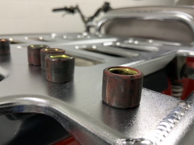

I thought I purchased 6.5g weight rollers but somehow I have got 9g WRs...I know that’s too heavy...

If it’s staying 50cc I’d go with 5 - 4.5g rollers. This will keep the rpm’s up while it goes up hills and it’ll still do 70kph on the flat.
To test it out you can add only three 9g rollers evenly spread which would have similar total weight as running 5g rollers. 9x3 = 27g vs 5x6 = 30g.

Thank you for your advice and I put 10gx3 WRs which came with the exhaust pipe. No offense taken but, what happened to the bike is I could not go faster than 30km/h and I almost cooked the E/g:blink: that is because of I put the super high speed pulley? um...I have to get some WRs
That means the rollers aren’t heavy enough to squeeze the belt high enough on the pulley at high rpm to get it into a high gear.
You can draw a line with a marker on the face of the pulley to see how high the belt is going at max speed. As the belt lifts the marker pen is rubbed off.
