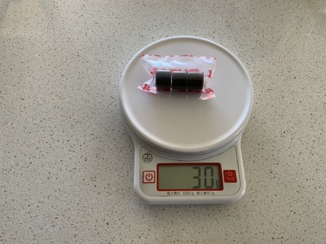

    And I have put lighter weight rollers. current setting is 5.5g x6. I will see how she goes tomorrow!

    9gx3, 7.5gx3 i just followed instruction of super high speed pully

    Finally they got here! Daytona full degital CDI, WRs 6.5g and 7.5g and air filter.

    Thank you for your advice and I put 10gx3 WRs which came with the exhaust pipe. No offense taken but, what happened to the bike is I could not go faster than 30km/h and I almost cooked the E/g that is because of I put the super high speed pulley? um...I have to get some WRs
