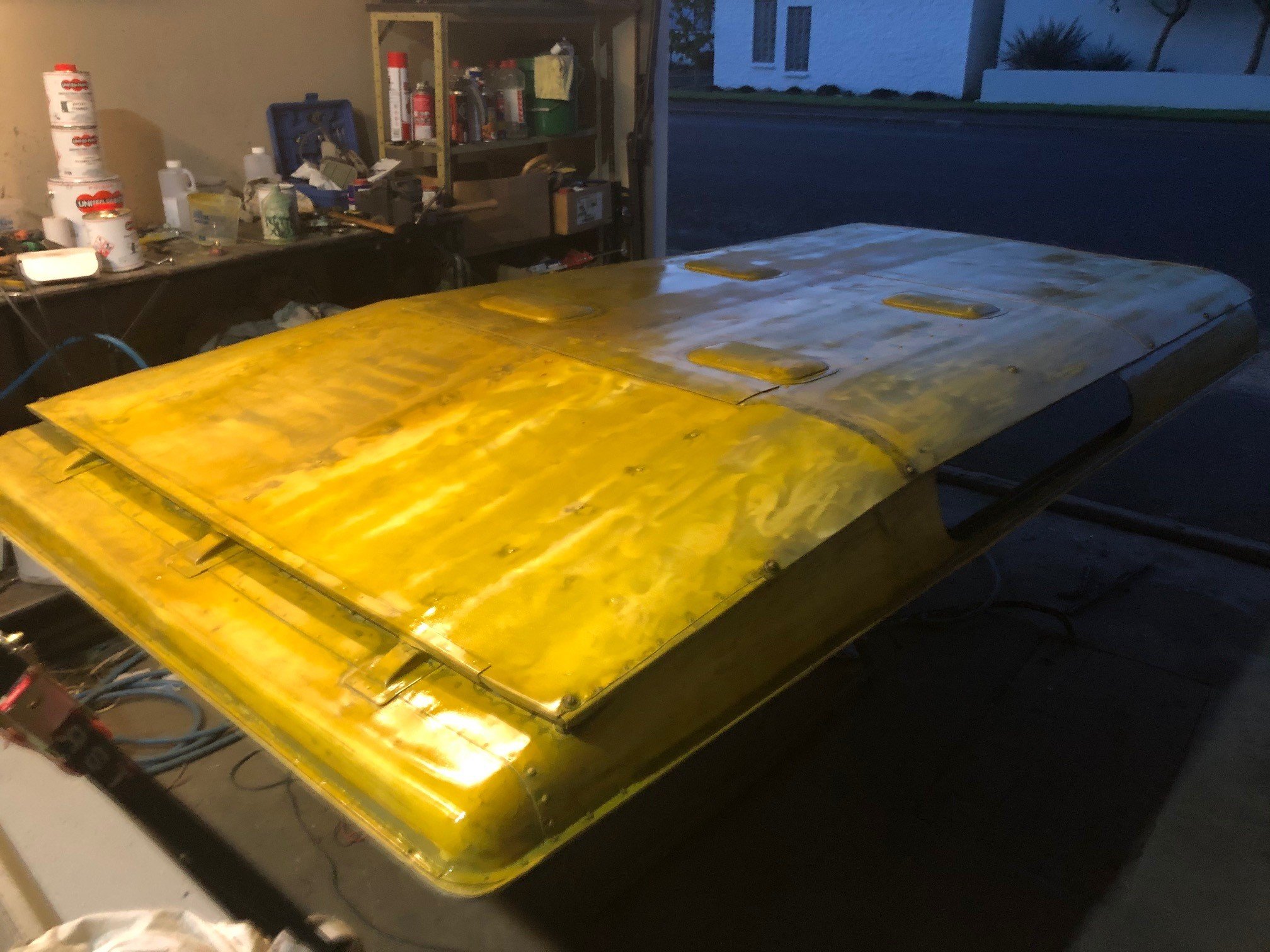

Popular Post nzstato Posted June 5, 2020 Author Popular Post Posted June 5, 2020 Going to put this here, its not very interesting but it might help someone. This is the same picture as above, it 'looks' good but has alot of problems. In below, the red circles highlight some massive hollows (1") in the panels. You would think the solution is to get a hammer and bash them out but those hollows are a symptom of the problems.... The blue section is massively stretched and it has a brace behind it which is bent, the green shows the lower edge which is bent into a curve. With flat panels like this I need to sort the edges first and the rest should follow.... Here I've drilled the spot weld of the brace out (the clecos are holding it in) and using a leather sandbag with heat and the hammer have shrunk the green section back in, it has pulled alot of that lower hollow flat. Straightening this flange was a right pain. I ended up heating the edge and got medieval with the hammer and dolly. It doesnt look pretty but its now straight across the panel which is most important. Its still hollow below this, but thats due to some stretched ridges which continue from the green section, I'll planish the fold out and then shrink them down.... 13 Quote

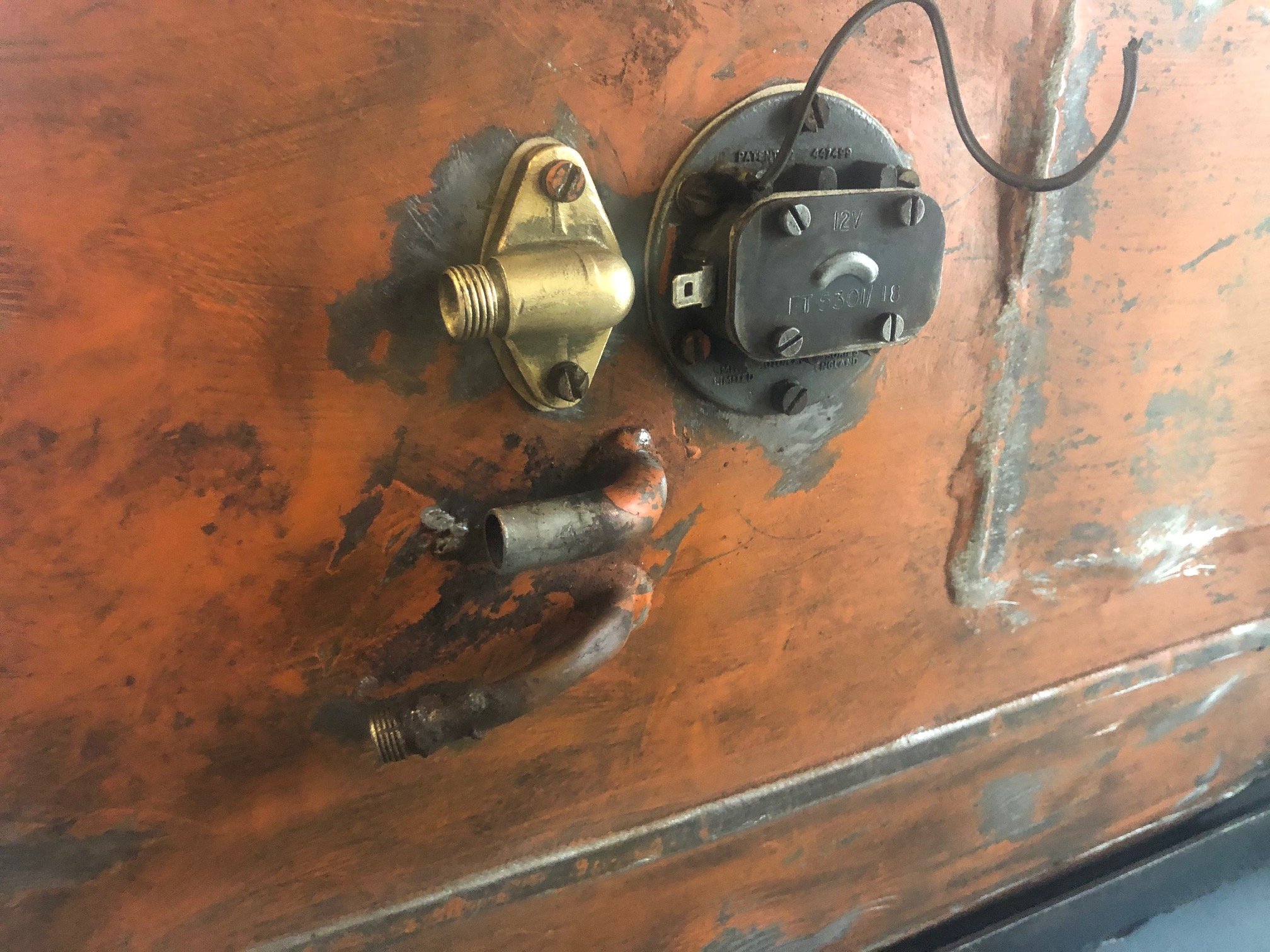

Popular Post nzstato Posted August 2, 2020 Author Popular Post Posted August 2, 2020 Try as I might I just couldnt get the lower quarter right, its just far too stretched and hollowed to come right again. Annoyed me so much I cut it out and started alloy welding a replacement in. Welding this burmabright isnt the easiest thing in the world, got 2/3 of the way through and ran out of gas. The fuel tank has a lead it it when the level is over 1/3 tracked it down to a section where the seam was separating. Took it into my glassblowing shop to repair, way easier to use the gas torches already set up there. I sent the second row doors and the rear barn door away for sandblasting. When you go to pick them up and they say "you've got your work cut out for you..." you know you are in for a treat.... Pretty much the entire upper box channel which starts from the window channel is gone (both sides) from those blasted drains. Decided not to much around and make it from scratch.... I really wish I had a wider folder good enough to do this kind of thing (save the $$$) as I'm having to make the channels in 2x sections... 12 Quote

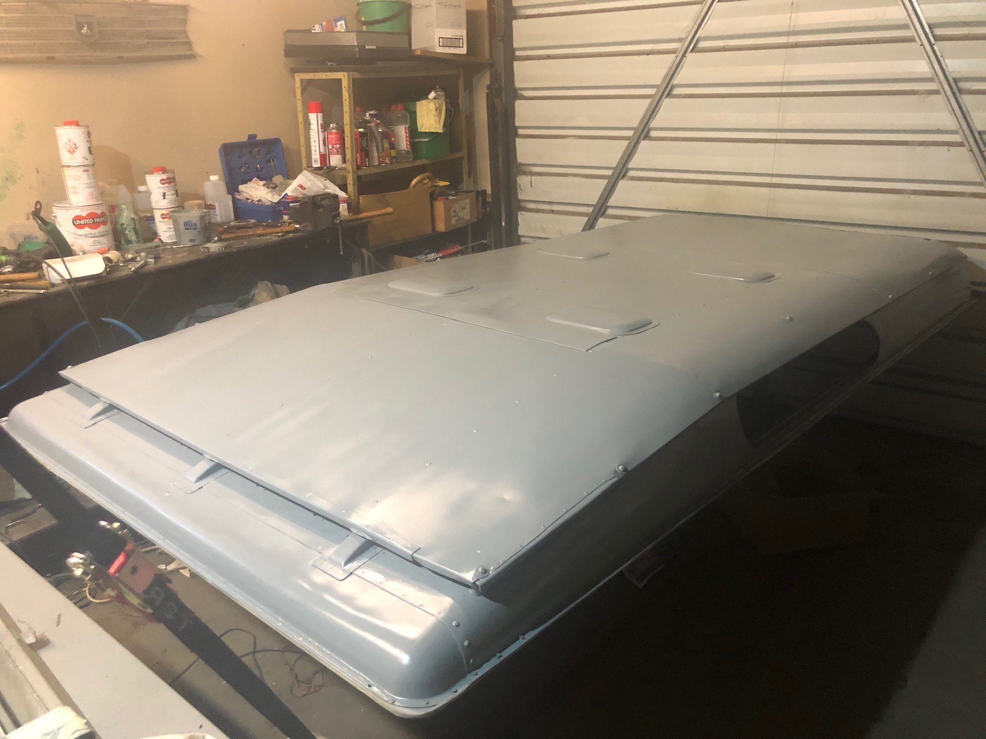

nzstato Posted October 18, 2020 Author Posted October 18, 2020 Still plugging away but have been a bit slow... Roof has been stripped and I've fixed up a few holes and redone some of the rivets Its pretty tight in my single garage now... am working on the cab sides to mount fixed glass rather than the original sliders. Resoldered on the fuel gauge and cut some new gaskets. Need to fix it back into the chassis so I can drive it round into the shed and start mounting up some of these body panels. 7 Quote
