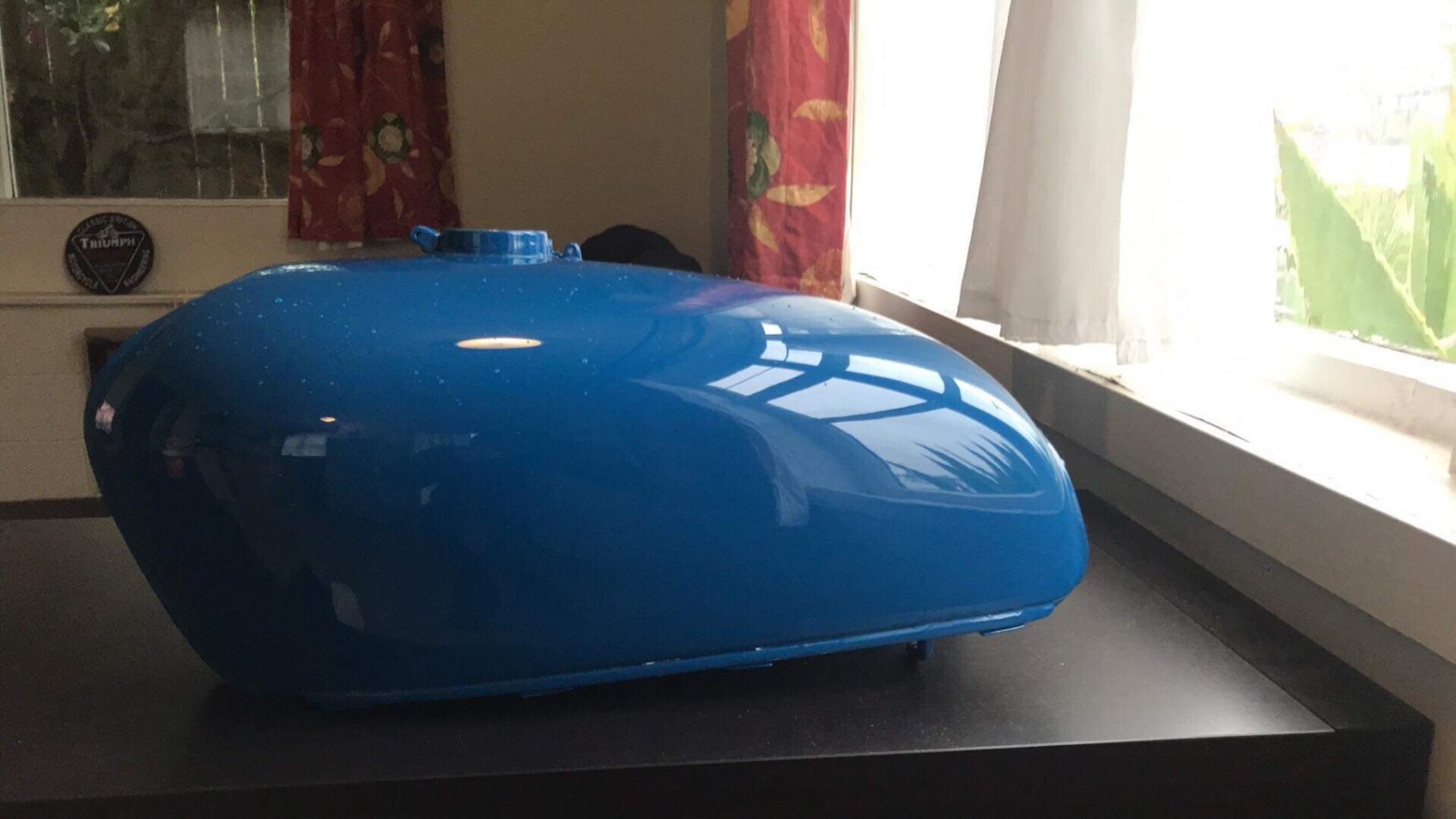

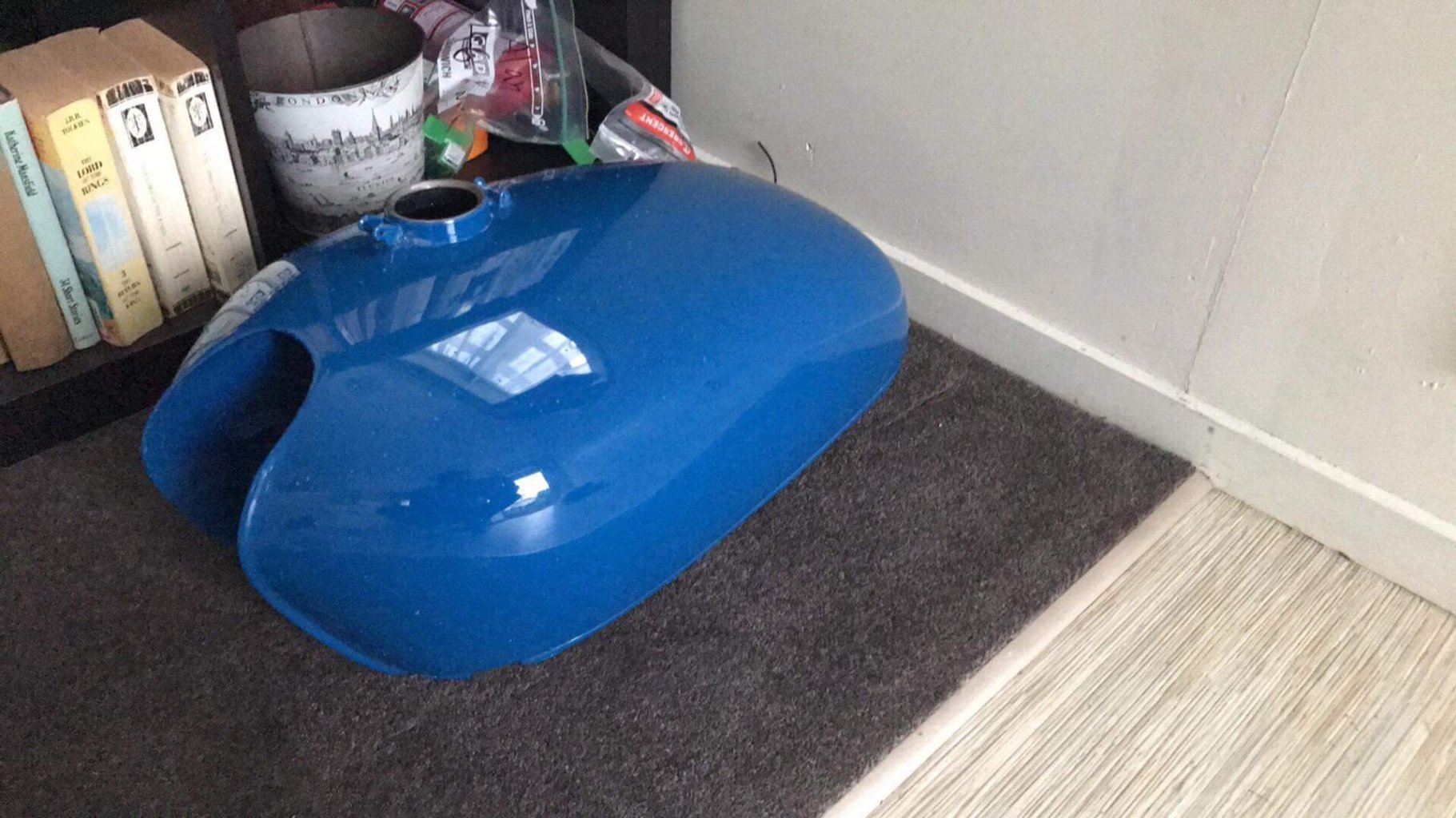

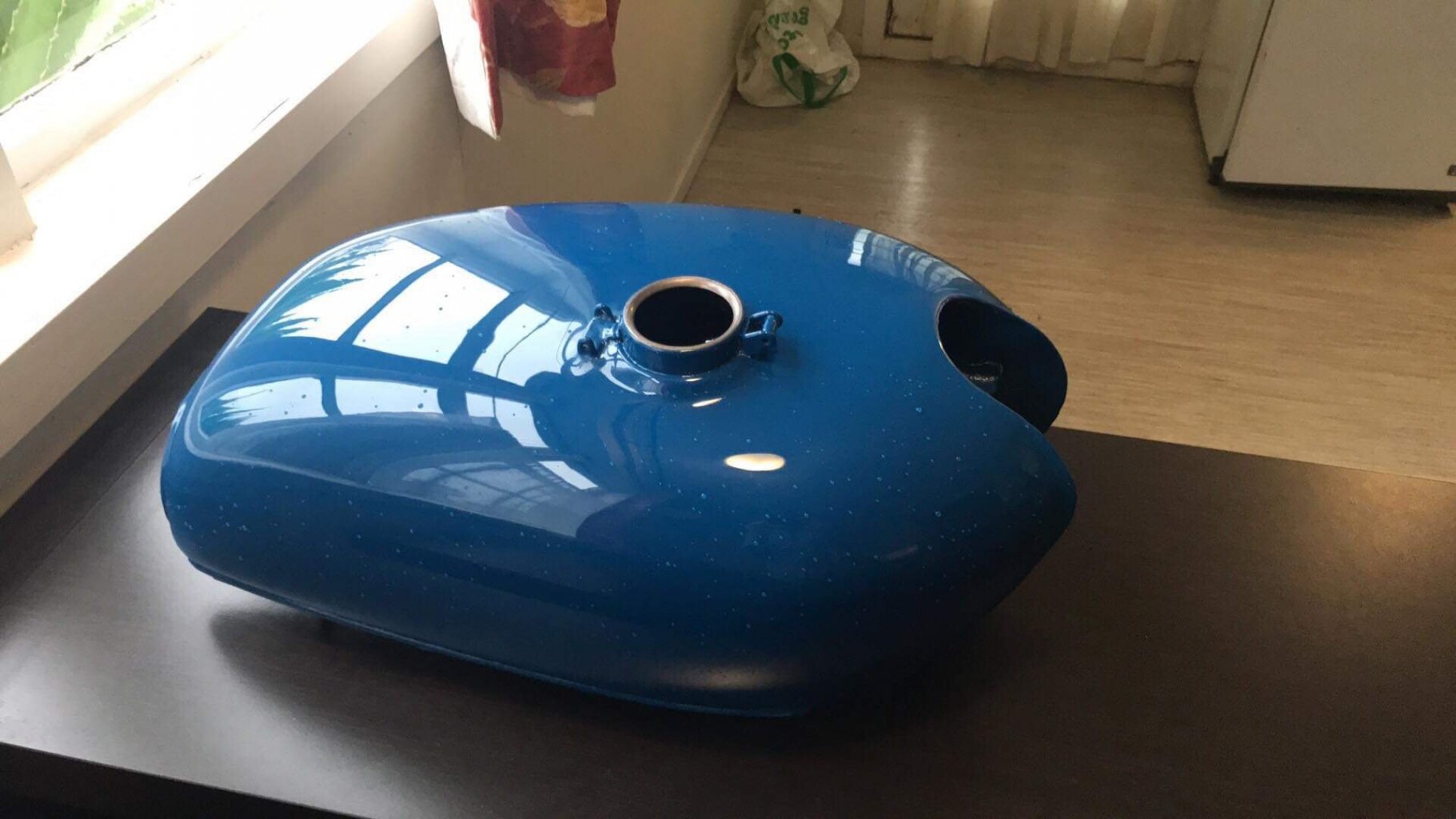

Got the tank back from the painter, stoked with how it turned out, tried to keep as close to the original colour as possible but with high gloss.
Gonna look mint with the new chrome strips and chrome fuel cap fitted. Also going to add the Honda wings logo to the sides.
Quick compare to the old paint, about a million times glossier than before and maybe a shade lighter because of it but stoked with how it turned out!

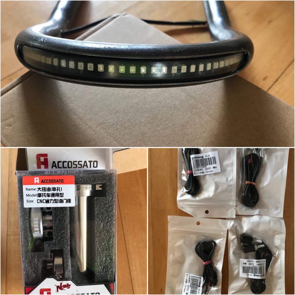

AliExpress stuff arrived too, looks great so far! Haven’t had a chance to test it out yet but I’ll report back later.
