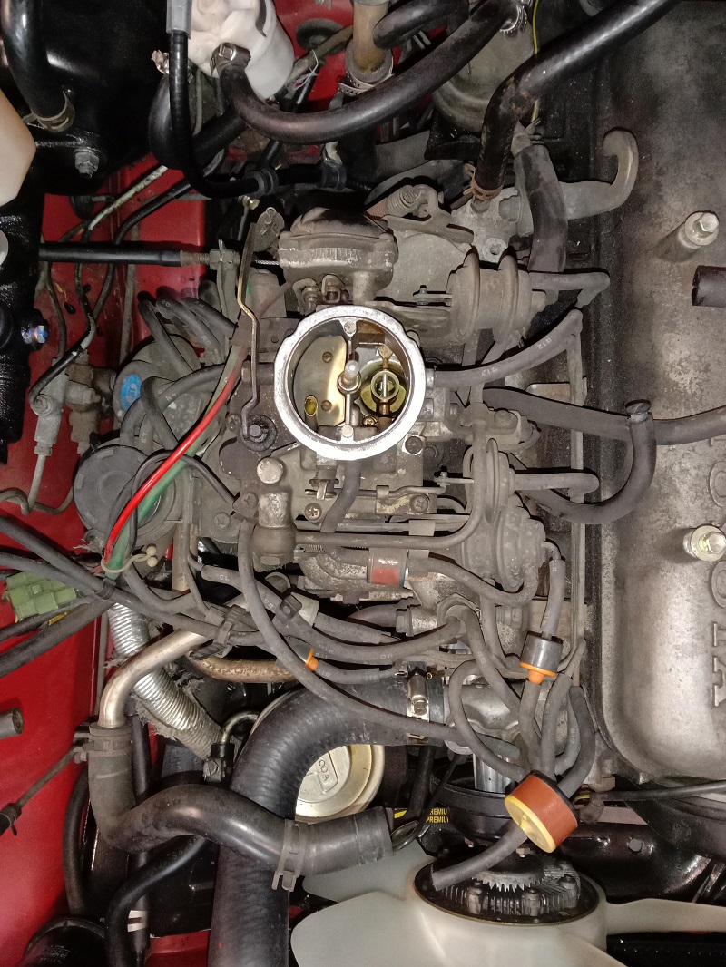

Popular Post Bling Posted June 12, 2021 Author Popular Post Posted June 12, 2021 Still chipping away on this fuck. Removed the carb the other day and had local workshop look it over for me. Main jet is pretty corroded so not sure how well it will run, or for how long, but YOLO. Reason I had it looked at was due to sitting for so long she was a bit gummed up and so wouldn't idle properly and wouldn't start without kick in the dick. Installed the carb today and it now fires off the key no worries, doesn't run that great, but will stay running. Win some lose some, i'm hopeful it's now just down to having a bunch of vacuum lines not connected and no air filter at all. Coolant has started to leak in a couple of places, one of which is behind the water pump, under the carb. So yeah a right PITA to get to. Tomorrows job will be the remove half the front of the engine to remove the water pump to try fix that. It's also leaking on a hose at the rear, so will try find a hose that will sort that. Gave it another tickle up alignment wise and it's looking a lot better. Todays plan was to drive around the block sans windscreen, previously mentioned water leaks killed that idea. Replaced the diff and gearbag fluid recently, neither of which looked that dirty, if I exclude the drain plugs (pics to follow). Had a few leaks on the gearbag, so got up and personal with it to find out why. Speedo drive thread had a massive cut mark on a 45 degree angle, so was never going to seal well. The bracket that holds the speedo drive was also MIA. Read the Toyota manual and noticed there was supposed to be one so made on up to suit. Cleaned the threads as best I could and goo'd everything together with some non setting gasket stuff. So far so good. Nothing much to add really, still on the list is windscreen install and proper alignment. Pretty good odds the wheel arches are both going to need a bash, which is something I wanted to avoid. But at this point I don't care about going beyond the point of no return. So will probably level the car up a bit before alignment and worry about clearance at cert time. Will then discuss best way to go about that as i'm not sure. Pics. Gearbag filler plug, after initially seeing it I figured i'd be welding a nut on it to get it off, but it JUST came off before becoming further chewed up. Quite impressive, not sure what was bashed on this previously. Luckily I had a supply of dirt cheap rockauto sump plugs on hand. So most things got new drain plugs and washers. Fresh fluids, VMX big boy was from when I had a starlet, circa ~12 years ago. I knew i'd need it one day... Gearbag or diff drain plug, I forget which but they both looked similar. Before / after. Carb on car so I could plumb it back up right and on bench. Handy having another car with the same setup, I managed to find a few hoses in the wrong locations. So much unnecessary BS hosing. Will google for a supply of vacuum hose and run hoses between locations that have none. Can get rebuild kits online buy the looks, so if I find it runs like a bag of dicks after connecting up 100% of the vacuum lines, i'll look in to that. So long as it runs good enough to get through cert process, that can be a future problem. 20 Quote
Popular Post Bling Posted September 7, 2022 Author Popular Post Posted September 7, 2022 Shit a brick, over a year since last update... So believe it or not, this thing is still progressing. I'll try remember what i've done while I write this update. I have taken it to my local garage to get some jobs done. Jobs I can mostly do, but I want it in for cert this year not next year, so gotta be done. Had the carb checked over with some work done to get things running a bit nicer. It starts easily now and runs fine, just needs a bit more work when coming to a stop. I'll probably fiddle with the idle a bit and see if that sorts the stalling. If not i'll get garage to take another look. I got some longer shocks for the front coilovers as I was sitting a bit low (impossibru). Wanting to keep the fenders factory so that coupled with pretty square tyres on much wider than factory wheels, means they are close to rubbing it too low. So the shock bodies are 50mm longer, which gives me the option to keep it as low as it is now and also lift it 50mm while still having enough of the shock captive in the sleeve on the hub. I also installed some keeper springs up front as I only had 30mm of droop from memory, so now I can have 30mm up to quite a lot. So i'll set it at 40mm potentially for now. But may change that to 50mm if it isn't going change my bump steer enough to cause issue, I have no idea on that stuff. Rear suspension is unchanged, but I still have some work to do in that area as I don't think I have enough droop there. So may need to look into the 1/3 droop rule. There is only so much weight in the rear once you take the diff and wheels out of the equation. And the springs I have were developed specifically for AE86 and are progressive 4.5kg. Worst case would be having Cobra make me some springs of lower rate, but that is last resort as they will not compare to the springs I have ride wise. Can only fill the fuel tank so much, so i'm a bit stuck as to how to add some more weight without it being super obvious that's what i've done. Anyone with ideas around this problem please let me know. Interior is complete now, all belts installed, plastic trims and the likes. Have swapped out the dash cluster as the temperature gauge wasn't working. Asked in spam about diagnosing things and found the sender on the block is working fine, the wiring was fine, which only left the cluster. So i've swapped in another one, thanks Goat for including all of the spares with the car! So I now have a fancy as fuck analog clock and no tacho, but a working temperature gauge, so i'm happy with that for now. Don't have the money to pay someone to fix the other one at the moment, but i'm sure it's something I can swap back later. So now I have a working gauge I could see that the engine seemed to be staying cool enough. I'm not 100% convinced the thermostat is working correctly. So I may swap that out when I have a bit more motivation, just to be sure. So that's where it is for now, fine tuning the running of it, then i'll book cert and alignment. Still haven't set the final height yet, but that will happen. Excuse the wall of text, there will be lots of missed, but no point making the wall longer, so here are some pics. Fred for discussion etc Oh yeah forgot I 3D printed a few bits for the car, very rough and ready, but I have a better 3D scanner now so plan to make some better parts when time allows. Longer shock body comparison Printed bases for my mirrors, only have one good one with car so 3d scanned it and mirrored for other side. Came out ok, but will improve on it when I have time. Had a taillight to fix as well. Replacement lights are just not a thing here. I spent a very long time watching Japan auctions but any I found went for (to me) silly money. Think the last pair was north of $500. So I printed my own repair as I don't care what it looks like, so long as it's functional. Before: Printed a test section out of plain orange filament I already had. This was after scanning the taillight on my other Corolla. I could have just as easily scanned the passenger taillight of this car which isn't damaged and mirrored it. But since I had a drivers side to scan, I did that instead. Didn't take too much work to turn it from a scan into a printable object. Print new piece out of transparent orange filament. Trimmed the original print down till it just covered the damage, before printing the final version below. Sitting in place Glued in place and painted over the whole thing a few time with transparent modelling paint. Got it closer to original shade and tinted all the clear glue I had used to fill the gaps. It's no piece of art, but it sure beats the before version. 23 Quote
