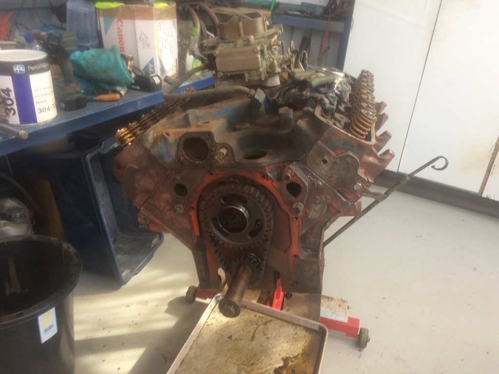

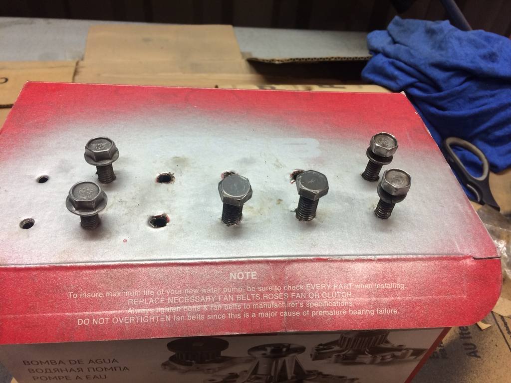

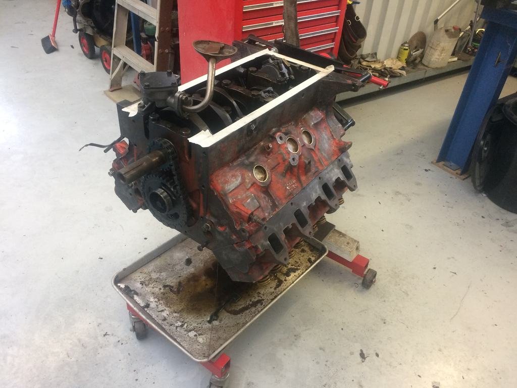

Popular Post piazzanoob Posted October 30, 2018 Author Popular Post Posted October 30, 2018 so i decided that i would keep up with the normal oldschool tradition and pull my car apart once shes all legal. so the other issue this car had was the carb setup it had some unknown brand cheap carb that you couldn't get it to run mint on. so the plan was to put a four barrel manifold on to help it breathe as it only had a two barrel one currently. but the plan was to do that after the cooling system was done. but when i removed the waterpump it had a pipe that joints the waterpump and manifold well that pipe broke due to being rusty and old so that would've needed to be fixed but figured it would be better just to put a 4 barrel manifold while i was at it seen as it isn't much more work right plus it would've ended up pulling the same stuff off twice. plus it had a oil leak from the sump which required motor out anyway and other areas which made the nice clean rebuilt trans not so clean. oh and how the engine bay and motor didn't look so great so now oh while im there i may as well do that as its not much more work has involved itself into this car haha. 17 Quote

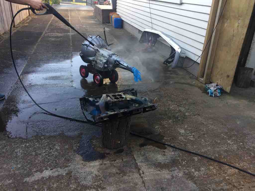

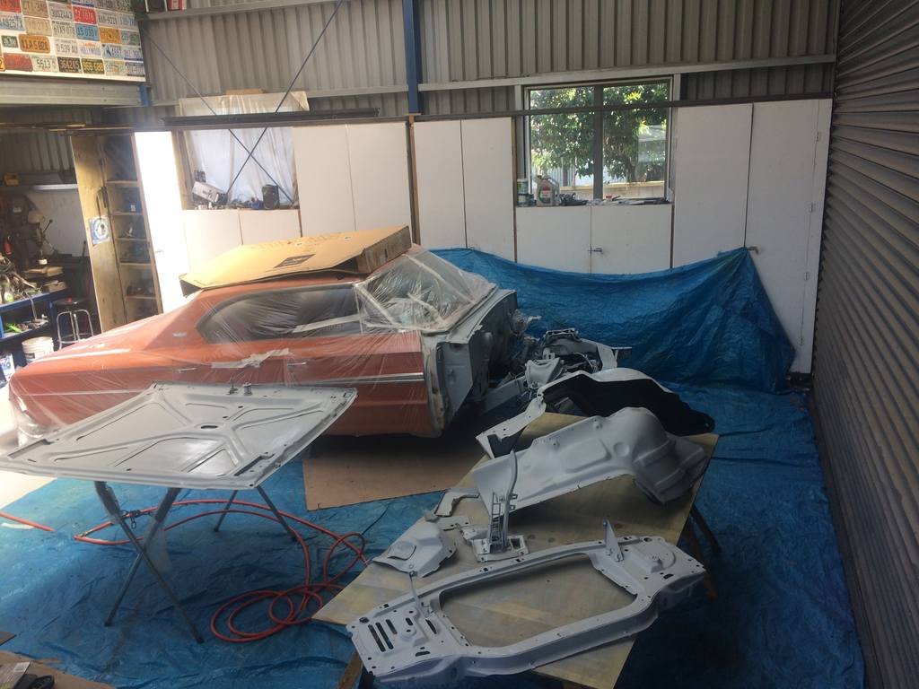

Popular Post piazzanoob Posted November 1, 2018 Author Popular Post Posted November 1, 2018 so this thing has turned into a big job... went and pulled the galaxie outside and give the engine bay a full degrease and waterblast. then i wasn't happy with the finish paintwork on the firewall wheel tubs and pretty much everything. was coated was looks to be underbody sealer so looks super rough. so began sanding it off then i pulled it apart some more to help with the sanding process Then when i got sick of doing some sanding i stripped some stuff of the engine so now im at the point where ive fully stripped it and wanting the car ready for an event which is 4 weeks away. so heres to hoping not too much goes wrong right.... with plenty on the to do list 11 Quote

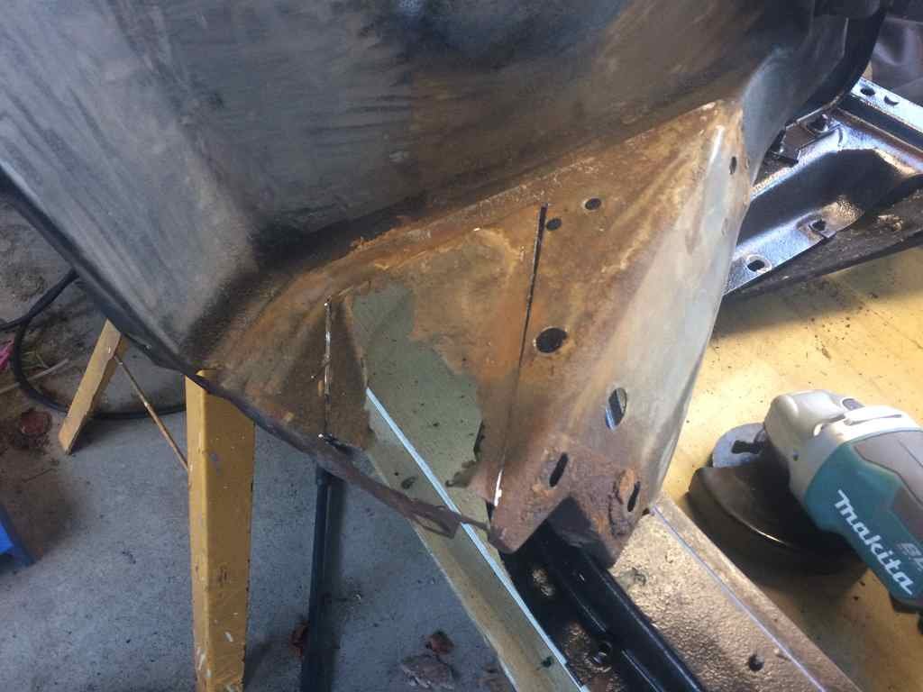

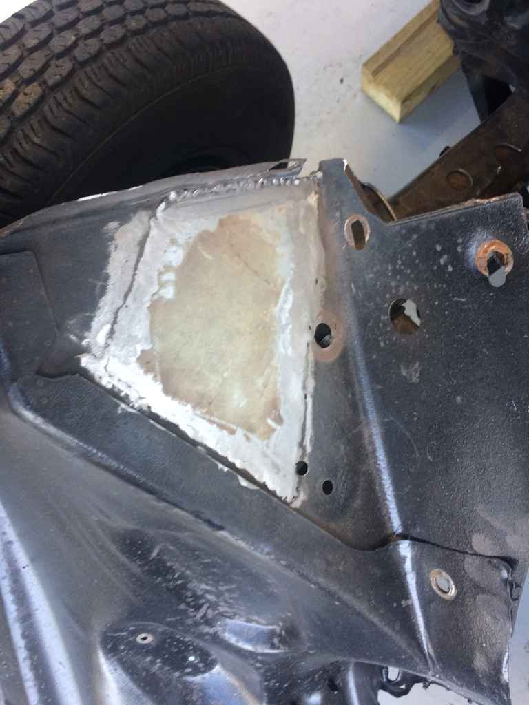

Popular Post piazzanoob Posted November 8, 2018 Author Popular Post Posted November 8, 2018 so progress is still happening with this still on the sanding job and many other things on the go while one of the wheel tubs was off i decided i would fix a rust hole that was there due to a battery in its past life leaking battery acid onto it and the battery tray at which i had already replaced. this hole never was an issue for compliance so either they didn't see it or weren't bothered. then patchy patch now more sanding can be done. I also acquired a factory 4 barrel manifold through @cletus so gave that a good waterblast along with my trans And while i was out asking a mate on some carb advice he gave me a holley 600 with vac secondary's as he had no use for it. then gave the combo a test fit on the motor. i have also been prepping the engine for a spray can rebuild also., 17 Quote

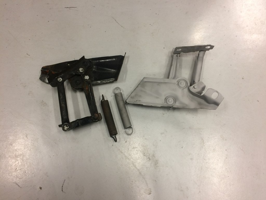

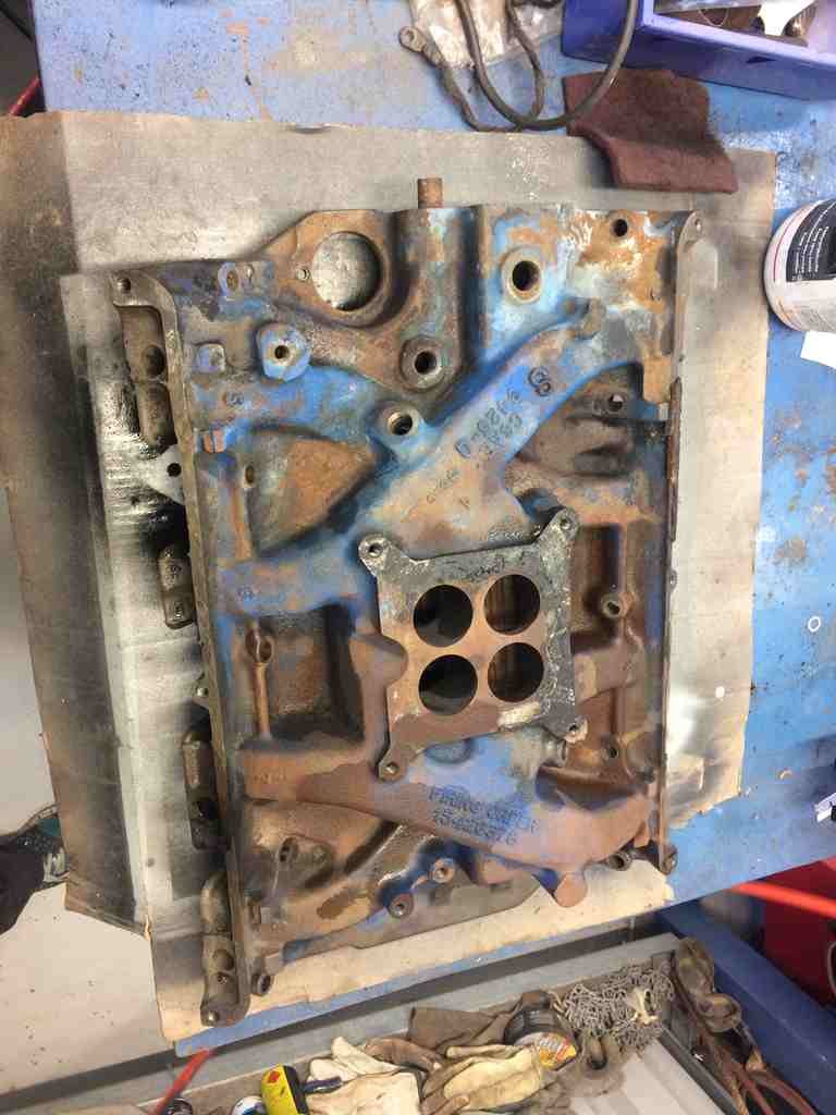

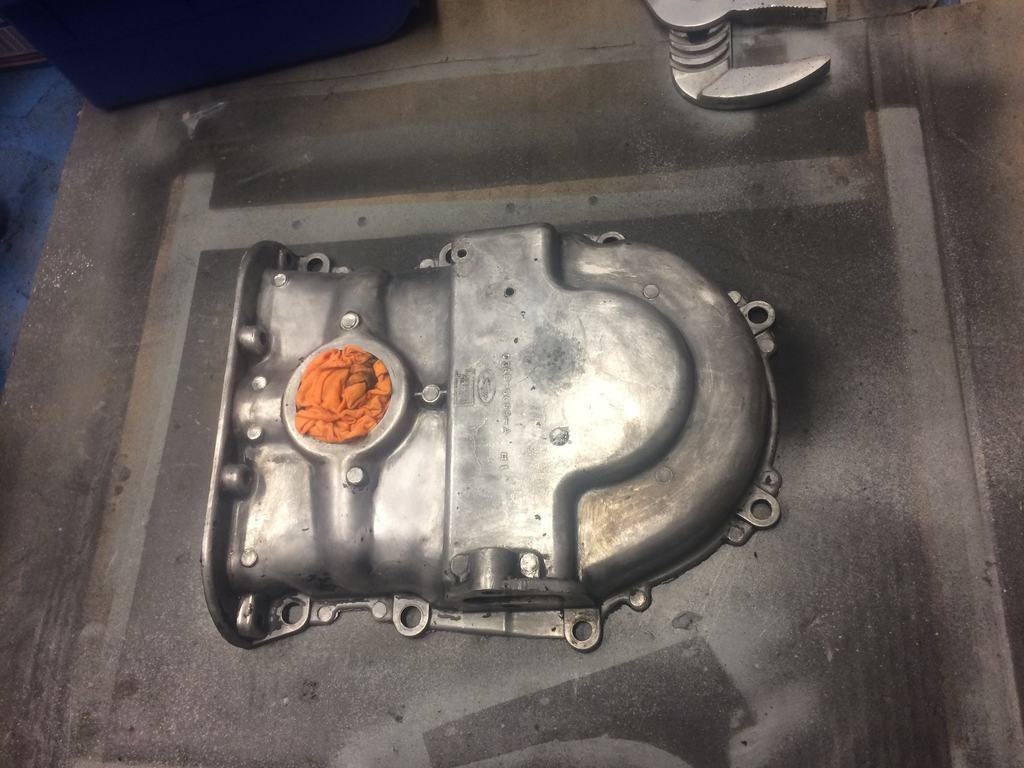

Popular Post piazzanoob Posted November 11, 2018 Author Popular Post Posted November 11, 2018 so some progress has been happening laid down some primer after plenty of sanding also spent more time prepping the motor for paint too and pulled the timing cover off sump and oil filter housing and prepped them ready for paint And cleaned up some bolts ready for paint too ' I then started sandblasting the bonnet hinges and springs ready for paint also cheers m8 16 Quote

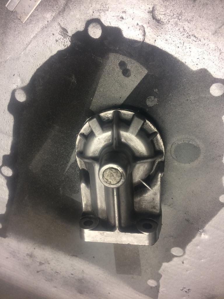

Popular Post piazzanoob Posted November 18, 2018 Author Popular Post Posted November 18, 2018 still progress is happening had a good look over the parts painted in primer and gave some bits a quick scuff then fired some gloss black on and painted the timing cover and oil filter housing And the same on the inlet manifold too also did the exhaust manifolds in high temp silver then gave the motor some loving Also when i stripped the motor i found this in the sump had to have a bit of a think to figure out where its from. but the sump also had plenty of rocks and dust collected in there too And the only reasoning why that was in the sump is that when the timing cover gasket was done in its past life that got put in along with rocks and dust as this part appears to be a small block chev rocker pivot ball for the valve train where as my motor factory run roller rockers so that part doesn't exist on my motor. so i also found a much easier way to do ford 2 piece rear main seals Remove all main caps but leave the conrod caps untouched then i used a gantry to slightly move the crank up which made sliding the bottom half of the seal around much easier. also placed some silicon where the two half's join as per seal manufacturers recommendation. and some on the top and bottom of the rear main cap side seals too. I then put a new oil pump on too seen as while im in there. then gave the motor a good wipe down and painted the motor. for this part i wanted the car to remain close to how it came from the factory and that has been pretty much for the whole car throughout the whole fix up process. plus that orange looked so shit so these fords of this era came out with black engines and either blue or gold rocker covers and air cleaner. cheers 10 Quote
