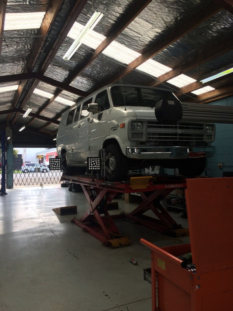

One of the jobs that needed to be completed for the engineer's sign off was a wheel alignment. Not that is any what related to the chassis repair but i guess is a standard on any repair.
seen as i work in a shop and have to do wheel alignments on a daily basis why not do it myself right.
well we don't have the spec's for any car of that era.
so i gave the guy at northwestern ford a call to see if he had any spec's to which he found some and sent them via email which was choice.
so spent way too long trying to convert the measurements over to millimeters from inches then into our alignment computer. only to make 3 different ones with different spec's on each one to making one for better drive ability.
then thinking some more and changing it again.
so then on one of my days off i took it in to do the alignment.
well it started off with not being able to put the rear sensors on the car due to the rear wheel arches. That's cool seen as there is no rear adjustment anyway.
then set the computer up for front alignment only... but ive only done one other car that way so had to figure all that out again.
then computer had a spaz and wouldn't do the full procedure so try again and again then decides to play ball.
so then get to do the alignment only to find its miles out and requires shim's in the front for both camber and caster.
so jack it up slightly to release the suspension load then loosen the nuts and remove and insert shims until within spec.
so that was about 2 hours work to finish that alignment. woohoo.

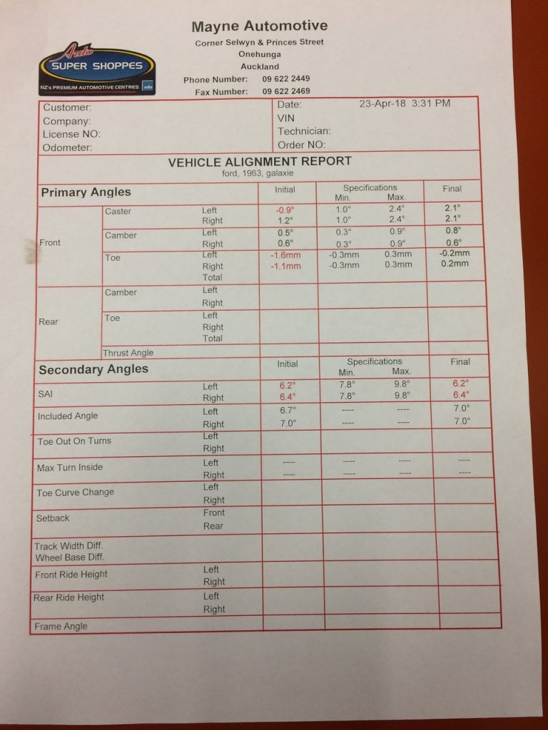

only to find the computer would not communicate with the printer. so just figured i would sort it the next day as it gets kept on the database.
so check on the database only to find that the spec part of the alignment is blank. great.
we had then got the IT guy in to check the printing issue only to find that it had a issue with the ip address being a wireless printer but all of this was caused by the Auckland storm causing the power cut.
so when the printer was working i figured i would just chuck the car on the alignment hoist run it through the procedure then not have to adjust anything due to doing it the week before. but nah off again and where i would have to shim it again...
so off it went and brought it back in to work another day to do it.
then edited the spec's again but really made a new lot of spec's altogether
then spent a few more hours getting it to the new spec
And then printed 2 copies of the new spec's and is still on the database which is good. And now noticeably drives and steers better than the last alignment.
but i also tried to correct the steering wheel location as it is far off from straight. but couldn't pull the wheel off even left some puller tension on it overnight with no luck so have put that in the too hard basket for now.
