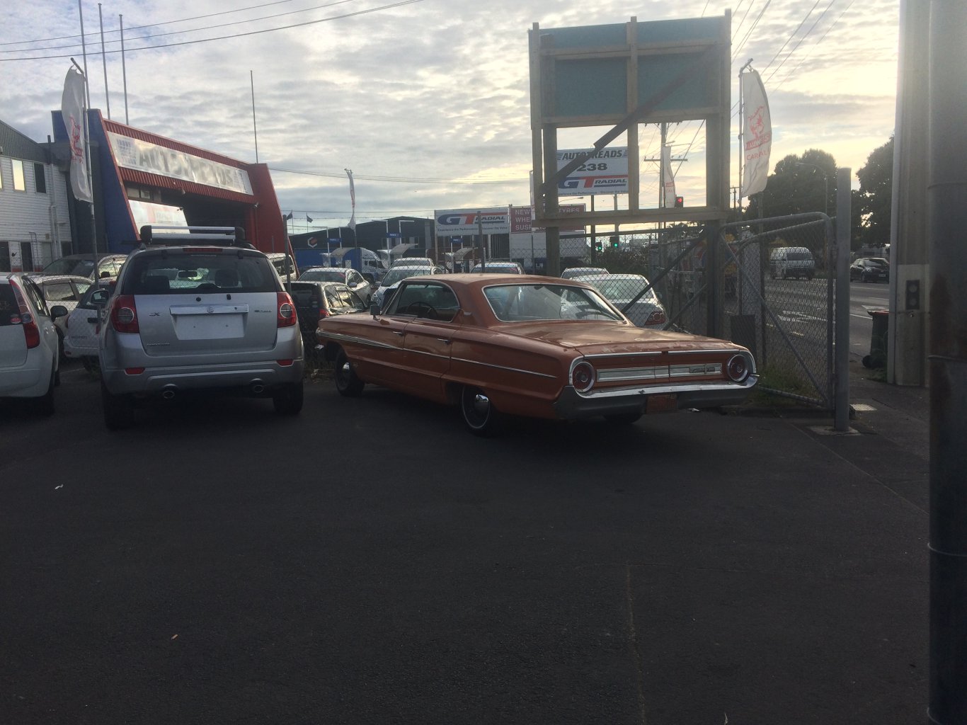

about 4 months later it arrived into nz and being cleared by maf and customs
Ready for collection
As i go over to collect it from its secure yard the person informs me the paperwork says its a non runner
what!?
soo it has a flat battery
well after swaping a charged battery into it it fires into life
meanwhile while i move my car out of their yard and the shipping company (Non reflective) employee moves the galaxie out of the storage lot he starts to crunch a few gears then almost hits the wall a few times trying to park it.
By then i was ready to throw him out of the car.
then he asks the question on how im going to take it away?
well im driving it mate
And too much surprise he replies in shock
it has no brakeees.
oh yeah algood mate guessing he just has no clue about cars.
so i hop in and brake pedal goes straight to the floor
this is going to be interesting
