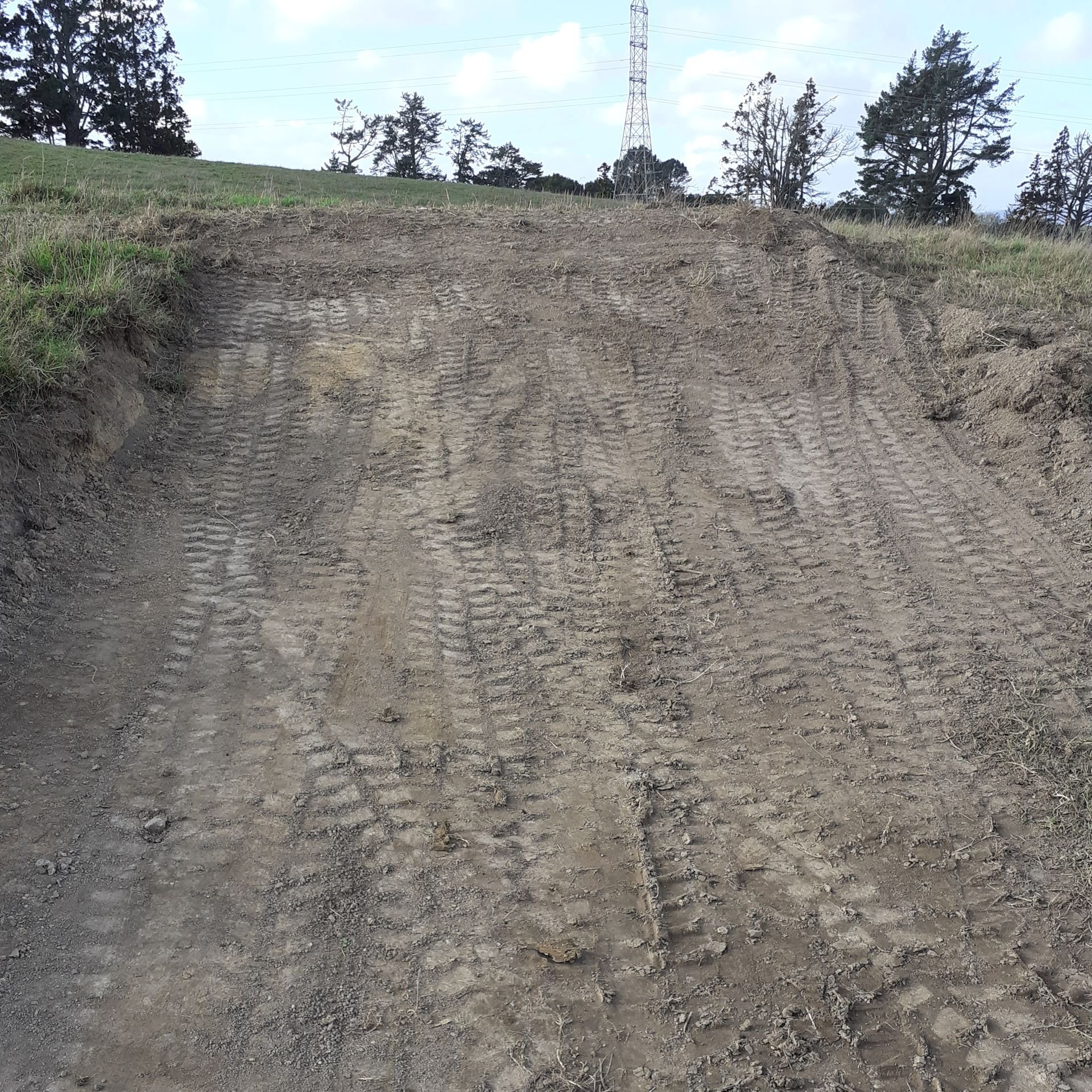

Made jump even bigger.      As usual got bit of nose dive issue, can possibly alter jump to make it better.   but being front heavy doesn't help.   Thinking may strap a wheel or 2 on the very back and maybe put some gas in it..  then it may fly a bit flatter.  after all the jumps  in the below vid,  still got 20mm left in the left hand front hydro bump and about double that on front right,  as tends to want to land on that corner for some reason.  if can get it to land flat and let the rear do some of the work, will be walk in the park  and should be able to hit it with some more speed
Jumps are fun, but kinda scary
Im gonna go for an early retirement on this one.   Strapped some wheels to the back.   smashed the throttle some more in the air.     helped a little, still nose diving.     tried in rwd, surprisingly not much different.      pretty close to being out of suspension travel.   super unkeen to fix bent truck.   Not saying no more jumps, just don't wanna push it any further
In saying that i think its done pretty, well for something that wasn't built to do jumps.
Now i have a big fuckoff jump in my back yard.   what to do with it..
Did I try going faster.     yep..    Hit it at about 55kph.   about 20m length.   or 65 foot because seems to be the universal jump measurement,  sound impressive.    got pretty high too
could prob jump the GC?
