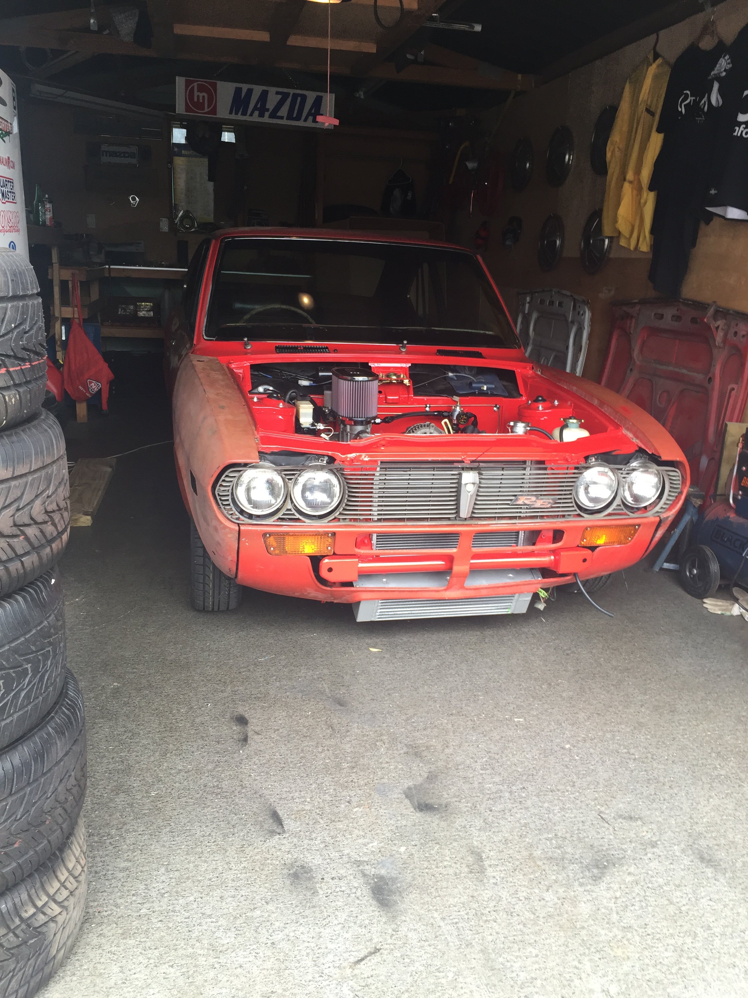

rivalrx Posted January 19, 2019 Author Posted January 19, 2019 Cert is booked in for early March. I will need the following before that: 1) wheel alignment 2) wiring 100% done 3) custom handbrake cables made live put the carpet in and let me tell you, I think I could do a better job than Autodec. Anyone looking to do new carpet in their car - make a template and get some upholstery outfit to overlock the edges. It will be loads cheaper and should fit well too. Front seats are in as are the seatbelts - unfortunately the VIN people need to see and sign all seatbelt mounts. Unfortunate because 2 of mine are under the hood lining hahaha. The rest are easily accessible and clearly you can see the mounting points. It’s still low AF so I will wind all 4 adjusties up another 1” and see where we end up. I repainted the RX2 Coupe steering wheel and that’s now in the car. I need to fit the rear oh Jesus handles and one sun visor and that’s the end of the tedious small stuff. Cheers 5 Quote

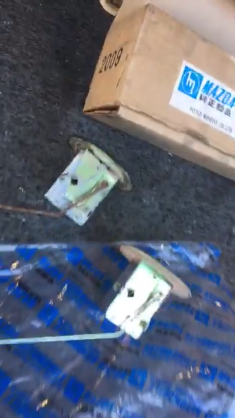

rivalrx Posted February 7, 2019 Author Posted February 7, 2019 I had some more wiring done the other night and now all the exterior lights are working as they should. The petrol sender was kaput but thankfully I had an actual NOS Mazda 616 unit I picked up in Europe a while back. I put it in yesterday and it’s all working like a charm. Bumper bar and grille are on now and are looking schmicko. I will keep my NOS RX2 s2 grille tucked away for when the car gets a panel and paint down the line (if ever). Sorry for rhe sht burger photo as I forgot to get a good one and then had to do the ol screen shot gig from an old Snapchat. Cert is now April. 3 Quote

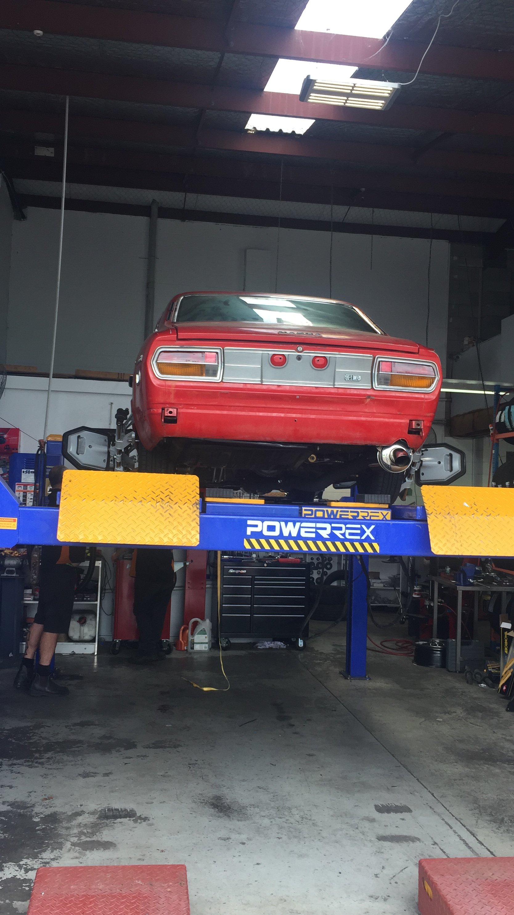

Popular Post rivalrx Posted March 18, 2019 Author Popular Post Posted March 18, 2019 Another step closer... I took the sled to Lincoln Tyre Centre on Saturday for a wheel alignment and genera spanner check. The top blokes there went over the cars bolts and set up my suspension all nice and even They performed an alignment too, along with the print out - this will be going to the repair certifier to prove that the car is all square and set up. Next steps - last bit of wiring. Compliance/VIN 3 or 4th of April and then cert on the 5th. Until then I’m buttoning it up and trying to iron out as many kinks as I can. Exciting times. 12 Quote
