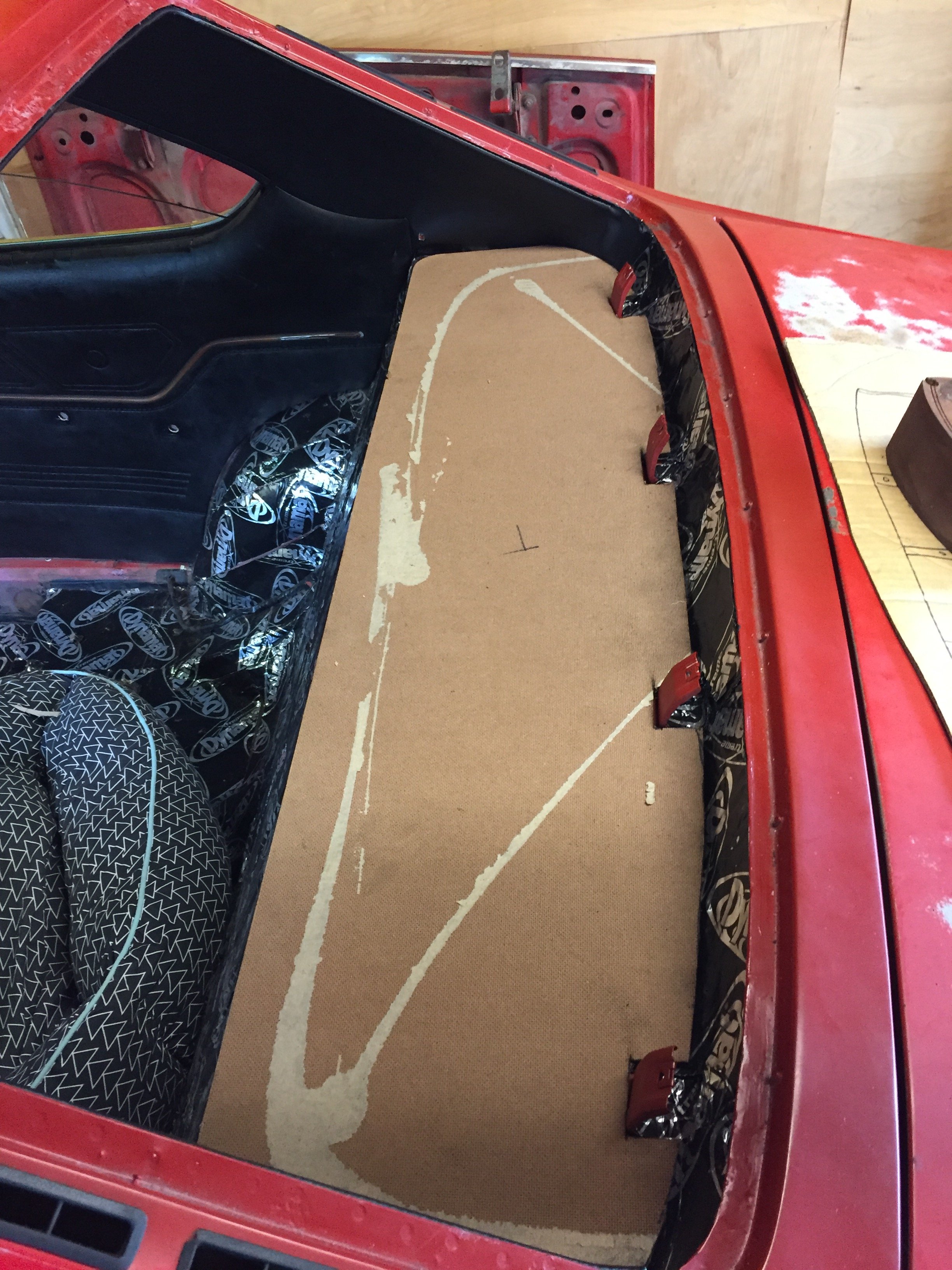

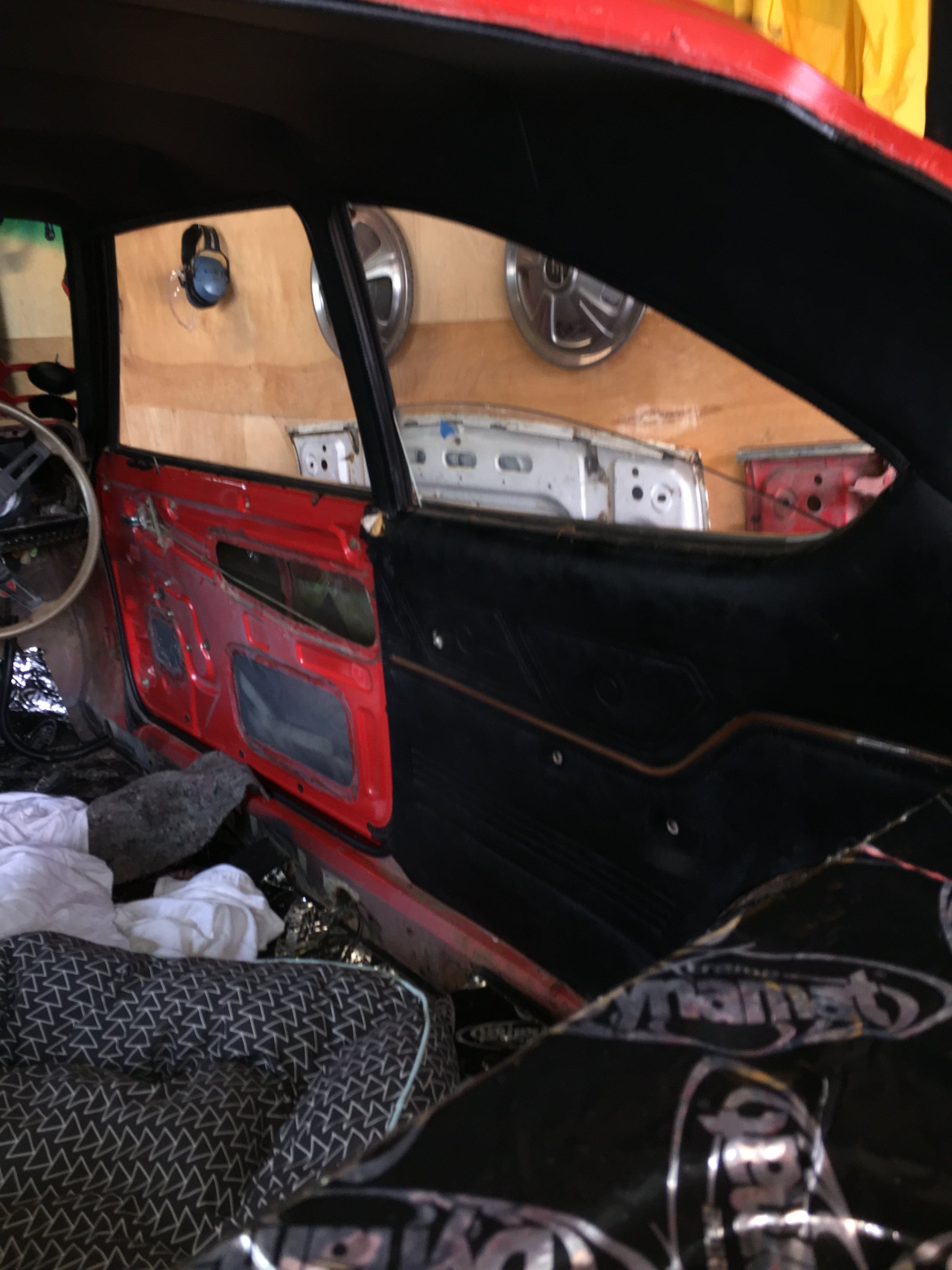

rivalrx Posted September 2, 2018 Author Posted September 2, 2018 So I cracked into the parcel tray today, as the original one was dust. Mitre 10 fibre board that comes on pallets was the ideal substrate. I used spare seat vinyl and it’s almost done. 3/4 door cards in place now 4 Quote
Popular Post rivalrx Posted September 2, 2018 Author Popular Post Posted September 2, 2018 I just need to tuck the leading edge of the tray flap behind the rear seat top. Overall, I’m happy with this as I generally suck working on cars so I am celebrating with a hein-grenade. Tuesday the new rear screen is getting put in the hood lining is 97% right, with only a couple bits needing an extra bit of tension Game on 11 Quote

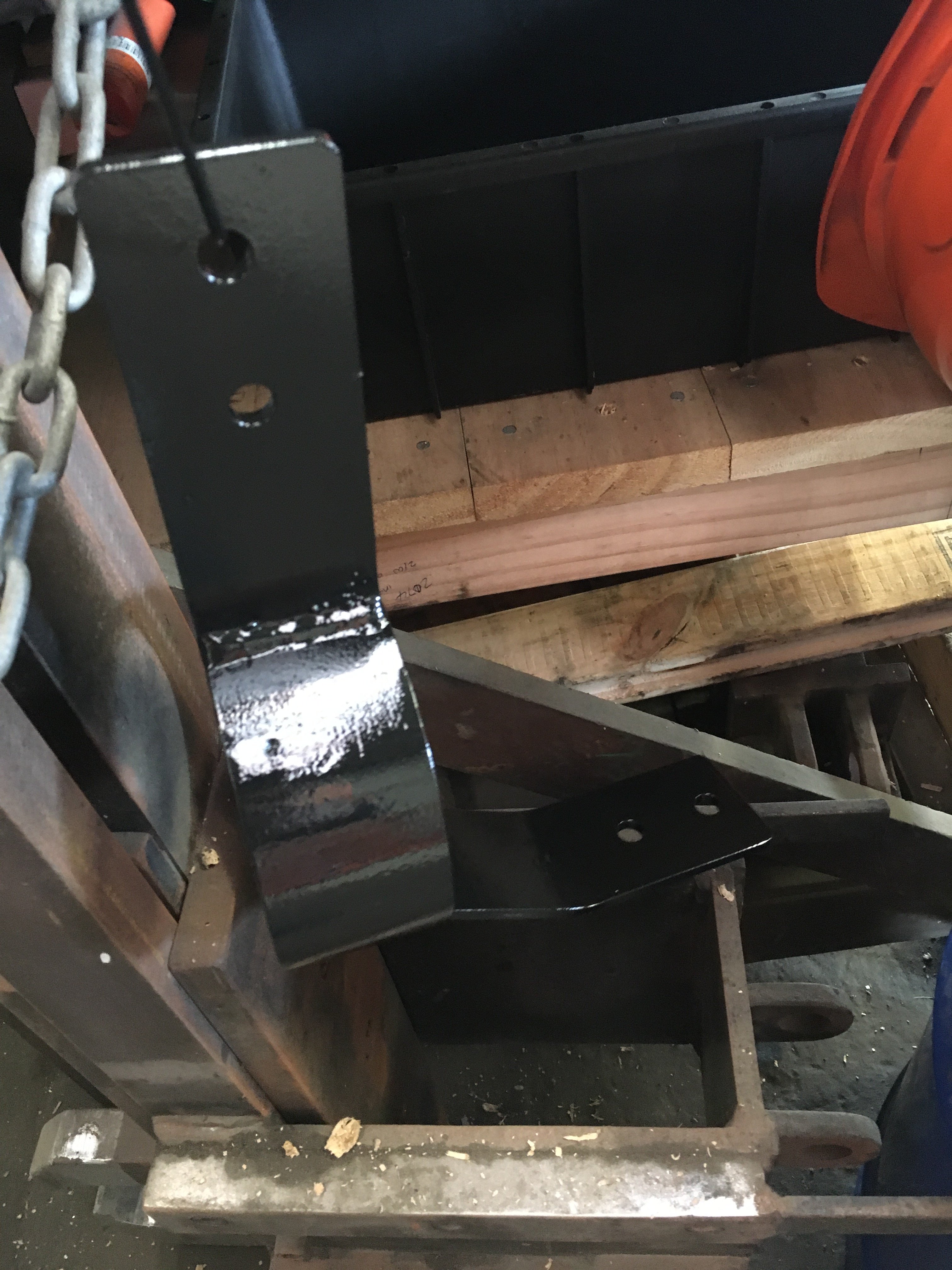

rivalrx Posted November 1, 2018 Author Posted November 1, 2018 The drive shaft loop is all done awaiting final placement. Making it was a bit tricky due to the uneven floor pan and fuel/brake lines - nevertheless it came up really nice and it’s certainly solid as a rock Once the drive shaft loop is in place exhaust can be bolted together and put in place once and for all. 2 Quote
rivalrx Posted November 10, 2018 Author Posted November 10, 2018 So the drive shaft loop is in with all the correct bolts etc. and.... the exhaust is all on and let me tell you, it sounds great. My wife even said that’s not too bad.... I take that as a win now or to spanner check and maybe a cheeky drive. 1 Quote
