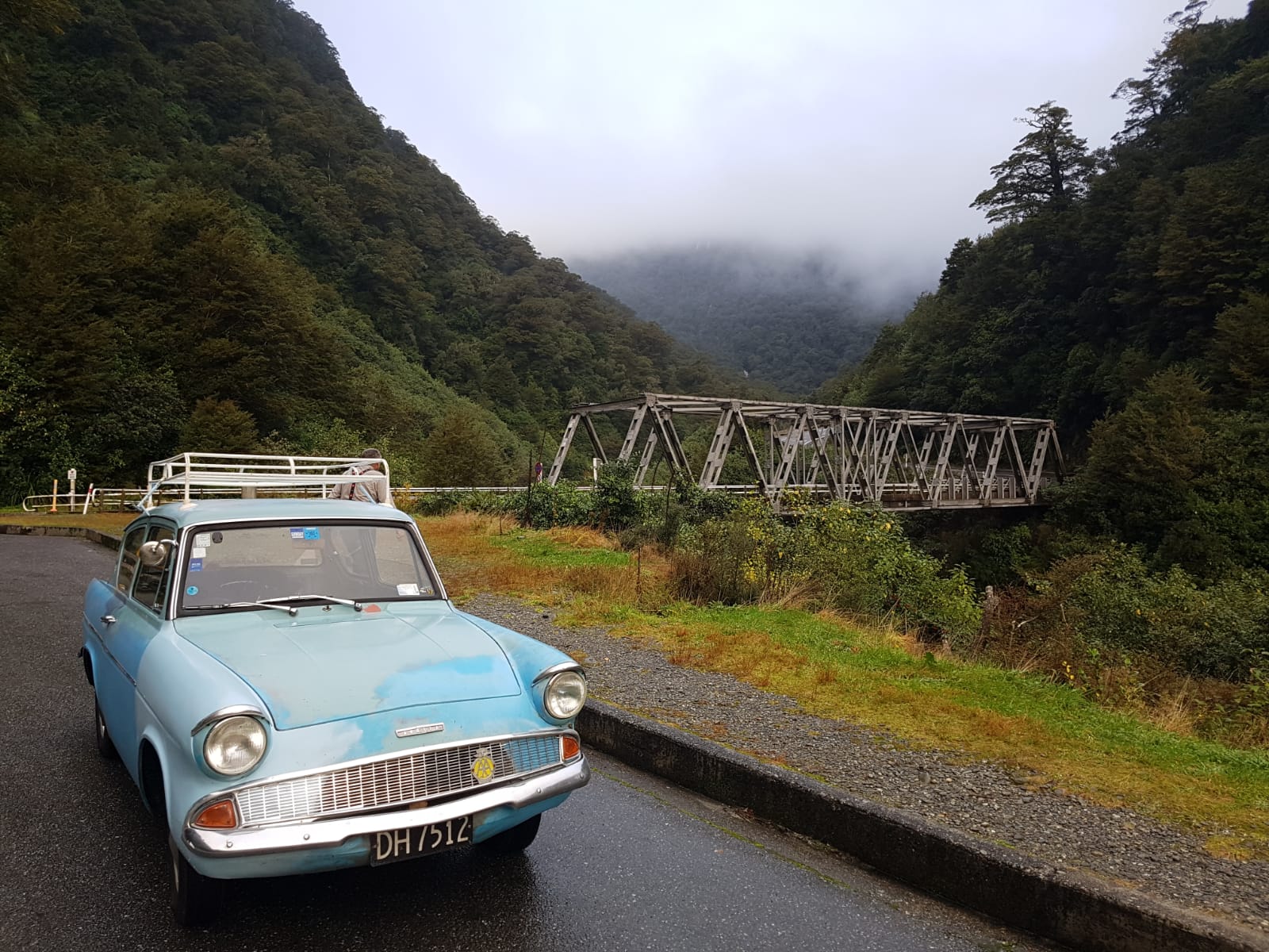

Popular Post ajg193 Posted May 1, 2021 Popular Post Posted May 1, 2021 They say the two happiest days of Birtish car ownership are the day you get the car and the day it leaves your life. Well the other day it left my life (at least for now). My dad is taking it on a long road trip. He is taking it to Auckland, via the bottom of the South Island. They're staying at Lake Hawea tonight. I think their trip will be complete by around about the 15th. Hitting the road: Somewhere in Mt Somers I believe: Lindis pass (actually surprised it still ran up there): He insisted on taking the roof rack with it. I bet it uses 25% more fuel now. When it gets up to Auckland my brother will paint it and we will try to track down the few remaining bits that it needs to be complete and then will stick it on the market. I'll keep this updated as the photos from the trip come through. Feel free to add any spotted photos if you see him on the road. 20 1 Quote
Popular Post ajg193 Posted May 2, 2021 Popular Post Posted May 2, 2021 They made it to Te Anau yesterday. No problems yet. Apparently people like it but are still calling them foolish for even trying 19 1 Quote
Popular Post ajg193 Posted May 10, 2021 Popular Post Posted May 10, 2021 They've begun their trip north now. I think they are in Hokitika tonight. My dad said it hasn't lost a drop of engine oil so far. I call BS. He reckons someone wanted to buy it from him in Wanaka but died when he stated his asking price 19 2 Quote
Popular Post ajg193 Posted May 14, 2021 Popular Post Posted May 14, 2021 They made it back to Auckland. They did 2000 miles and only had to put petrol in it. They didn't even have any tools with them. He once put a little oil in and then realized the car was sitting on a slope, so it now has a little too much in it. I believe there are a lot more pictures to come. 27 1 Quote
