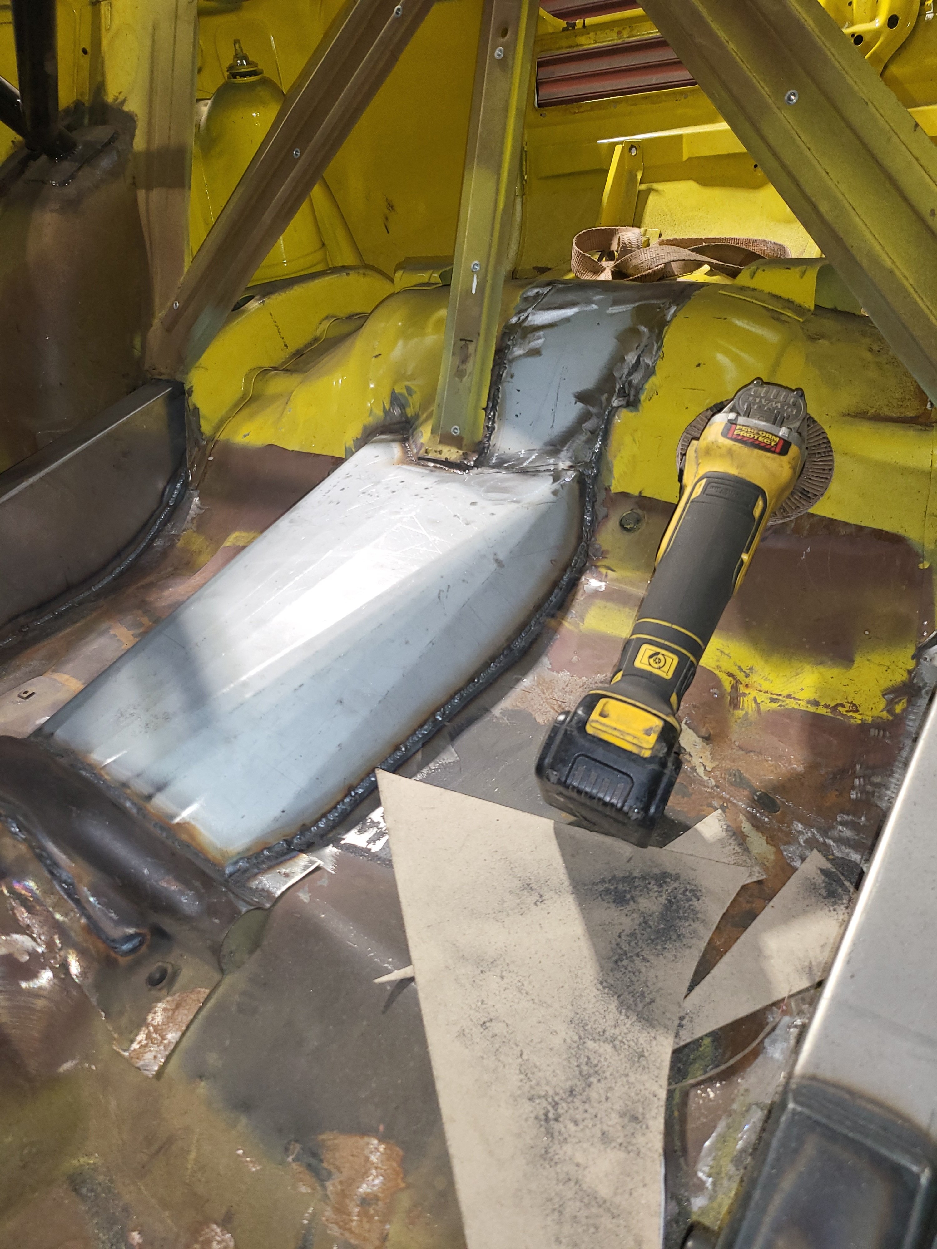

Popular Post zep Posted July 25, 2022 Author Popular Post Posted July 25, 2022 Almost done with the 4-linking. Tim has opened up the tunnel so nothing can hit at full bump, and closed up the channel that was cut for the old ladder bar. 27 Quote
