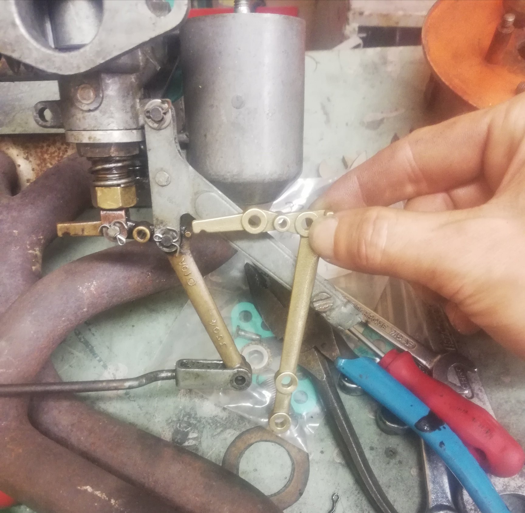

Popular Post tortron Posted January 4, 2019 Author Popular Post Posted January 4, 2019 Captivated my nuts Screwed all the brakes back together Attached the clutch linkage Pulled the manifolds and tightened everything up, put some gaskets in on the flanges. Ordered the wrong choke lever. Not a major as it's not necessary, but looks good. Let out my inner Barry Cheap fix eh I have some steel that would have done the job, but this is funnier and will give someone a lol wat moment years from now Anyway. I bolted it all together. Remembered how to prime an SU fuel pump, started it up, and tuned it enough for a slow idle when hot. A bunch of red liquid spat out of the water jacket gaskets, but this seems to have sealed itself. Exhaust downpipe flange needs to be at a slightly different angle for a gas tight fit. Seems to be really hot. The airfilter backing plates get almost too hot to touch after a few minutes idling with the bonnet up, distributor is also hot but expected (but not ideal as sidevalves kill electronic ignition due to the exhaust valves being directly under it). If anything it should be set up running rich, who knows what the timing is. TL:DR It starts and idles but I need to actually tune it, laptop died a while ago so need another for wideband tuning, but will fettle with SU tuning tools and vac gauges for now. I have a heatshield that came with the set up but is a pita to use as it blocks the manifold studs 12 Quote
tortron Posted January 5, 2019 Author Posted January 5, 2019 Did I mention the starter Bendix wasn't returning. Stripped it down, cleaned it up, and ran a builders pencil over the threads. Works ok now. More barrying of a carb choke actuator bolt into a throttle cable bolt. Just needed to spin it down in the lathe eh Looks the part Also popped the air filters on. These did come with wire mesh media in them. I replaced these with some doughnuts cut from a kwasaki ninja foam filter. Starts up with a little choke from cold, and starts easy warm. Revs up nicely. I think it's going to be a good one. Cut the exhaust up again to correct some alignment issues at the vband flange. Goes together much nicer now and sounds alot smoother (waste of time tuning with exhaust leaks) Then something went wrong. Smoke started coming out of the generator, ign lamp would go off when running but come on with the key removed. Looks like the points in the voltage regulator/control box (yup more Lucas points) stuck I ran some paper between them and it's ok again. I had to do that last time it had sat for a while too. An entire new loom in in my future, maybe I'll get a dynameter fake generator instead and do away with the control box all together. Anyway Next on the list is the brakes One wheel was stuck. Just some rust on the shoes, I cleaned it up and will vacuum bleed the system later 6 Quote
