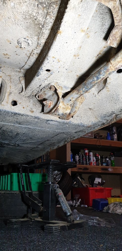

Did some measurements today which are hopefully accurate. Rear diff is 1400mm wide, front suspension hub to hub is about 1400mm wide too and wheel base is 2450mm long. Was abit hard by myself to be accurate. Google searched what a nissan s13 is which resulted 1465mm front and rear width and 2475mm wheel base. Reason behind comparison is s13 is a popular drift chassis due to wheel base. Also I'm contemplating using an r31 skyline rear end (1465mm wide) and s13 front crossmember, suspension etc for better options of coilover and brakes and proven steering modifications to achieve more lock. Jacked it up on axle stands and found some interesting rust, someone had bogged and undersealed the chassis rails which has resulted in them being very rusty..... Removed the rear springs and tried on my heart wheels for some inspiration also
