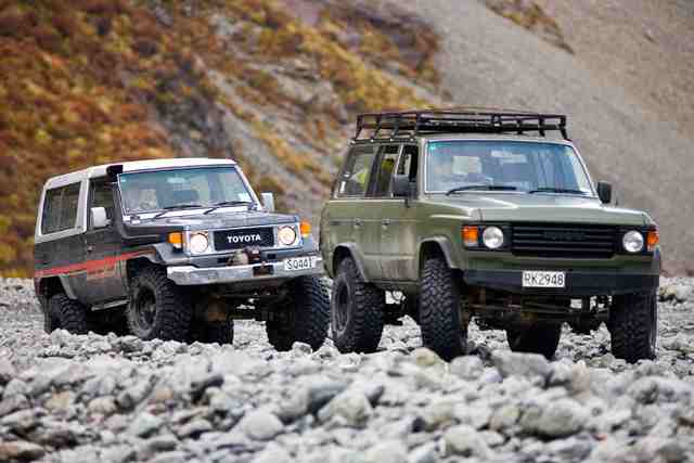

  7. My old 60 series (green truck in pic above) had longer shackles, was scary to drive at first with constant micro steering adjustment to counter the wandering steering but once I shimmed the diff to rotate the axle back to normal (ie fix the castor), it drove mint. I also had a 2" body lift, I reckon its a good way to lift actually as you're not lifting the center of gravity as much as lifting the entire chassis like you are with springs. You don't get the articulation benefits but getting the biggest tyres you can with the smallest change in centre of gravity is the win, as clearance under the diff counts for more than chassis clearance in my book
