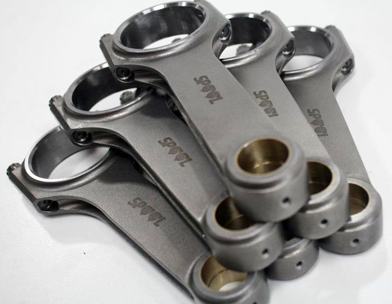

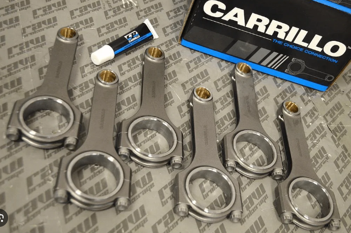

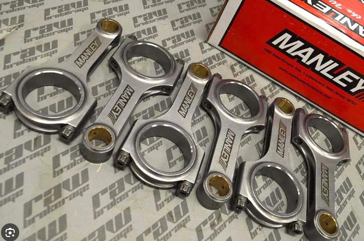

  13. FWIW spool informally quoted around 4k AUD for carillo rods (for 6), their regular stock for RBs is between 3 and 4k NZD +tax on spools website anyway
  14. yeah, not exhausted all options there but been through a bit and still looking
  15. chur, @Roman mentioned your long rods were from max, how would you say quality compared to any other name brand of aftermarket rod?
  16. Anyone got experience on who to contact/the process/costs involved of getting made to order (one off spec) conrods? I've started firing off some emails to carillo, spool. Spool came back and said they can order via carillo so will see about cutting out a middle man unless need their buying power
