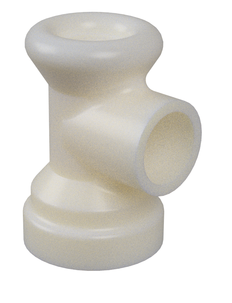

I havent really driven the car anymore, because I've had a clusterfuck of small inter-related issues which are causing things to not be fun. So firstly the bank to bank imbalance was a pain - So I went back to setting up double e-throttle. After a bunch of hours, and admittedly was very close to having it running good. I decided it was quite un-fun to try make my own ethrottle controller, so I am using a borrowed G4+ Xtreme just as a 2nd throttle controller. Ha. It's not doing anything except for actuating the throttle, and receiving throttle position target over canbus. So once this was all going. I tried adjusting each bank individually to try get lambda to match bank to bank. Still sucks, even when the motor is at steady state. Still got some other issues somehow. So I pulled the fuel rails off and printed a test rig to double check injector data. Yep it was all good, no issues. Sooooo what else could it be? Maybe individual throttle balancing. Ages ago I tried to print a little throttle balancer thingy, but my printer was acting up. But went back up the priority list. It's a little tube that I can plonk on top of each throttle, and it'll give me an airflow reading through a MAF that I've stuffed in there. Like so: This worked GREAT! My previous guesses with the screwdriver were massively wrong. On one bank, all 3 throttles were being fed air by only 1, back through the balance tubes. The other 2 throttles werent flowing any air at all through the throttle plate. It only took about 10 minutes to get everything balanced up, and now it's all matching a lot better, and idle is now really nice. I've just printed a version 2.0 that has a smaller internal pipe size so it pushes the voltage readings a bit further up the scale, so its a bit more sensitive. It works well enough as is, but not making much use of the range available. I will also add a capacitor to the output so it smooths the signal a bit. My ethrottle pedal that was from the Echo, has a weird pivot point height and pedal height when fitted to Carina. So it's quite awkward. But it's working at least. However I think I will try adapt the sensor onto the normal pedal instead. Hopefully now it'll start feeling like the car responds and acts a bit better when trying to dial in the fuel. Edit: some paddock tuning
