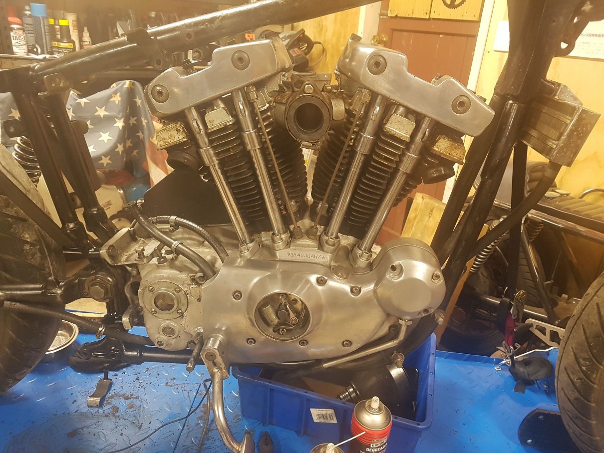

So yeah, kinda stopped taking pictures of things like wiring and the like. But fully rewired the bike. And installed an aftermarket regulator rectifier on the back of the oldschool generator. Also managed to get it running. What a cunt. Jesus, i've kicked over a few bikes in my time. But nothing as cunty as this. It can't be cos of the compression ratio, as these are like 8.5:1 or something. My japanese 4 cylinders kick over easy as. So must be the ratio or something. I'm not a small unit, and i can jump on the pedal only to bounce off due to it being on compression stroke. Mental. I gave the tank a quick satin black to get it complied. I have a full AMF sticker set in brown and orange to decorate the tank. So once its complied, i'll gloss the tank and pop the stickers on. Here is as it currently stands. I'm trying to get it complied in the next few weeks. Just chasing some paperwork misery. So will see how it goes. Once its complied, i don't know whether to cut it up straight away. Or enjoy it as is. Likely the latter, as riding it around the hood was a blast. Not only did i feel like a crim, it was actually really pleasant to ride. Will update my compliance process in detail as it unfolds.

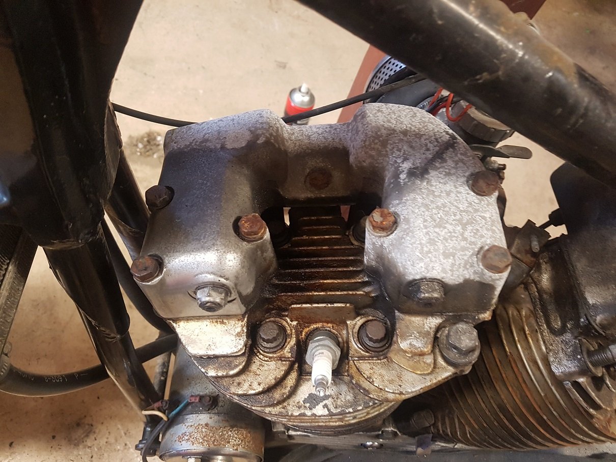

So the only description was that it was a non runner, suit parts. Gearbox broken. Cool, exactly what I was after! an expensive unknown on the opposite end of the island. Perfect. So first step was to try and figure out what was wrong with the gearbox It was stuck in gear and the clutch wouldn't disengage fully. Real easy to maneuver around. So whipped the chain off.: It was a shit to get the clutch out. But made some tools to help. The oil looked disgusting. But there was no broken metal (yet) so hadn't grenaded, good? i suppose?
