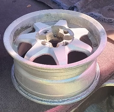

Sadly those wheels I found were just not meant to be. When I went back to get a tyre fitted I double checked the other rims on the balancing machine and discovered that two were bent- one really badly to a point I'd not want to attempt to rescue. So that sucks. Back to the search then. In other news @Sanfiddy came round and helped us take Mollys skeleton to the grave. Once there at the dump Hannah and I stripped off the doors which will be heading to @Willdat? and the hatch as a spare for when the a ford ranger (insert other penis enlarging device) backs to into our tiny car at the supermarket because he cant see beyond the girth of his massive machine. We also grabbed the front struts, rear springs and steering rack. The front springs from this G#/autostrada model I have discovered have a higher rate. The steering rack might possibly be geared higher - it showed 100mm less travel at the rim lock to lock. Even if it isn't actually quicker, and I can't yet find any definitive proof on internets that there is a quicker rack on some but for rumours that the UK super S / JDM G# might be so equipped. Anyway- its still good to keep a spare. We were both a little sad to see Molly sitting there, soon to be turned into a Nissan Cube. She was actually a solid as little car, a rare model at that, with which only half a day of work would have made roadworthy. But can't turn back time and the goal was always a 2 door yellow PFL which is now even better equipped than we first dreamed. Mollys heart and other organs live on in Minky and Milly anyway- 213 replies

Popped to the wreckers today to look through their alternators for the flat six project and found some round treasures.. 15 x 7 ET37 Italian made Momos. Trial fitting. I think they'll work With 195/50 they are 3mm bigger than the 175/70s that roll nicely and the speedo is spot on with.- 213 replies
