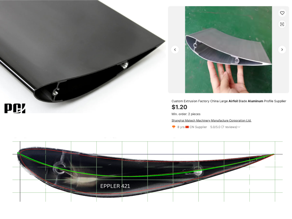

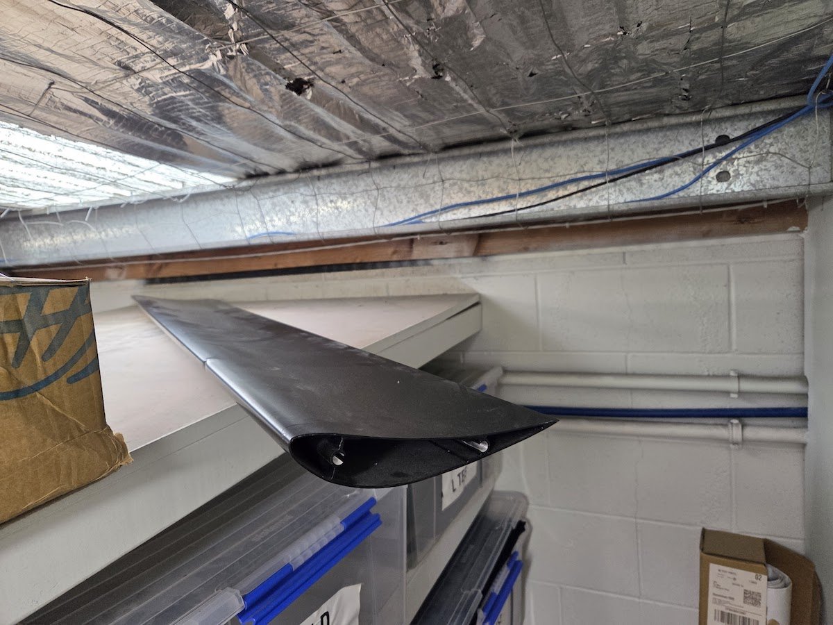

Info dump from the rabbit hole I went down last night. The extruded wing blade I have is an older PCI race wing - this was their original style and is was advertised as a low drag wing and was mainly used for FWD cars. The cord is 220mm and I had no idea what the profile was, until last night when I found a note about it on an old website that said the profile is an Eppler 421. Airfoiltools has a huge list of profiles: http://airfoiltools.com/airfoil/details?airfoil=e421-il I plotted it against a photo of my wing (which has some parallax error, so doesn't perfectly trace it, but you can see it's close). It was a common profile for old can-am cars and seems like it gets used for some fixed wing drones and helicopter blades too.... Which means the extrusion is available on Alibaba if anyone wants to go into business selling wings 😉 Current plan of attack is to build the wing stays and test with this wing, then add a gurney flap to see how much effect it has... And then possibly add a 3D printed second element later if I want lots of downforce (this profile is a common base for dual element wings). The other rabbit hole (vortex?) I fell into was 3D printed wings and the range of techniques people are using to create strong wings. This is too interesting not to try at some stage.... It's such a cool way to experiment with different wing profiles. Most people make them from 3D printed sections with aluminium tubes that slide through the length and aluminium sections at the mounting surface to get a strong mount: And some people are having success with carbon skinning and vac-bagging the wing afterwards using as little as 5% infill on the prints to keep it light. Some people have said their finished wings are as light as 2.5kg, others add more material and it gets as high as 7kg (still not terrible). The results look pretty impressive tbh, so I'm keen to give it a try. Ok, back to the grind.

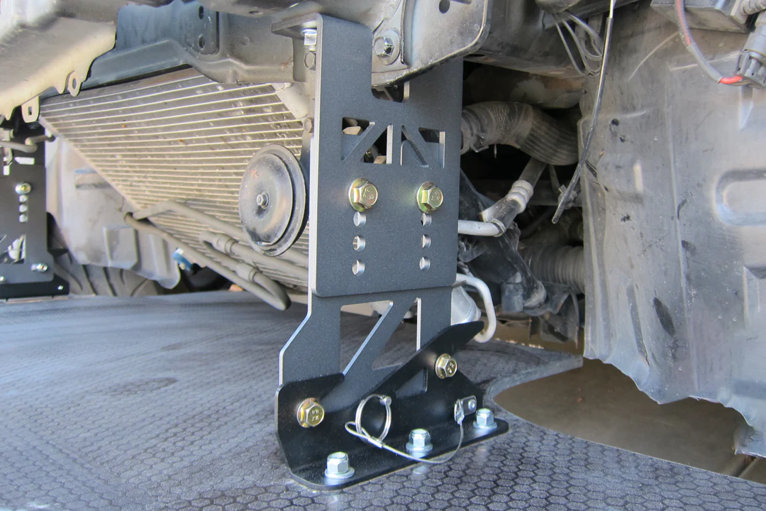

Nice, that looks easy to make and easy to fit. My undertray will extend back to the crossmember with a slot to fit around the sump pan, so I'm planning a couple of pins similar to yours for the rear, then laser cut something like this for quick and easy installs, with a couple of pins that will be accessible from under the bonnet: -

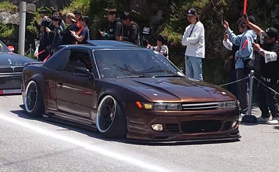

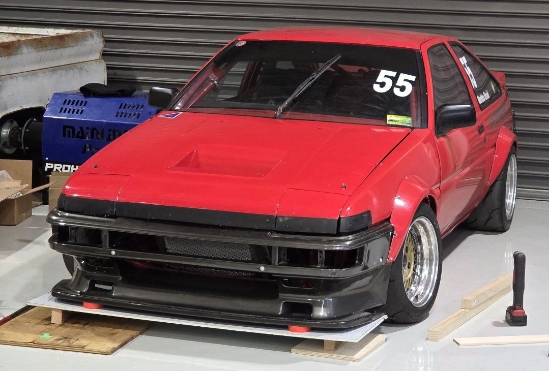

I mucked around with the front bumper mounts today. I'm thinking I'll leave the front bumper as Uras intended this time.... because it drives onto my trailer as is and my ideas for modifying it were getting too complicated. My last bumper took weeks of nights after work and I know if the juice will be worth the squeeze a second time around... The new plan is something more like this 👆. An easily removable splitter that mounts independently of the bumper. Here's a hotboy S13 that kinda illustrates what I'm thinking: I have an experimental idea for making the splitter/undertray too. Two sheets of 10mm foam core ACM stacked together (it's super light and rigid) with aluminium angle sandwiched between the layers for mounting and then wrap the whole lot in Carbon for extra strength and wank factor. Aaaand now I'm thinking about aero, so it's time to revisit the rear wing idea 😁 The idea is growing on me...

Found a front bumper in Auckland, so the next game is relaying it to the South Island over the next little while. It's a genuine Uras kit and is slightly cut up already, so will be a perfect base for me to modify without feeling guilty. The corners have been chopped to fit N2 flares. I think this time I'll try to make the bumper 2 pieces, with a separate lip thats easily removable for loading on a trailer etc. It'll also allow me to mount the main bumper more solid since it won't need to be removed every time the car goes on the trailer. Here's an old picture with the front lip split off the bumper. I'll come up with a plan to make the lip lap over the bumper and might make the lip section from carbon fibre... we'll see 🤷

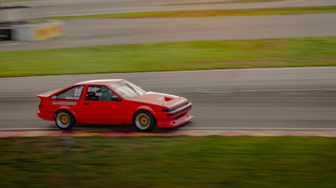

Over the weekend I competed in my first actual race meeting in the South Island at Highlands Park with the SS Cup Class. It feels like this has been a long time coming and I was pretty fizzed to have a run at the "A&C" format of the track that has its first turn straight after the start finish line. The car was looking pretty good! Until I had small a moment in qualifying and went lawn mowing... Unfortunately my front bumper tucked as I landed on the grass and got dragged under the car. This is all that's left of it now 😅 Oh well! nothing lasts forever, especially not Fibreglass. Here's some photos from before the excursion: I threw some tape around it to secure the flares and went back to it. I'd qualified 10th on the grid (second in my class) and it looked like there would be lots of good cars to battle with. The racing was definitely good all day long! We had 4 x 8 lap races of different formats (qualifying order, reverse grid with staggered start, reverse finishing order, another reverse with staggered start). I ended up finishing 10th, 7th, 9th and 2nd in the 4 races and was 2nd in class all day behind Josh from Crowesport in his WRX. Here's a vid from the last race of the day:
