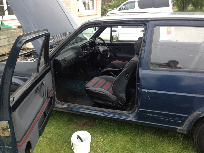

  22. IT'S VINNING TIME!!!!! I Bolted in a basic interior consisting of door panels, seats and dash. No need for anything fancy. The original gauge cluster had Chernyobled a few components resulting in nothing working so the diesel parts one was sub in. the kms have jumped up 100,000 (no I can't be assed pulling it to bits and winding it back) but everything works and I gained a clock. Plus it has a redundant glow plug light which might make people confused.The diesel parta also donated various nuts and bolts, a straight front bumper and rear seat mounts.
