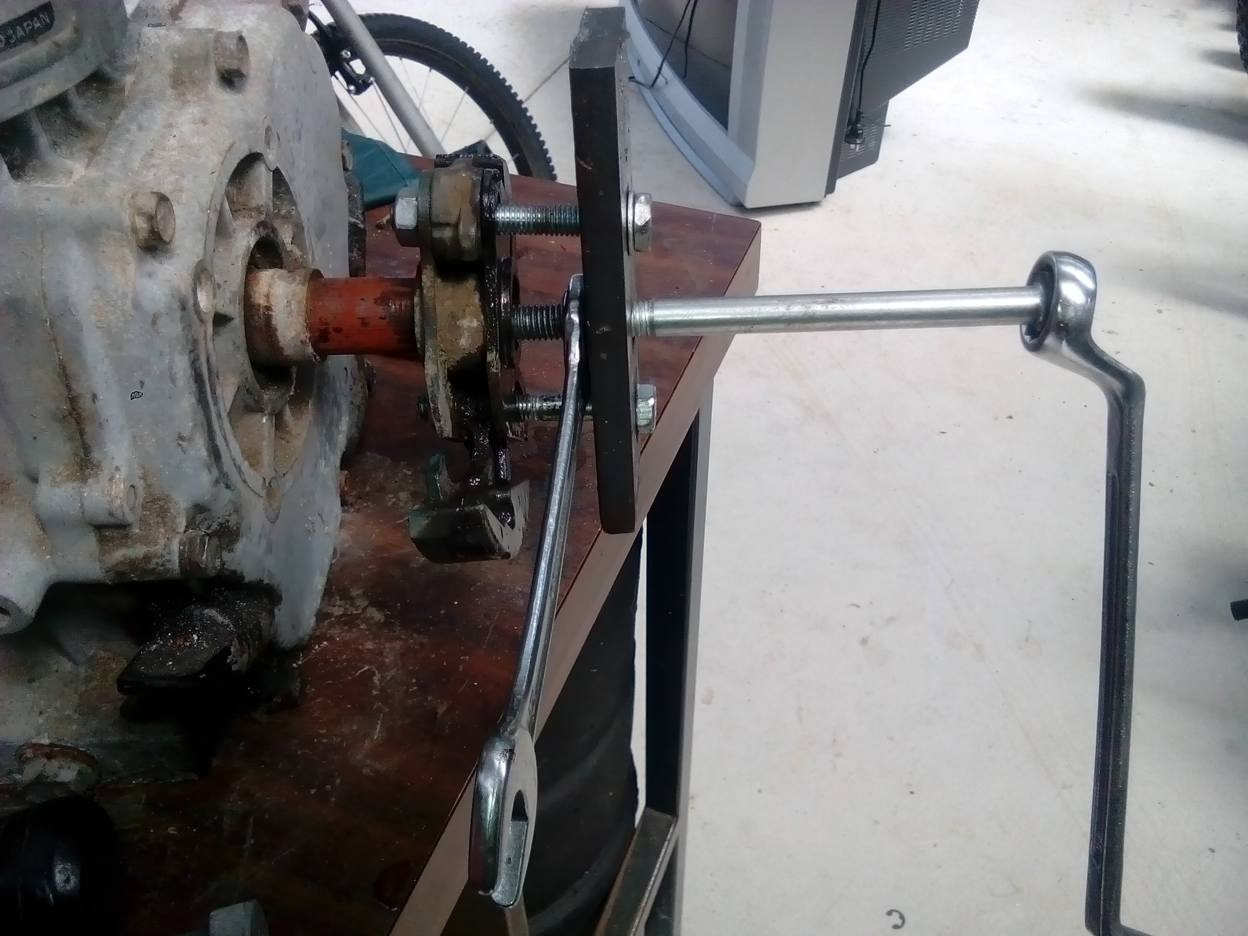

There was the remains of an old clutch still attached to the motors crankshaft. Holy Moly!!! What a mission removing this became. I ended up making this "tool" in order to the job done: It worked, but it didn't exactly lie down and take it. Bloody knuckles and lots of swearing...then pop! Got there in the end.
