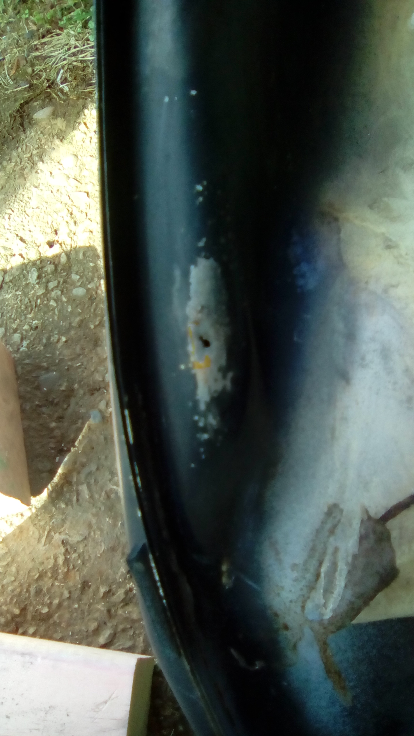

Finally had a crack at welding up the rust holes. This one got away on me a bit. Really need some lighter shades in my welding helmet for this kind of stuff but got there in the end. Took a bit of head scratching to work out how to get all the little bits of rust and crap out of the tank. There's a big indent and lip around the fill point so I couldn't just tip it out. So I rummaged through the rag bag and found a shirt sleeve, carefully sewed up one end with a stapler, chucked a magnet in the sleeve and dropped it in the tank (making sure to hold the other end of the sleeve). Now just shake shake shake, all the bits stick to the magnet then pull it out. Did this a few times and now the tank doesn't rattle anymore. The tank had quite a bit of rust dust in it by this stage so I stuffed an oily rag in there and gave it another good shake, seems to have done the job.

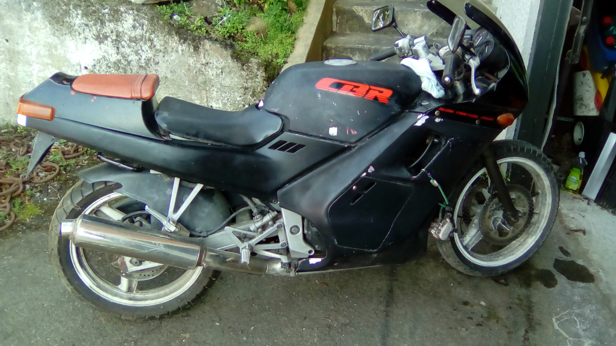

I can probably count the number of hours on my hands that I've ridden a 2 wheeler. I learnt to ride a mates ct90 when I was about 9 or 10, and have had a bit of a play in a paddock on a cr125 in the late 90's. I've always liked the idea of having a bike but never done anything about it. Until recently. I did a deal with a mate, I made him an oil burning device and he gave me a weapon to try kill myself. We are both very happy So it's a 1988 mc17 Honda cbr250. It's been sitting in a shed for around 8 years, it was jump started about 4 years ago where it broke the throttle cable. Has collected dust since. I'll continue soon. Pic of this stunning example. And when I picked it up last week.
