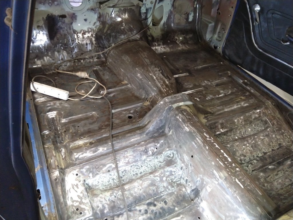

  10. Mostly strip disc on the grinder. Used a wire brush attachment for the grinder and drill to get some of the bits round the seams. Manual sanding with 80 grit for the rest. No worries mate, I'll probably have heaps of questions when it comes to reassembling it!
  11. Mostly to bare metal. Didn't get any pics of it just before paint unfortunately, here is about 90% stripped.
