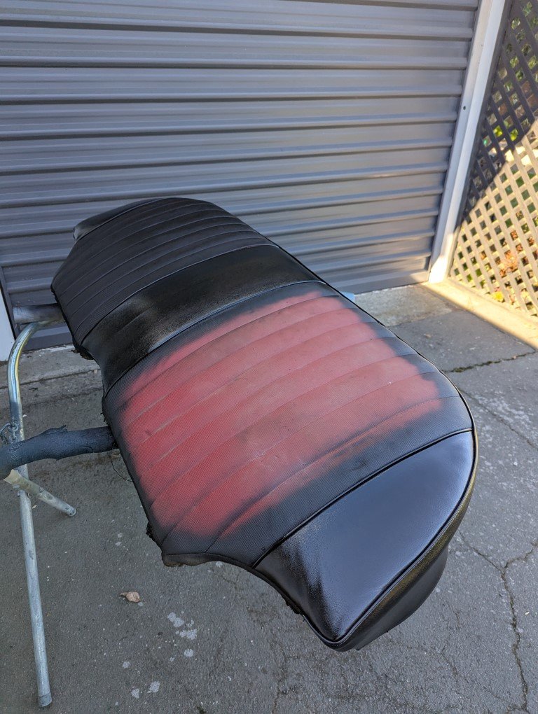

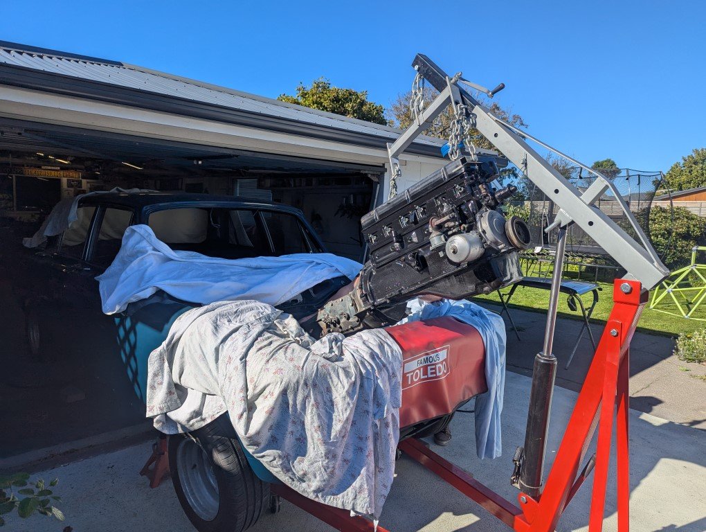

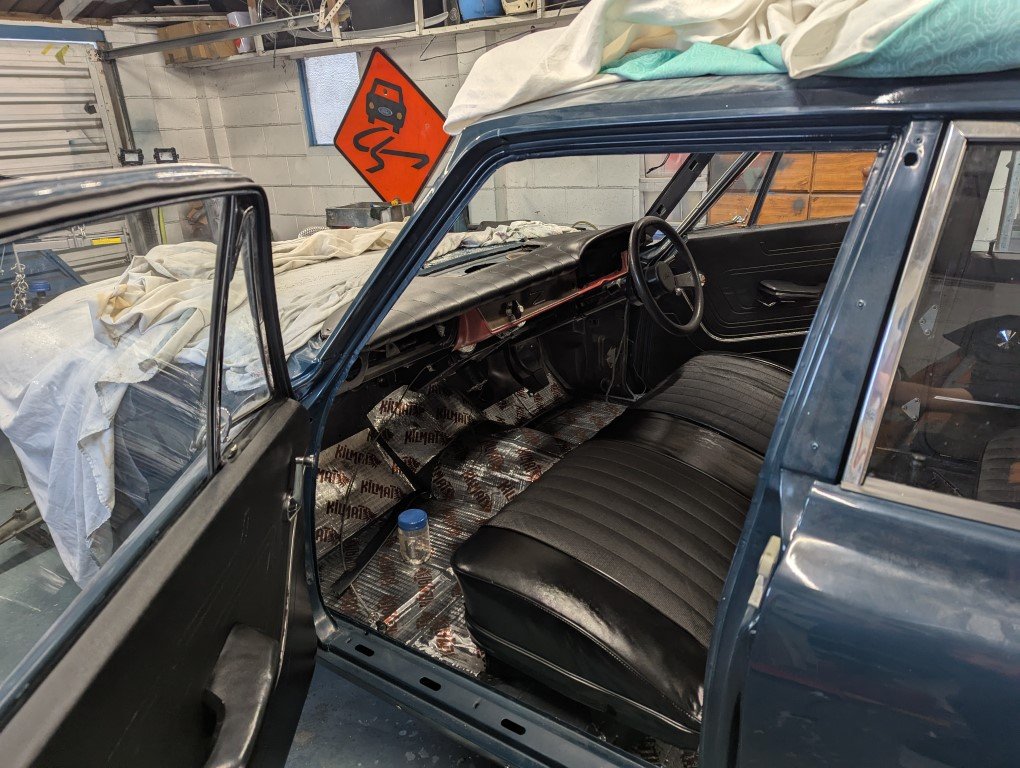

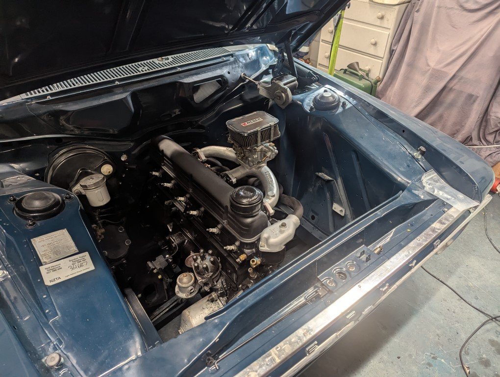

I've been re-assembling. Got the tail lights and quite a bit of the chrome trim installed. I used some vinyl paint on the seats. The seats have come up pretty well, a couple of rips but should be able to fix with some tape and a seat cover until I get them reupholstered. My engine was supposedly rebuilt to factory specs not long ago. No receipts, but it looks clean inside and turns over with good compression. Should be fine to get it running, re-vinned and I can build up another motor with a cam and higher compression. Bit of a mission to install with the gearbox on, but smashed it out with a couple of mates. Would probably do it with the gearbox off next time I think. The next big step is going to be to suss out the hood lining so I can get the front/rear screens in
