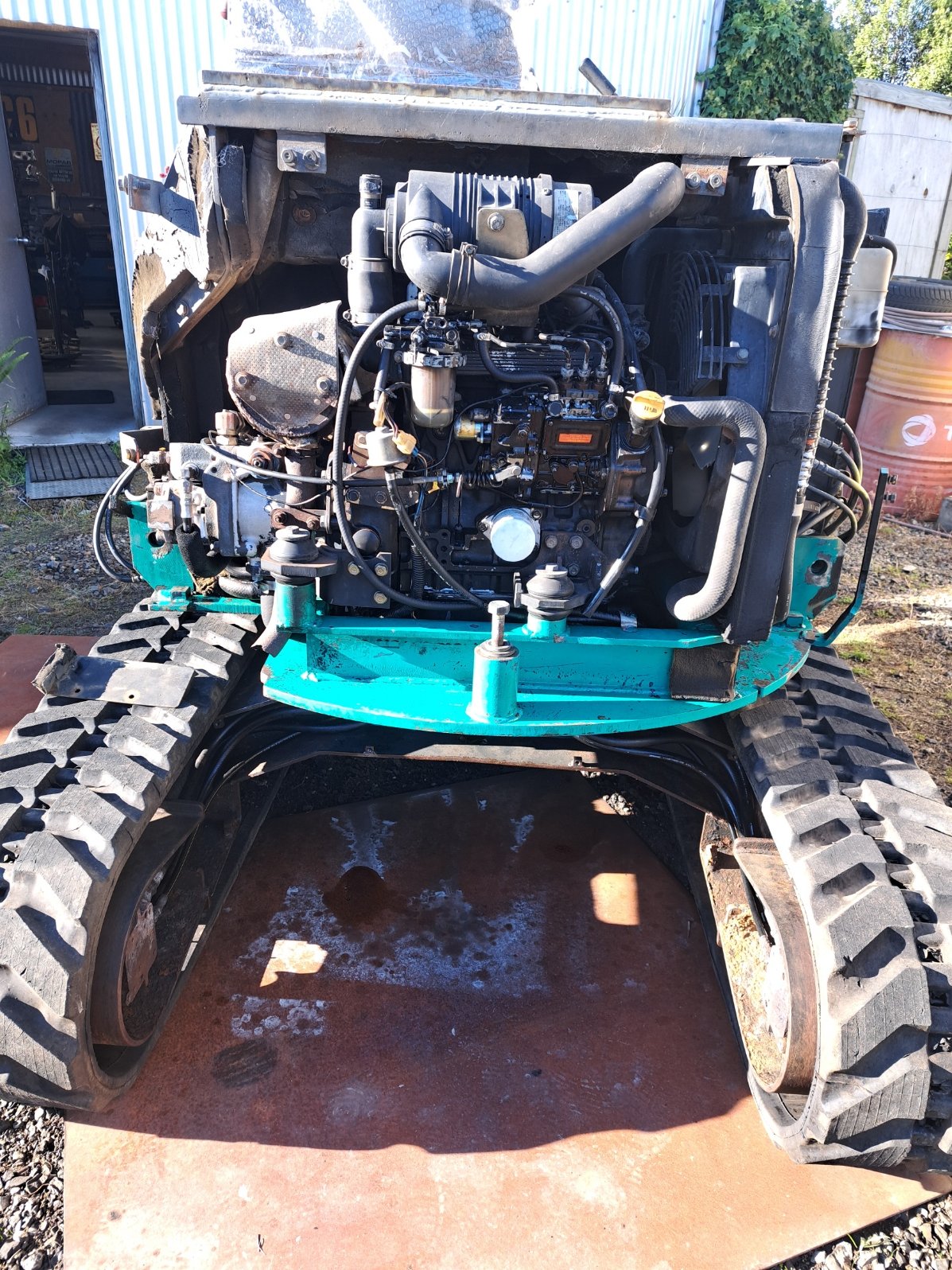

Right! More progress. I got the counterweights removed. Heavy fuckers. There were two of them weighing a total of just over 600kg. This is the 400kg one sitting on my cross country little arsed trolley I made for carrying heavy stuff across my metaled driveway. Handy as fuck. Made from Honda (or Nissan - can't remember) rear beam axles. One day I intend to own a tractor but until then this will have to do me.
Clean as! Used engine degreaser followed by prolonged steam cleaning. Made a mess of my driveway but in a spot that gets used for nothing. Also thought ahead and placed a piece of scrap sheet down underneath to zero in on the leaks. So far i have identified 5 major leak spots and am setting about identifying in detail what needs tightening, replacing and or something else doing.

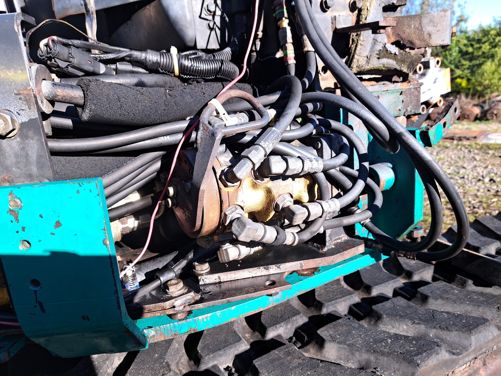

This nek pic is a source of one of them. This yellow thing with all the hoses going into it. Does anyone know what it's called? The hoses are all from the hand control joy sticks. I have not got a manual and the online schematics I can find confuse the hell outta me. Anyone know the name of it? So I can further discuss with a local workshop what the best course of action might be. It's leaking around the end join between the end cap and the barrel of the body. This leak is one of my major ones that drip directly onto the rubber tracks then down onto the undercarriage which shits me.20250321_173705.thumb.jpg.1b54538482a0bda74fbbc476ccb02520.jpg
