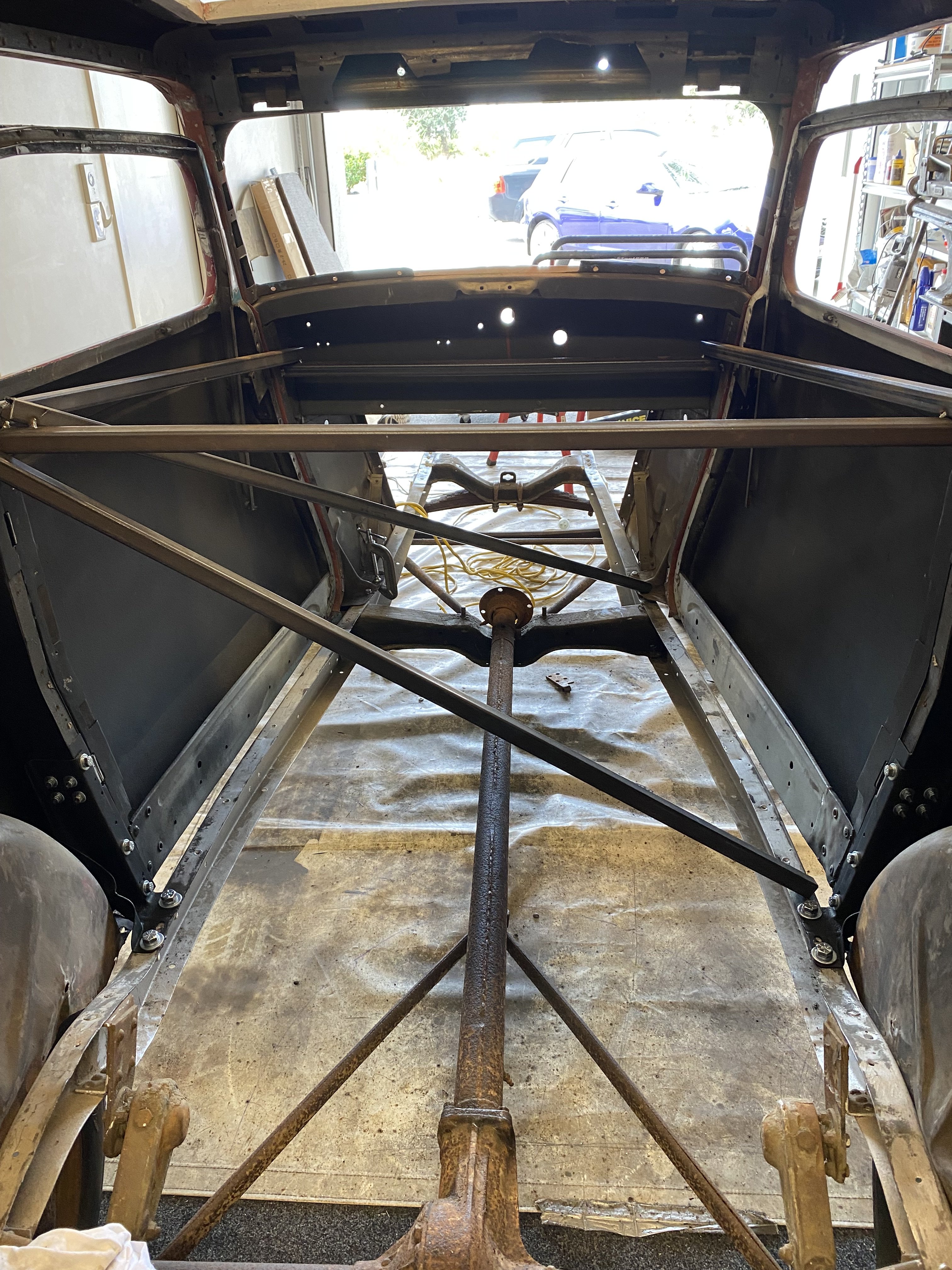

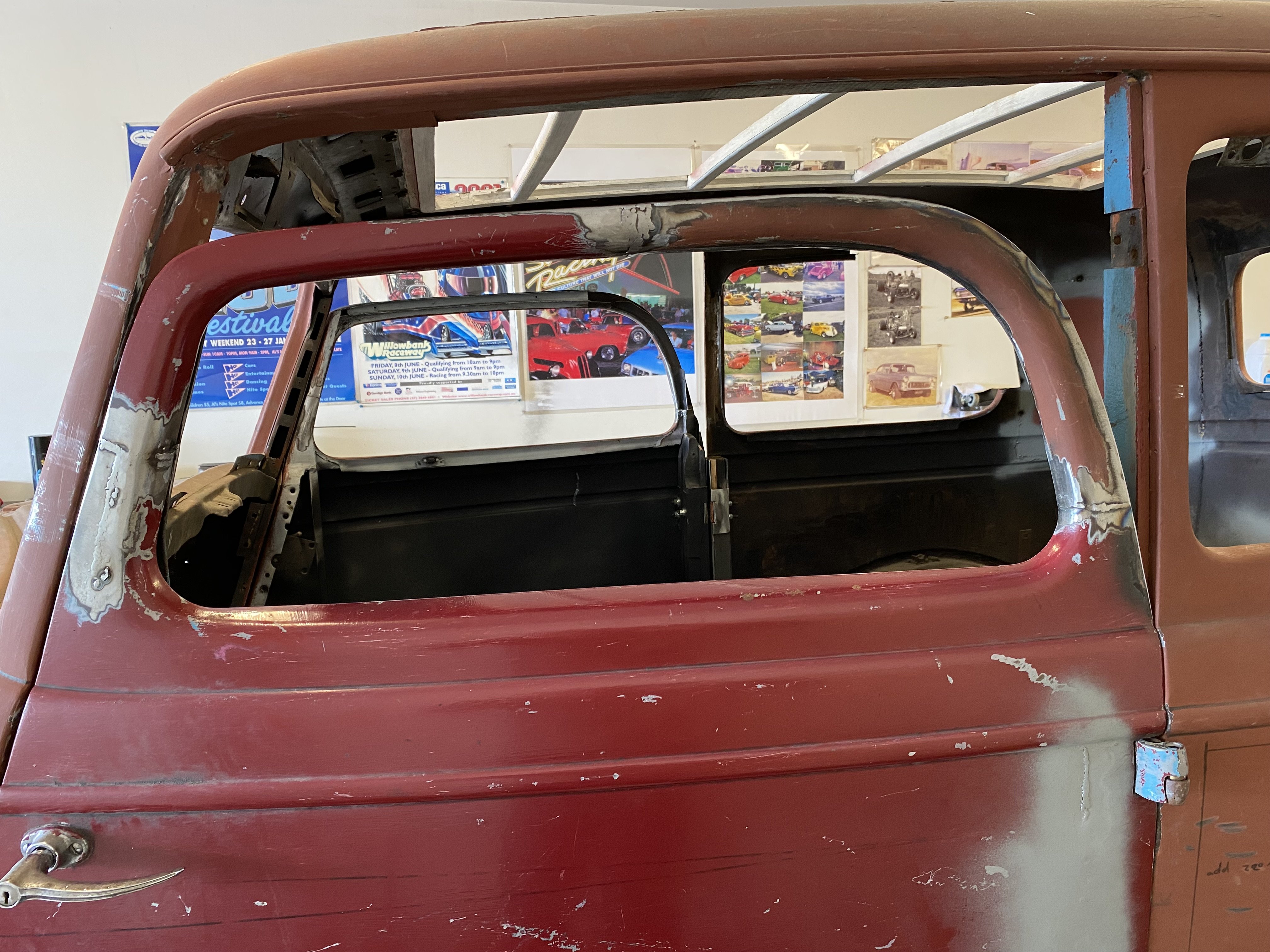

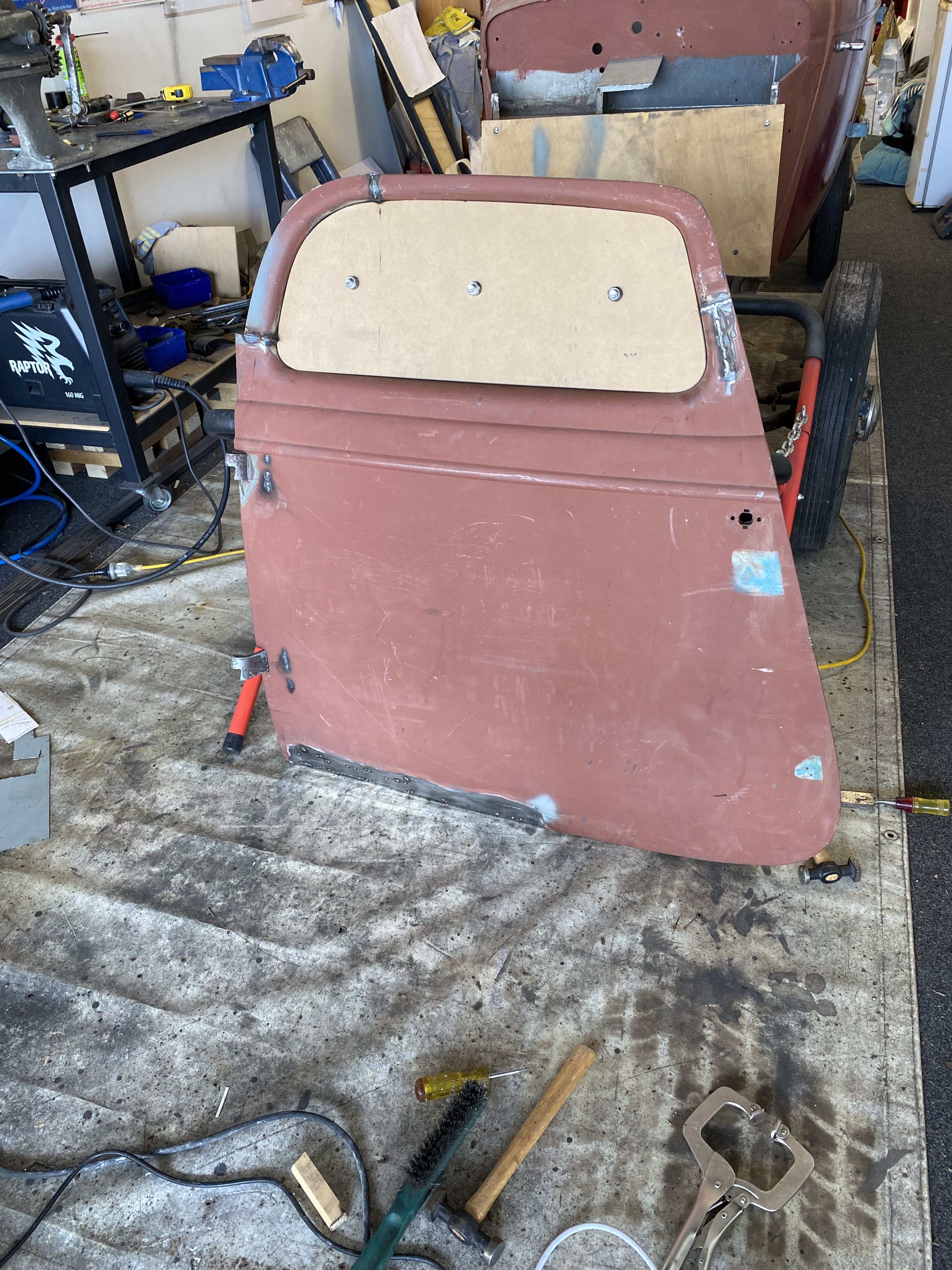

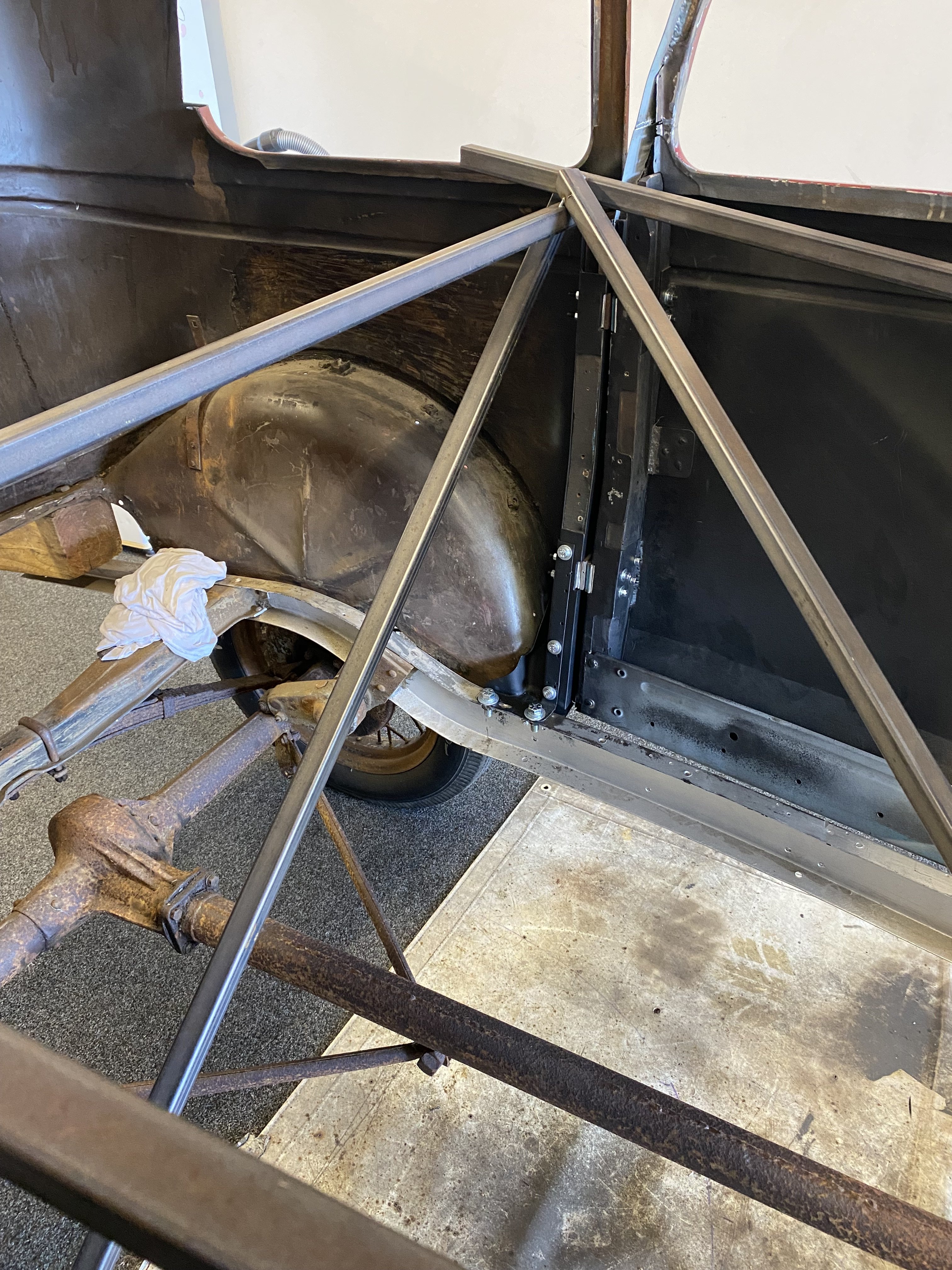

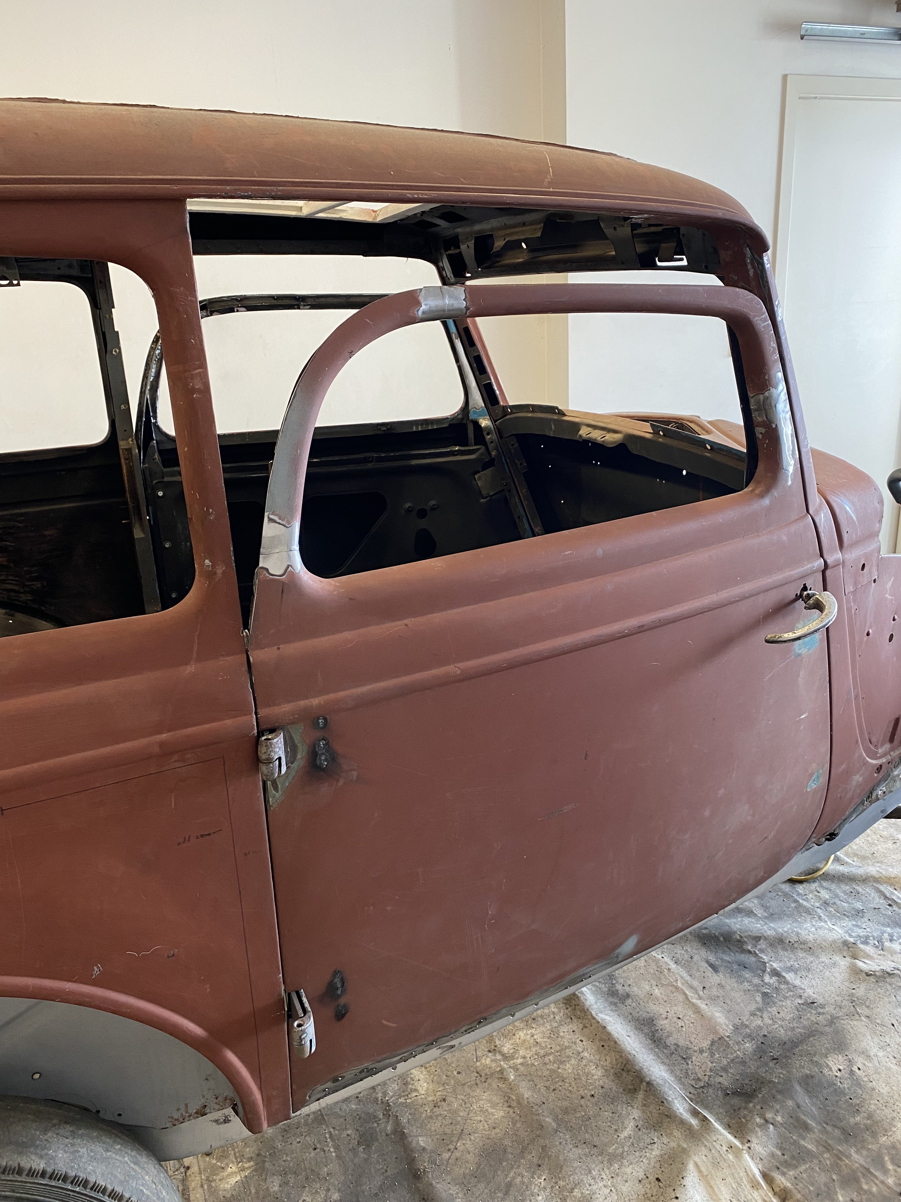

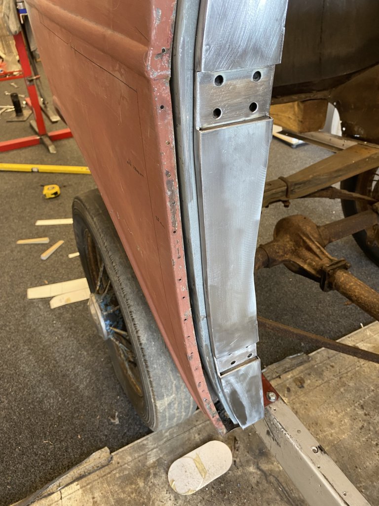

Finally got both B pillars finished and finished a bit more on the doors.
Have braced it up and gapped the b pillar door hinges.
these old Ys had very tight gaps in some parts and even touched with little to no way of adjusting them.
i can at least move the cowl around to get better gaps in the front as I’m not bringing the whole roof down at once.
  • Like 5

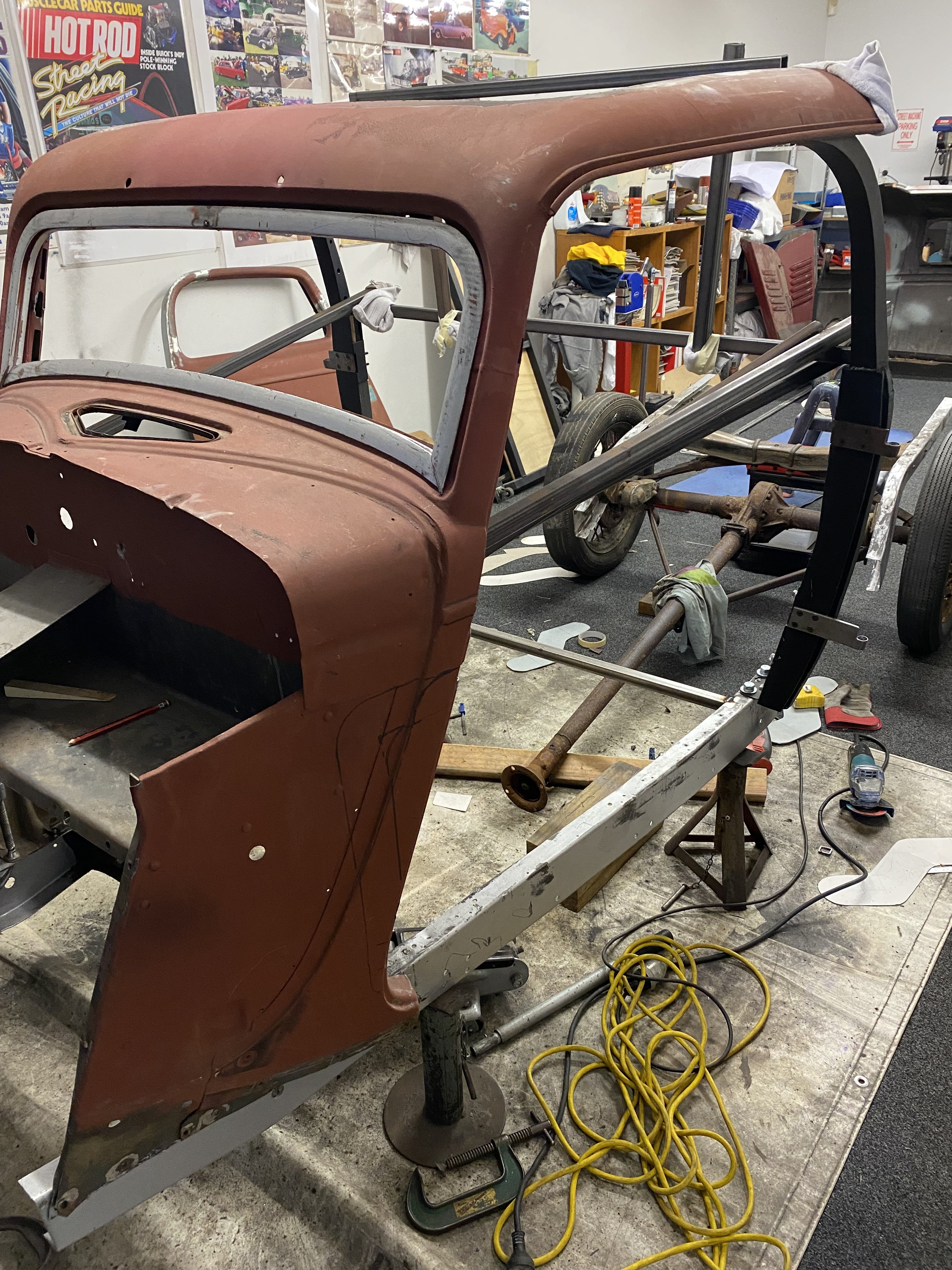

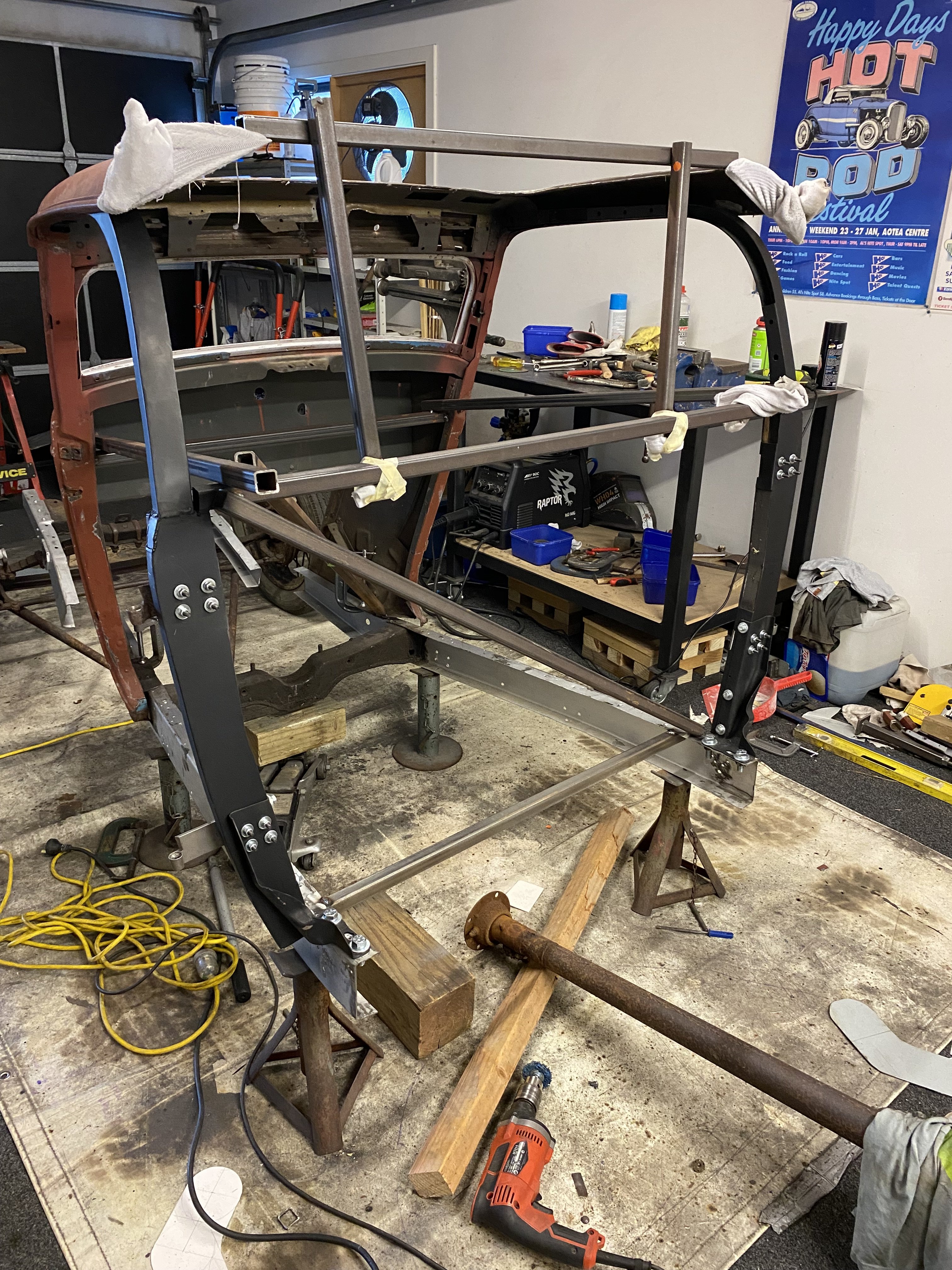

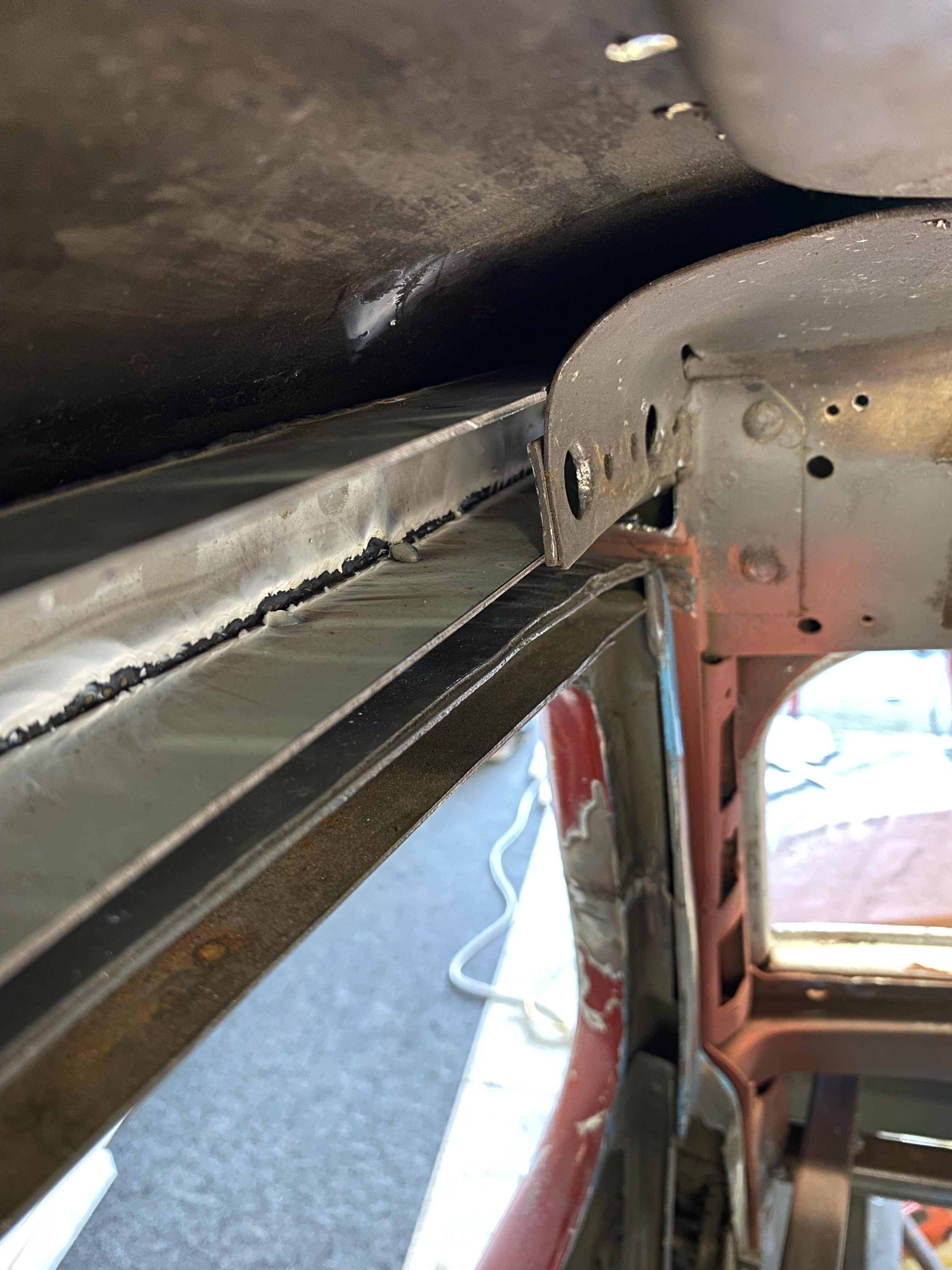

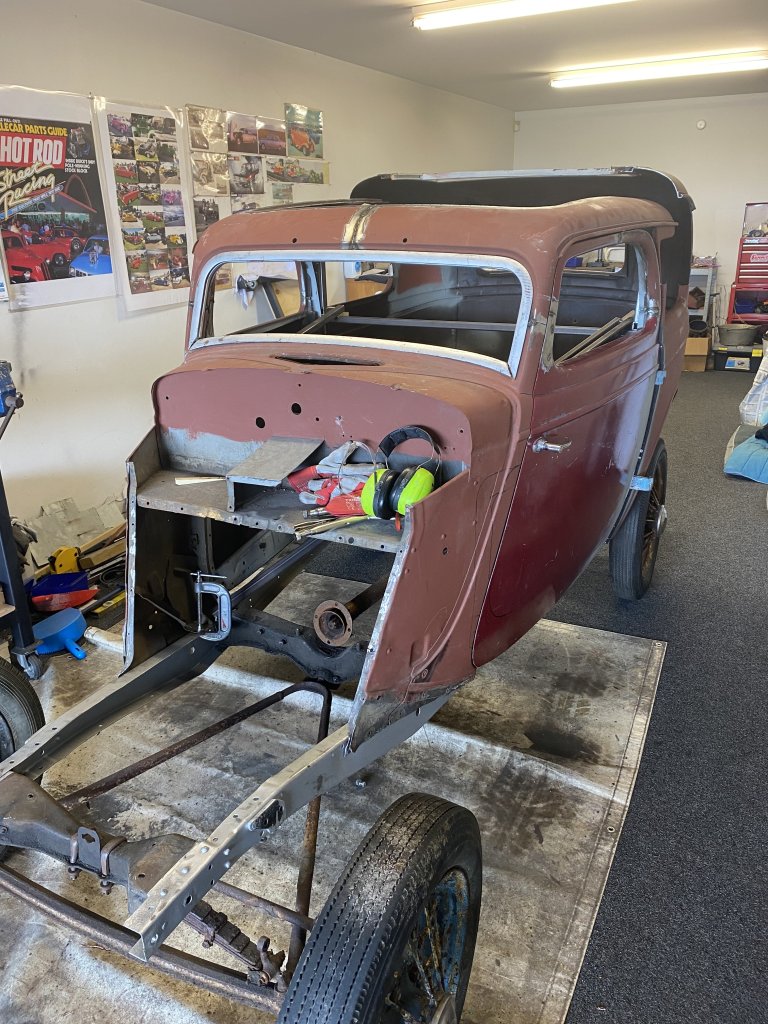

Got the front of the roof chopped three inches.
I need to cut a small piece out of the centre to get it to line up. When you look at the windscreen surround it tapers in towards the bottom a fair bit.
  • Like 8

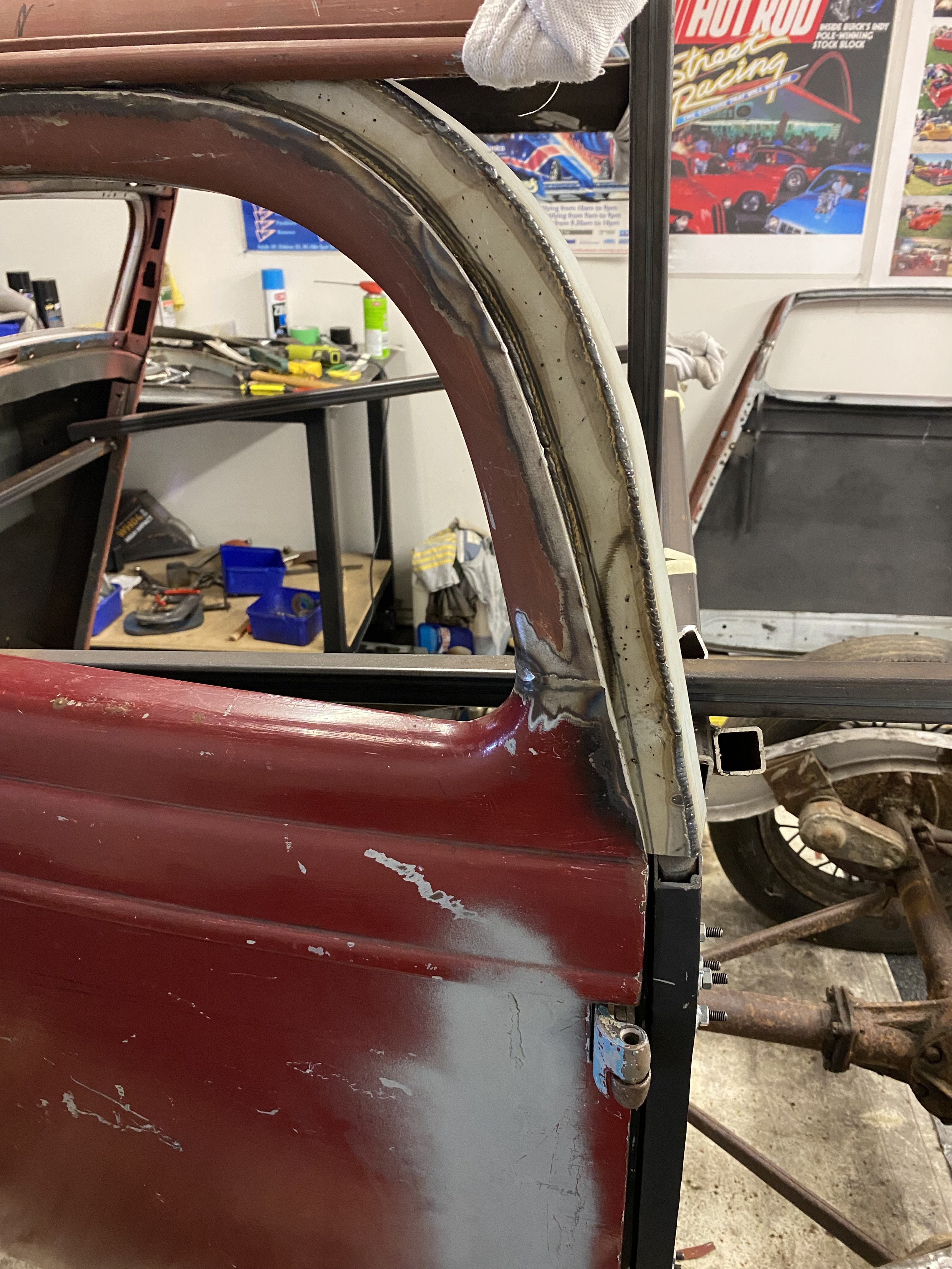

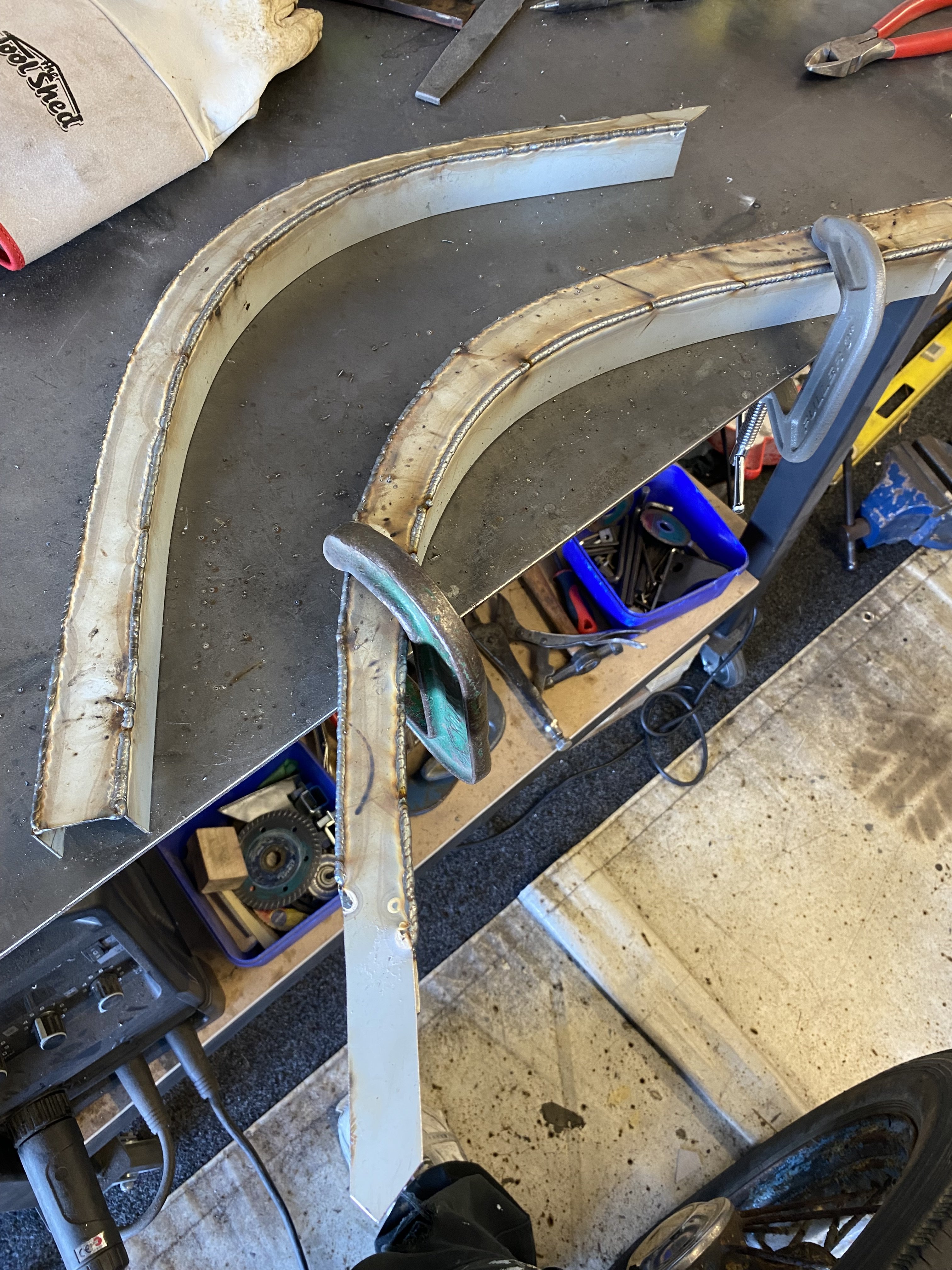

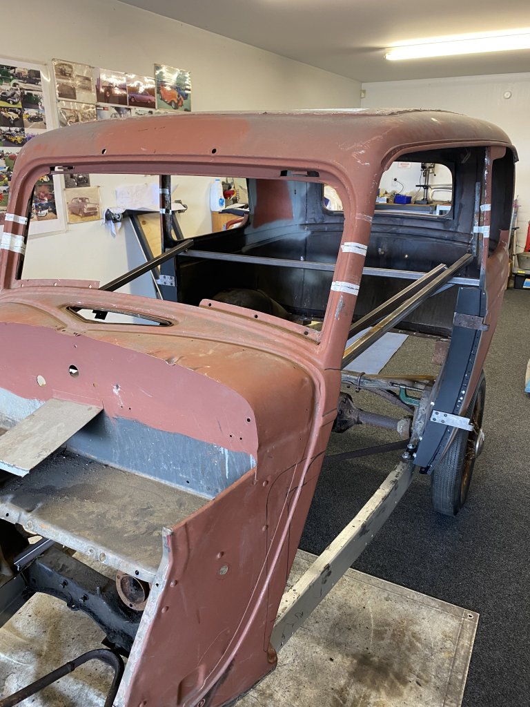

Just started on a pair of door post braces to help lock in the roof and also give me a area to weld the rear portion of the roof to around the curved part of the door.
  • Like 6

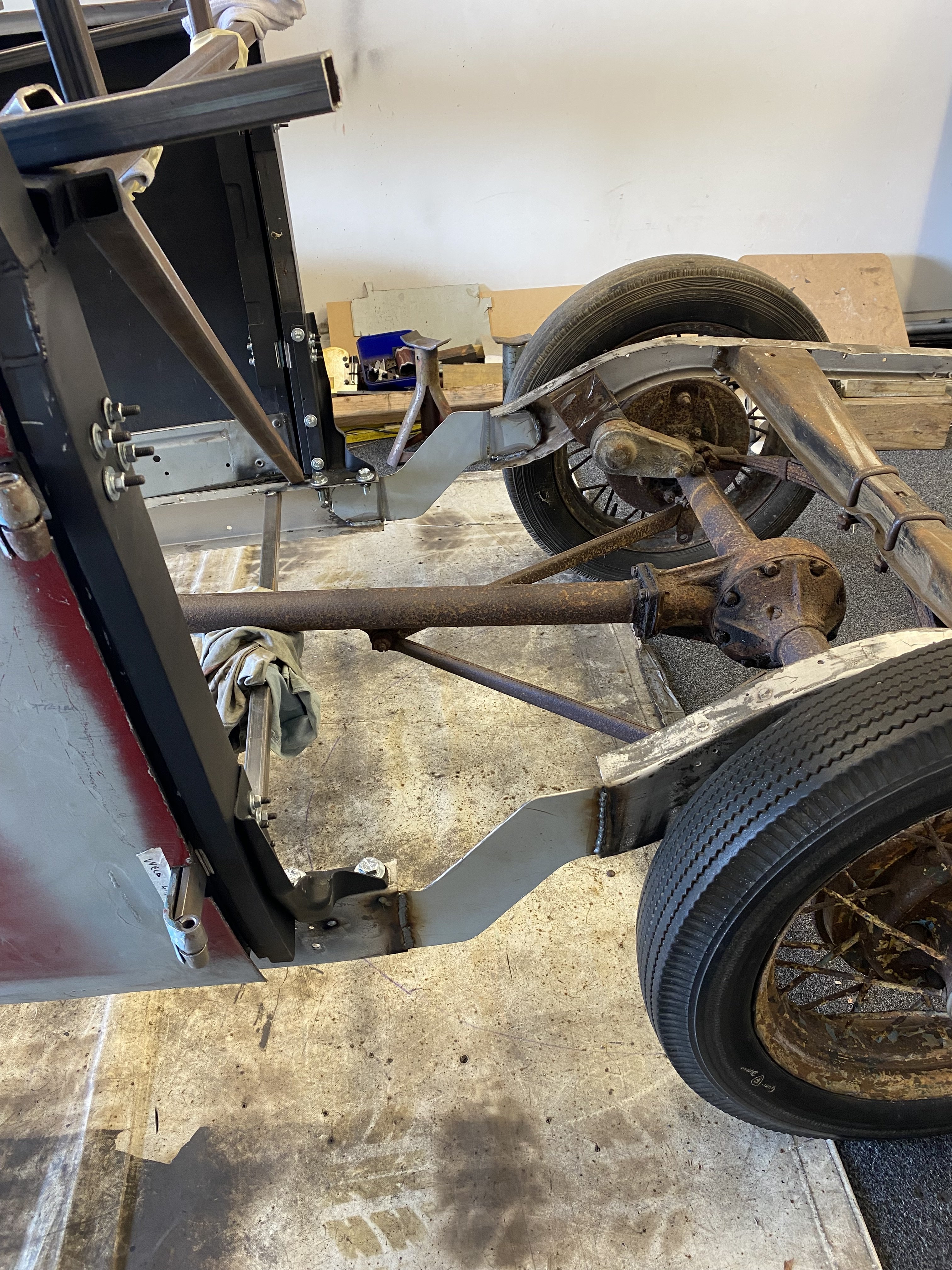

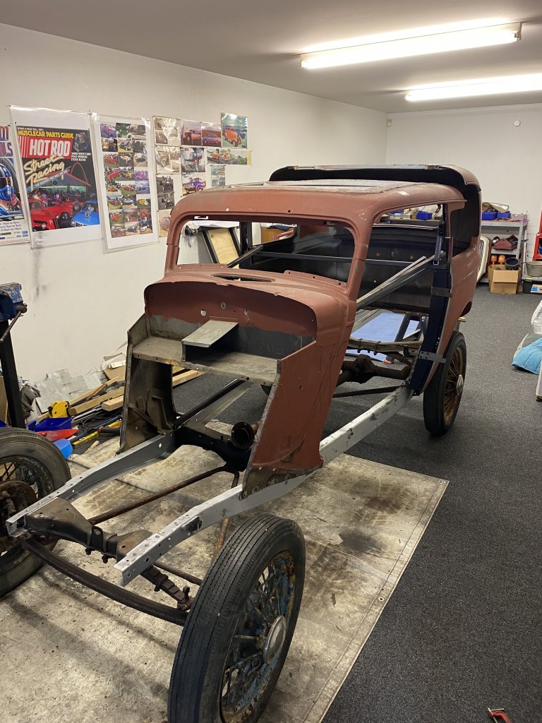

Also chopped the front and rear of the chassis off so I can set the body at the height I want it.
The ford Y is so much smaller and narrower than a 34 ford and don’t want to loose any room inside by channelling it.
So I need to do a kick up in the front and rear.
It also needs to be lengthened 205mm to get the right proportions for a coupe.

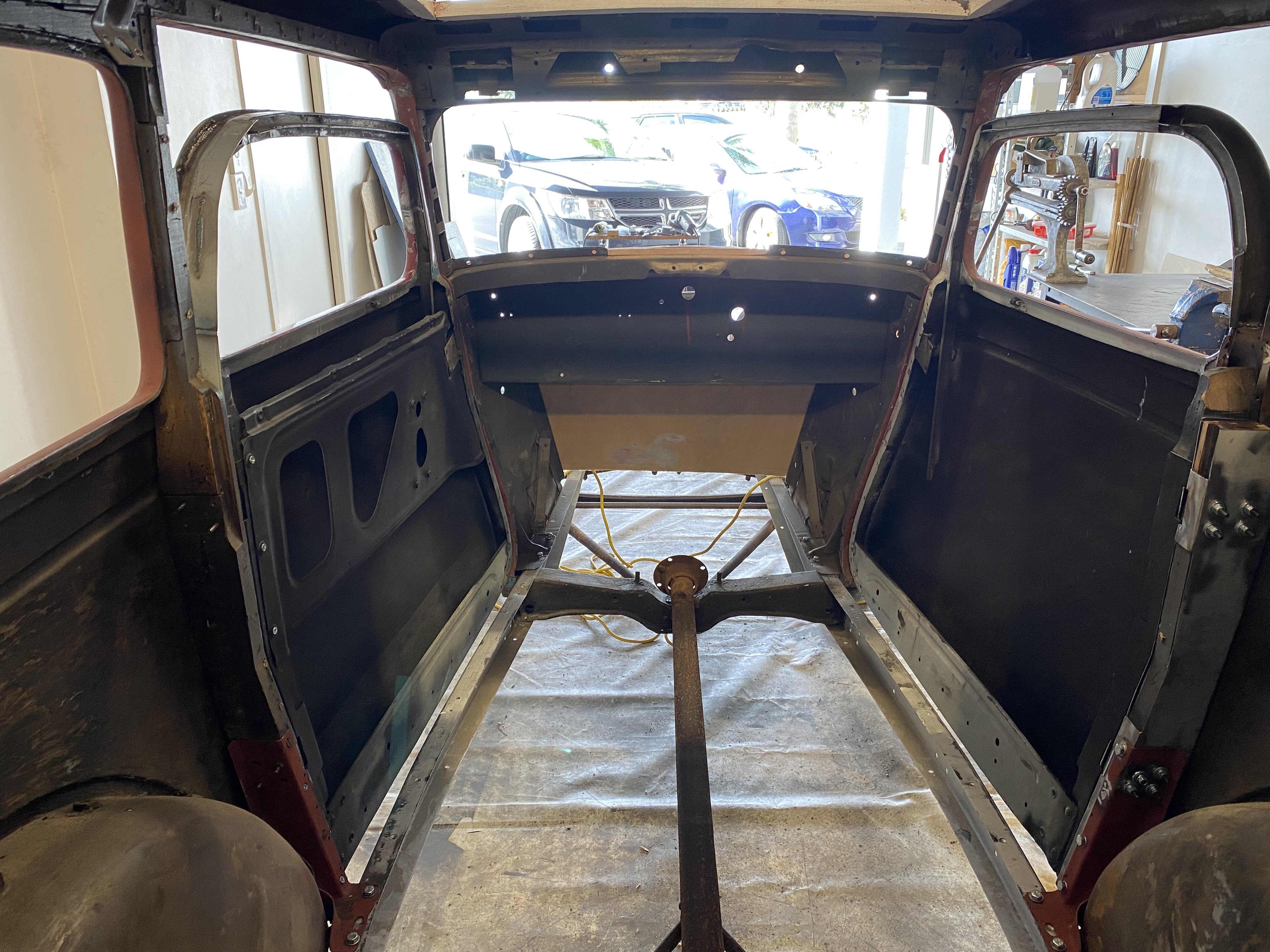

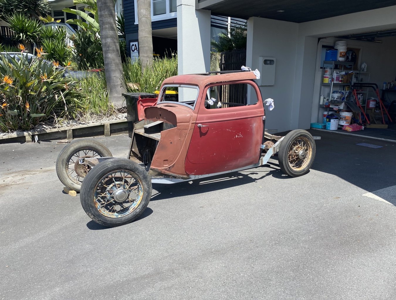

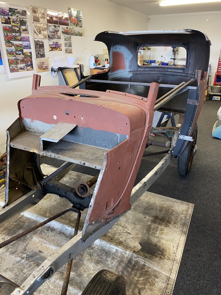

Got the chassis extended and dropped to close to where it would be.
im only using the original as a template for 3 x 2 rhs 5mm wall.
Im not sure whether to finish the roof off first or start on the rear quarter panels.
  • Like 5
